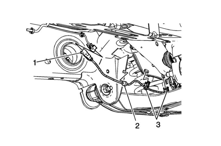

1. Raise and support the vehicle. Refer to Lifting and Jacking the Vehicle (See: Vehicle Lifting > Procedures > Lifting and Jacking the Vehicle).
2. Remove the tire and wheel assembly. Refer to Tire and Wheel Removal and Installation (See: Wheels and Tires > Removal and Replacement > Tire and Wheel Removal and Installation).
3. Disconnect the wheel speed sensor electrical connector (1).
4. Release the wheel speed sensor wire harness grommet (2) from the lower control arm bracket.
5. Release the wheel speed sensor wire harness routing clips (3) from the upper suspension link.

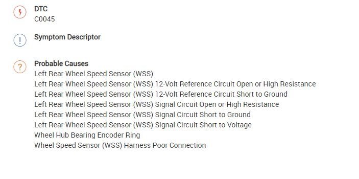

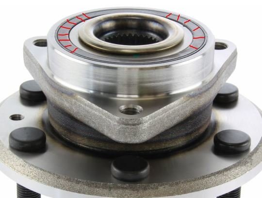

The C0045 is a circuit code for a left rear speed sensor, it can mean the sensor is bad but more times it is that the wiring to it is faulty.
The C0561 is a code that says the traction control is off because of a fault it has from the electronic brake control module (aka the ABS and traction control module) The C0561 should have a descriptor with it, either a 71,72,74 or 75. Some scan tools cannot read the descriptor information.
Checking the wiring harness isn't hard but because of the way the system works you need a VOM that can capture the initial 12 volt pulse that the EBCM sends out, it is a very short pulse that the module uses to test the wiring integrity and if you have the sensor disconnected or it is faulty the system sends the pulse, then shuts off the voltage because of the fault. If you have access to such a meter or a scope then follow this process -
Key Off, Remove Key, Open and Close the drivers door to turn off Retained Accessory Power and wait at least 60 seconds.
B. Disconnect the left rear speed sensor connector.
C. Connect a DVOM across the wheel speed sensor "Supply Voltage" and "Signal" circuits from the EBCM.
D. Set the DVOM on DC volts 12-50 volts and press the data capture, min/max button or whatever the meter uses to capture a voltage peak.
E. Turn the ignition key on. There will be a quick momentary 12 volt pulse from the EBCM at key up. This 12 volt pulse is sent each time the EBCM is powered up after being asleep to check the WSS circuit integrity. If you see the pulse then the wiring to the connector is okay. If the test shows the wiring is okay then the fault is likely sensor related. The sensor itself reads a thin magnetic ring on the back of the wheel bearing, if that ring is dirty or damaged it can set this code as well. Testing that requires a scope that will let you read the pulses the sensor generates and see if they are properly spaced or not. The picture is the bearing unit, the red lines are the magnetic ring and the direction of the individual magnetic lines, there are far more than I drew. Normally damage there will set a different code first but if you test the sensor wires and replace the sensor as a test item (they are under $50.00 which is probably cheaper than the testing if you take it to a shop) and it still sets the same code after testing for the pulse and replacing the sensor.
As for the replacement, normally you just unclip the wiring harness clips and brackets and remove the bolt that retains the sensor, then remove the sensor, however if you live in the rust belt the sensor will likely require more work to remove it, they have a bad habit of rusting into the mount and breaking off.

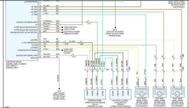

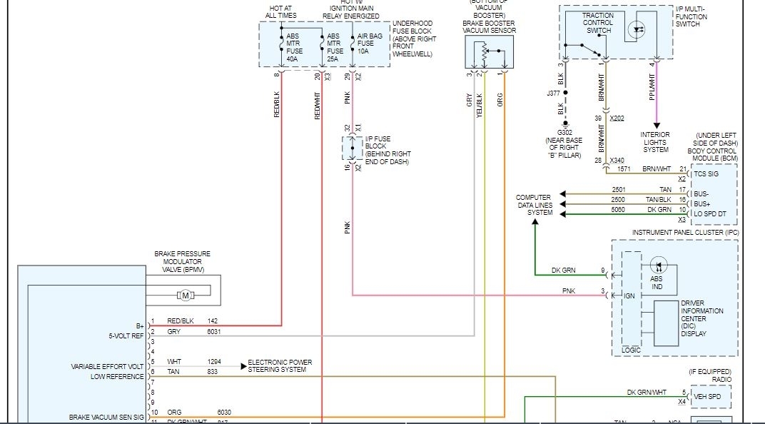

I attached the wiring diagram of the system for you to view.
https://www.2carpros.com/articles/abs-wheel-speed-sensor-test
Do you or can you get a scan tool that reads ABS live data?
https://www.2carpros.com/articles/abs-warning-light-on-easy-repair-guide

As Roy said, time to look close at the wiring to the sensor. The misfire codes shouldn't be related but you may also want to check the grounds for the coils and the ABS module. It's not real likely but a bad ground on the coils could cause some strange things if the voltages were looking for a path to ground. The coils ground at the back of the engine on the manifold and from the engine to a ground on the left fender, the ABS is grounded to a point on the same fender.

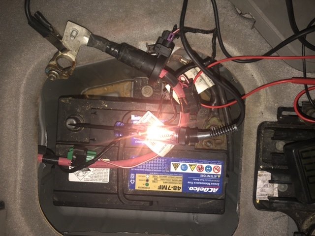

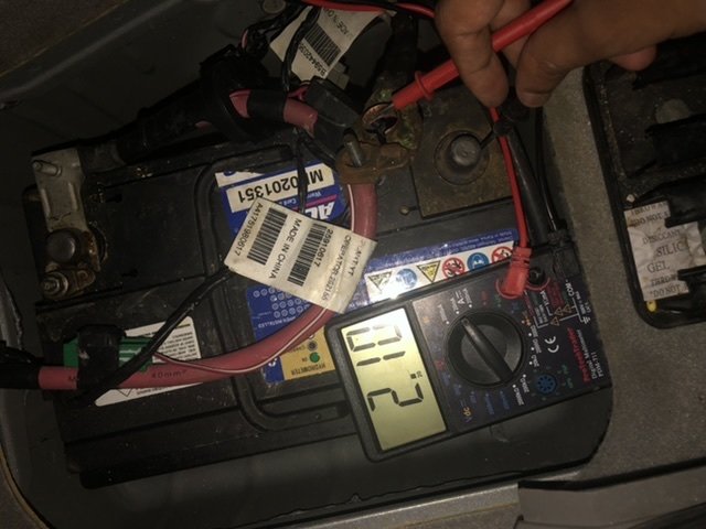

While checking for ground, i observed something that i connect the test light to positive terminal and other end to disconnected terminal. the lights light up and another DMM on amps with connected to negative terminal with disconnected terminal and positive terminal to battery is showing 2.1amp, but after some time it goes to zero. so my question, is this procedure for finding shorts is right or i my car having short?
Nov 18, 2020 at 4:53 PM
No, it is not.
The test light check you did verifies that the wire you tested is a ground.
If you disconnect the negative, not positive, and insert an amp meter, it will tell you the total system draw while the engine is off. It will not tell you if you have a short circuit at all.

I saw the your video on YouTube regarding ABS sensor test. can we check by resistance method for GMC Acadia ABS sensor? because i have checking by resistance method, i kept voltmeter on 20k and touched the leads to ABS connectors the reading shows 1 only , even for new ABS sensor same reading 1 but other Youtubers shows the testing by resistance and having reading between 600 to 1300.
Nov 21, 2020 at 9:41 PM
Yes, you can. You measure the resistance of the sensor. It should be 800-2600 ohms.
You also can check for AC voltage while rotating the wheel. That way it checks not only the sensor but the tone ring as well.
This testing will work on most vehicles.
Nov 21, 2020 at 9:58 PM

Your advice for wiggle test worked. i started from sensor to ABS module but no success. then i inspect fuse box which wiggling, so i tightened connectors and fuse box. that might have been loosened while i had removed the upper intake manifold for that i have to clear the harness aside which going to PCM from fuse box above the manifold with tension wires. Any way now no ABS lights and no codes.
