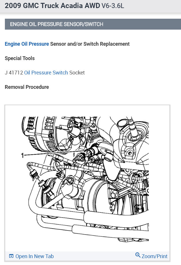

I have had a warning with beeping occur about half a dozen times lately while driving, it says 'check oil pressure light, turn off engine'. This is after a recent oil change and the gauges look normal so it's like it's a computer malfunction.

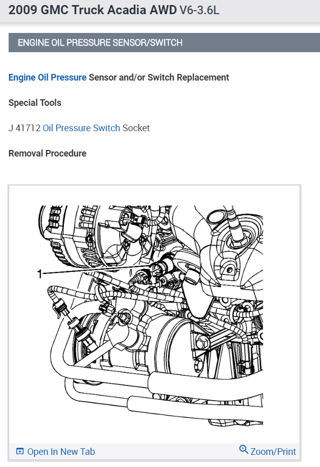

This can be a problem with the oil pressure sender itself. Recheck the oil level to be sure all of the oil is in it and then replace the oil pressure sensor here is the location. Check out the diagrams (below). Please let us know what you find. We are interested to see what it is.
