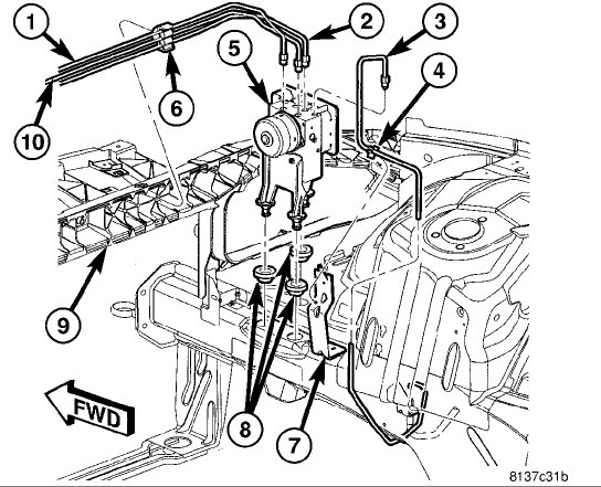

Can ABS pump be called by any other name?
Jan 18, 2018 at 10:24 AM
STEVE W.
  • 15,238 POSTS

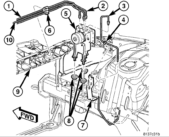

Well I have called them a few different names but most are not real friendly. Other than that Chrysler usually calls the ABS system the "electronic brake control module and the hydraulic control unit". The EBCM is the electronics and solenoids while the HCU is the pump and mechanical parts. The combined unit is number five in the picture.
What is the issue you are having with the system?
Mar 15, 2021 at 2:56 AM
TRA
  • 41 POSTS
LOL. Did it answer when you called it by those other names? :-) Thanks for that picture. I am trying to see how easy it would be to change that part if I had to, since folks want to charge $175.00 for just labor on that plus the part cost. Hoping I will not have to do that anyway and can get fluid going to this one wheel that I cannot get it to right now (front right).
STEVE W.
  • 15,238 POSTS
If you are bleeding the brakes or changed out a failed hose/caliper and now you cannot get fluid it is likely that you will need a scan tool that can purge the ABS system of air.
That will reset the valving in the HCU and let fluid pass.
