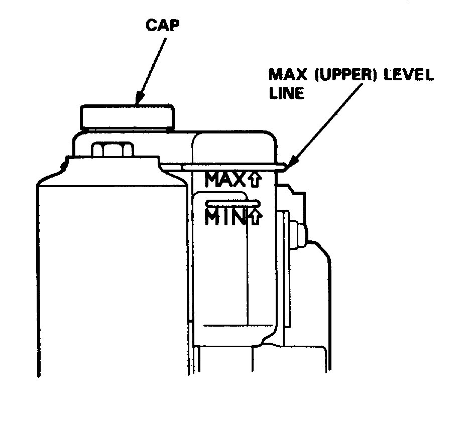

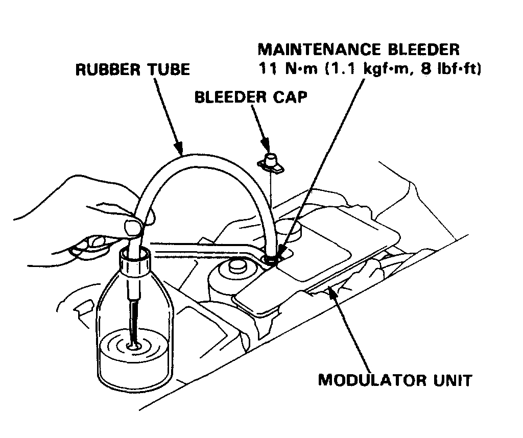

trying to bleed ABS module after replacing it. i took out accumulator and pump and replaced seals. now i'm getting abs code 1 overrun pump. i did not relieve pressure before taking pump off. could i have ruined the module?

I can't imagine it is ruined. Do me a favor. Take a look through these directions and see if it is what you did or if you missed anything The attached pics correlate with the directions.

CAUTION:
- Do not loosen the relief plug on the accumulator.
NOTE: Brake fluid replacement procedure explained is for the brake fluid in the modulator unit (that is, the brake fluid in the high-pressure passage and in the reservoir). Refer to brake fluid replacement procedures for the rest of the brake system. See: Brake Bleeding > Procedures > Bleeding Procedures
pic 1
1. Remove the bleeder cap from the maintenance bleeder on the modulator unit.
2. Attach the wrench to the maintenance bleeder.
3. Connect a rubber tube of the appropriate diameter to the maintenance bleeder, and set the other end of the rubber tube in a suitable container.
4. While holding the rubber tube with your hand, slowly loosen the maintenance bleeder 1/8 to 1/4 to collect the brake fluid in the container.
CAUTION: Do not loosen the maintenance bleeder too much. The high-pressure brake fluid can burst out.
5. Tighten the maintenance bleeder.
NOTE: Do not remove the rubber tube and wrench yet.

7. Check the brake fluid level in the reservoir. It should be below the MAX (upper) level line.

9. Remove the cap, and refill the reservoir to the MAX (upper) level with fresh brake fluid.
NOTE: Pour the brake fluid slowly so that it does not foam, and wait for a few minutes.
pic 2
10. Repeat steps 4 through 7 twice, and refill the reservoir to the MAX (upper) level with fresh brake fluid.
11. Tighten the maintenance bleeder to the specified torque, 11Nm (1.1 kgf, 8 lbf.ft).

2. Connect the rubber tube to the bleeder on the modulator unit, and set the other end of the rubber tube in a container.
3. Loosen the bleeder, and start the engine to activate the pump motor.
NOTE: Take care not to spill the brake fluid from the container.
4. Tighten the bleeder when the fluid starts to flow out of the bleeder.
5. Stop the.engine after the pump motor stops
NOTE: If the ABS indicator tight comes on and the pump motor stops, restart the engine and repeat steps 3 through 5 above.

Let me know. Also, if you have a code, let me know that as well.
