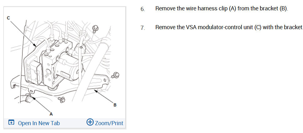

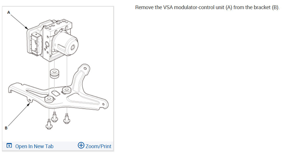

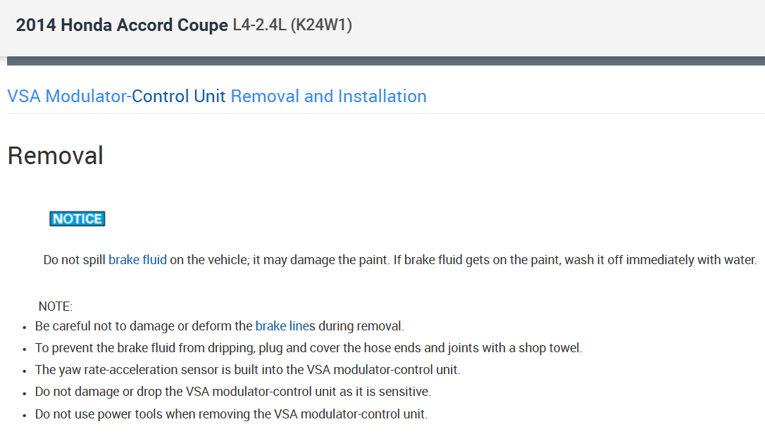

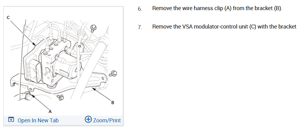

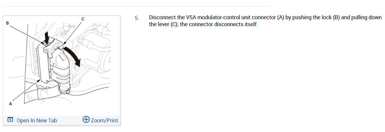

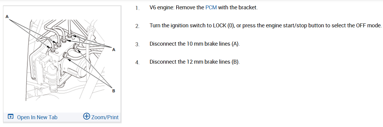

Here are the instructions on how to change out the ABS module correctly. Check out the images (below). Let us know how it goes.
