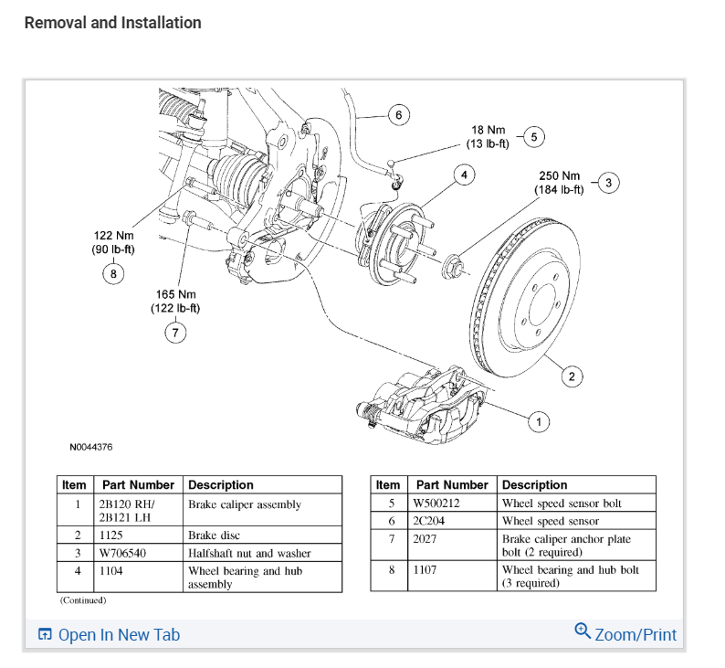

It sounds like you have a front wheel bearing hub that is going out which effects the sensor and ABS/traction control system.To confirm lets run the codes to see which sensor is giving us trouble. I will also include a video on how to change the hub out on a similar car.

Has 2 code C1145 and C1155.
Jun 1, 2019 at 10:28 AM
  • 55,399 POSTS

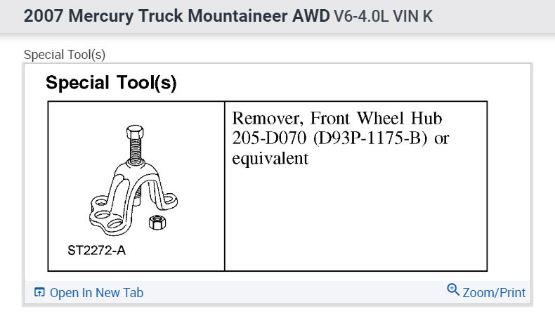

These are for both front ABS wheel speeds sensors. I would replace both front bearing hubs here are diagrams to show you how. Check out the diagrams (below). Please let us know what happens.
