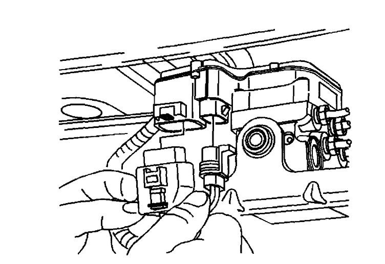

In the past couple of months my vehicle has had the ABS and 4WD lights on dash/chime Intermittently.

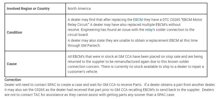

I took it into the GM dealer and they did a diagnostic and said it was a ground issue.
Shortly after it did it again but then went away and yesterday it happened non-stop. This morning nothing..
Took it to the GM dealer and they wanted $1,315.00 to replace some module yet they could not recreate the issue.
I am at a loss here because I feel like it's moisture related. seems it comes on day when we drive through snow and slush. Maybe I am a fool for thinking that but that is the only common factor that I can recount.
Any thoughts or suggestions?
Or at a minimum how do I stop the warning sound maker... hard to drive it any distance with the chime go off non stop.

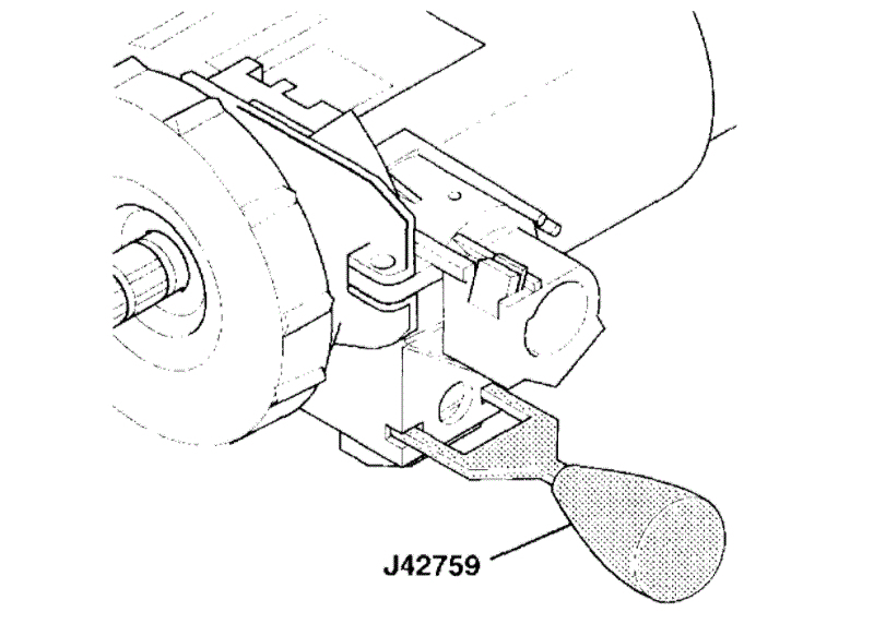

Okay, got it.
This could be the ignition switch dropping out.
GM had a huge recall on ignition switches for all kinds of issues. I would call the dealer and give them your VIN and see if you were in the recall.
1. Disconnect the negative battery cable.
Caution: Refer to SIFI Caution in Cautions and Notices.
2. Disable the SIR system.
3. Remove the hush and knee bolster.
4. Remove the steering column trim covers.

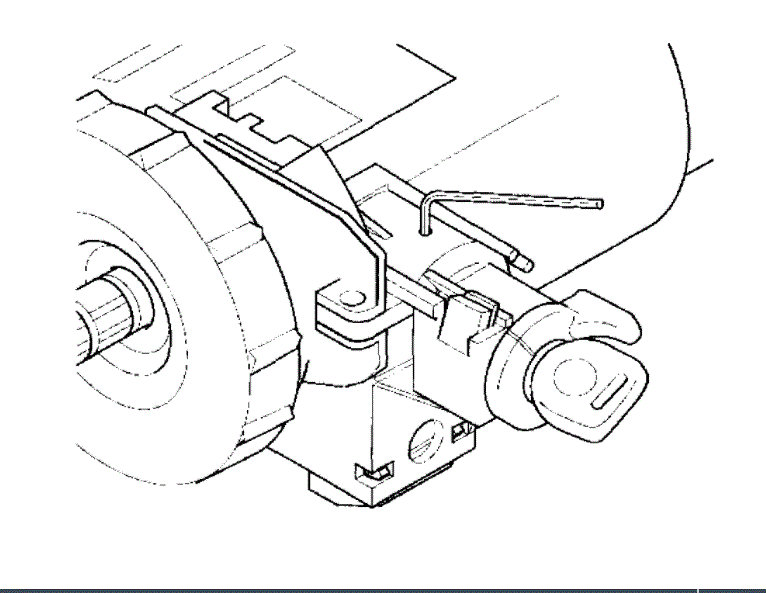

5. With the key installed, turn the key to the RUN position.
6. Install an alien wrench into the hole on top of the lock cylinder housing.
Push down on the alien wrench to release the tab on the lock cylinder inside the lock cylinder housing.

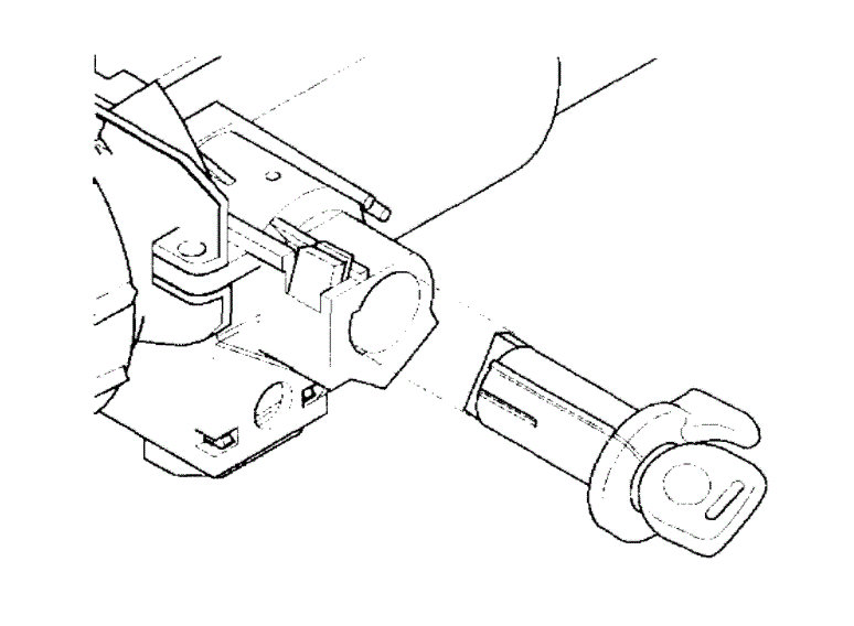

7. Slide the lock cylinder out of the lock cylinder housing.
8. Disconnect the PASSLOCK and key buzzer from the lock cylinder housing.
9. Insert J 42759 into the lock cylinder housing to release the tabs on the ignition switch.
10. Pull the ignition switch out of the lock cylinder housing.
11. Disconnect the connector from the ignition switch.

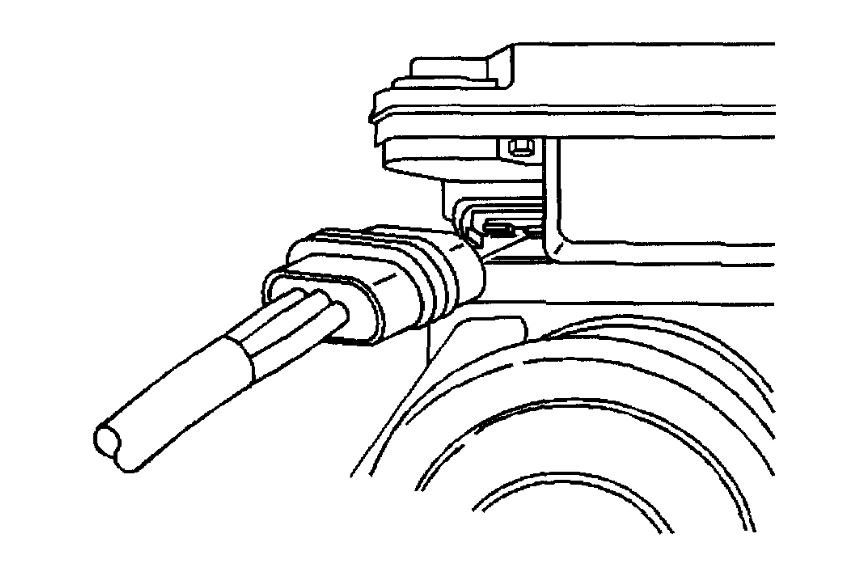

I think you are back at the switch. I would check the connector as it may be dirty.

Okay, this does sound like the ABS module which is what the dealer recommended anyway way back in the beginning.
Aug 20, 2021 at 11:05 PM
