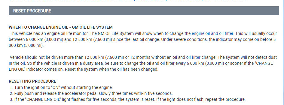

how do I turn the oil light off after I change the oil?

It is not too difficult. Here are the steps:
Turn the ignition on. Fully depress the accelerator to the floor 3 times in 5 seconds. The light should flash then turn off. If it doesn't you need to repeat this.
Here is a guide that helps as well in case others visit this page and don't have this exact vehicle:
https://www.2carpros.com/articles/oil-life-reset
Lastly, I attached the process from the manual that spells this out as well. Thanks

turn the key to the run position,(don't start the vehicle)pump the gas pedal 3x within 5 seconds and the oil light will flash when it goes out turn the key off and it should be reset. also this is in your owners manual.
