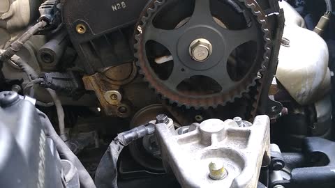

While driving vehicle shut off and oil dipstick was pushed out. Now when key is turned to crank, fuel pump turns on and crankshaft turns, but not normal cranking sound. Sound is like a steady hum instead of "crank crank crank" noise. Lol, hard to explain. Accessory belts turn so I know crankshaft is turning, so I know starter is good and engine not locked up. Thinking it could've been timing belt, I removed upper timing cover to reveal tensioner and camshaft sprocket. All appeared to be in good condition. Manually rotated engine with crankshaft bolt and saw timing belt and camshaft sprocket rotate. Please help.

Thanks for helping me out with this issue. I have uploaded a video as you requested. I hope it helps. I am familiar with interference engines and the possibility of internal damage, so it's definitely a concern. As you can see in the video, the timing belt isn't broken and appears to be in good condition. The teeth of the belt appear good also. I have a compression test gauge kit so I am going to perform the test and record the results for each cylinder. I will share the results with you when I'm finished and you can tell me what you think.

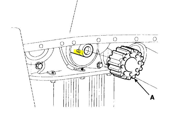

Again, based on the way there is a delayed start and stop, I have a feeling the shear key on the bottom timing gear (crankshaft) has sheared. Do me a favor. see if you can move the cam gear left and right easily. Keep in mind, if nothing is broken, the crank pulley should move exactly at the same time without play and you really shouldn't be able to do it by hand because you will be turning the engine engine. Try it and let me know.
One other thing, if the timing belt crank gear has sheared the key, that small amount of movement will most likely not turn the belt driven accessories until it gets tight again.

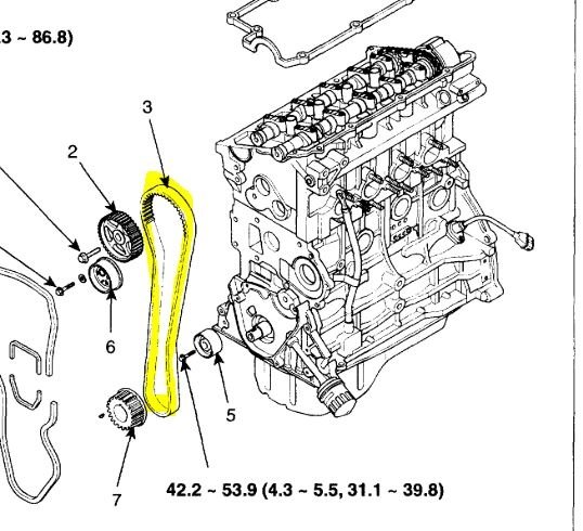

I attached two pics. First, is the timing belt so you can see there really isn't much to it. You will see the crank and cam pulleys and the tensioner. If the cam gear moves at all, the crank pulley should to. That doesn't appear to be what is happening.
The second pic shows the shear key that the crankshaft timing gear goes over. That is what I think broke.
Check that and let me know what you find. Also, if I am correct, it may be cheaper to purchase a good used engine rather than trying to repair this one. Watch your video and you will see what I mean. Once you see it, I think you will agree that the shear pin broke or even the camshaft is broken.
I will watch for your reply. If you want to check the crank shear key, you will need to remove the harmonic balancer which drives the belts from the crankshaft. To check the cam, you will need to remove the valve cover. Let me know which you want to do and I tell you how it's done.
