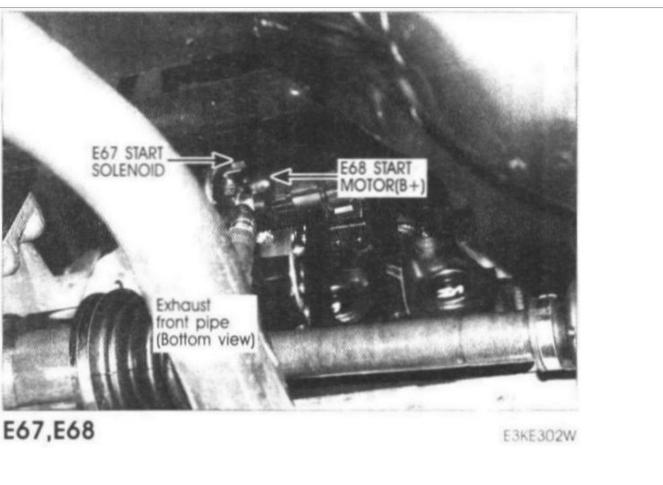

Car will not turn over. It tries but it will not catch. That tells me the battery is probably good. I can hear the fuel pump priming. I swapped the relay for the fuel system. There is gas. Not sure where to go next.

To check to see if it is the starter use a test light and probe the starter trigger wire. Here is a guide on how to do that. Look at the bottom for the guide.
Diagram (below).
Please run this test and get back to us so we can continue helping you.
