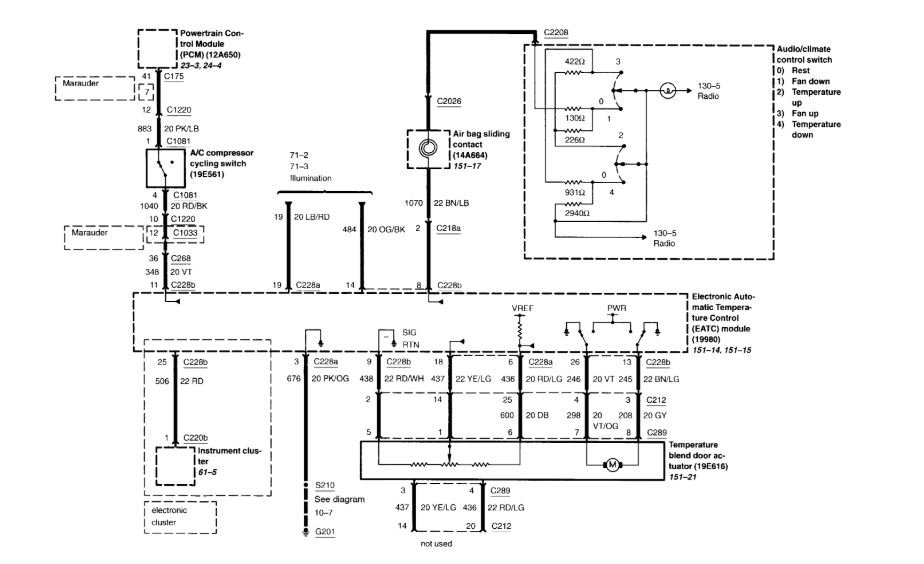

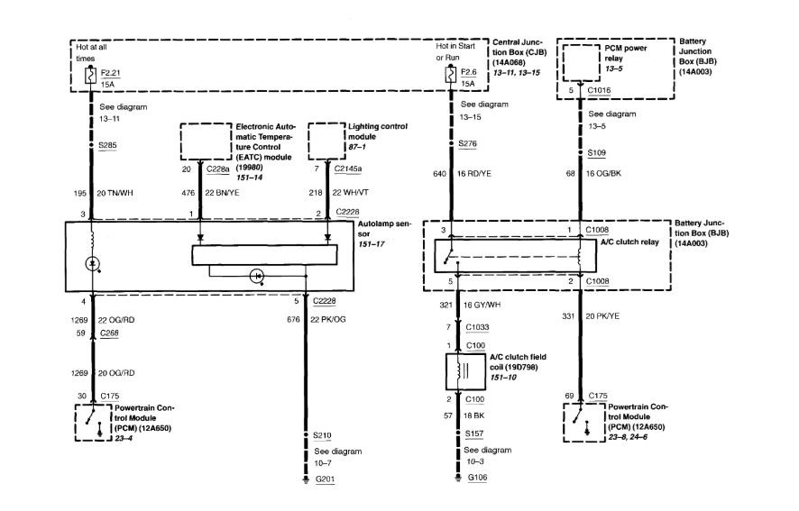

I checked for power to the clutch relay and it was showing 12 volts on one terminal. Can you advise where on the diagram that the high and low switches are?
Aug 6, 2018 at 6:32 AM
As you can see in the diagram, one power comes from the ECM power relay. The other power comes from the fuse block from the fuse listed.
You need to get two powers to the relay first before moving on to anything.
Aug 6, 2018 at 6:44 AM

Sorry for the confusion. I have power to both terminal 1 and 3 on the relay.
