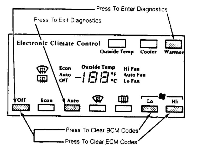

if you got into a wreck then the condenser may have been damaged letting all the Freon out. find another mechanic if you can in your area first thing. Youi car uses R12 Freon which hasn't been used in almost 20 yrs now. However it can be converted to the more modern R134 which may not cool as great at slower speed. Part of your problem is you have auto temp control which can cause part of your problem of not cooling. the codes you gave are all engine codes and nothing to do with the temp problem. these codes could also be the result of the wreck you were in depending on what went wrong like if the battery was disconnected. so pull the ecm fuse for 30 seconds and see if any other ones come up. to check operation of system press off and warmer at the same time if "-1.8.8 does not appear will give you amisdagnosis. codes with an E will appear first followed by codes with an F they will all stay for 2 seconds then go to next one you will need towrite down everyone. press the lo fan button to clear E codes and Hi to clear F codes press auto to get out of it altogether.
May 5, 2014 at 8:24 AM
HMAC300
  • 48,601 POSTS
forgot the pic sorry
