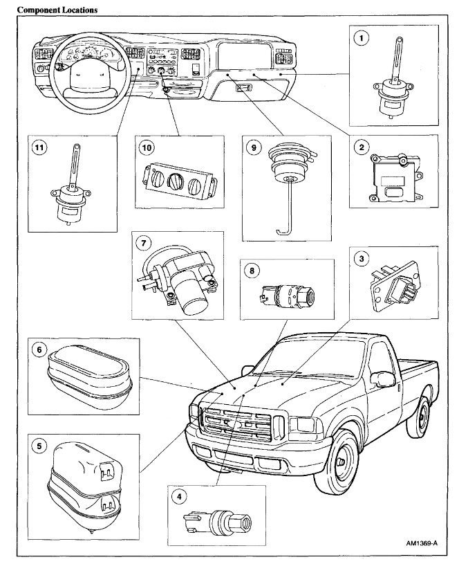

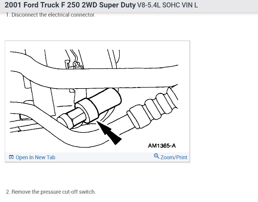

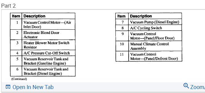

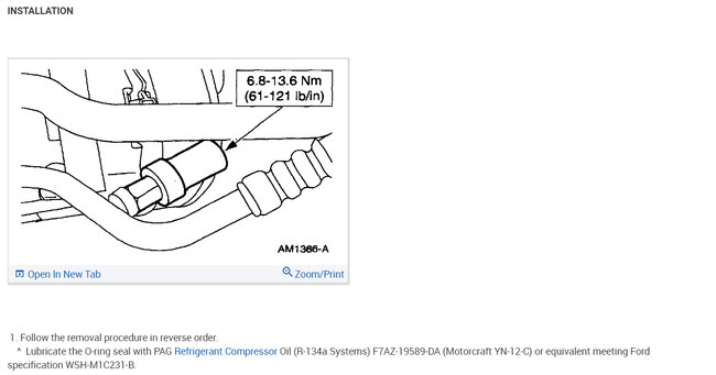

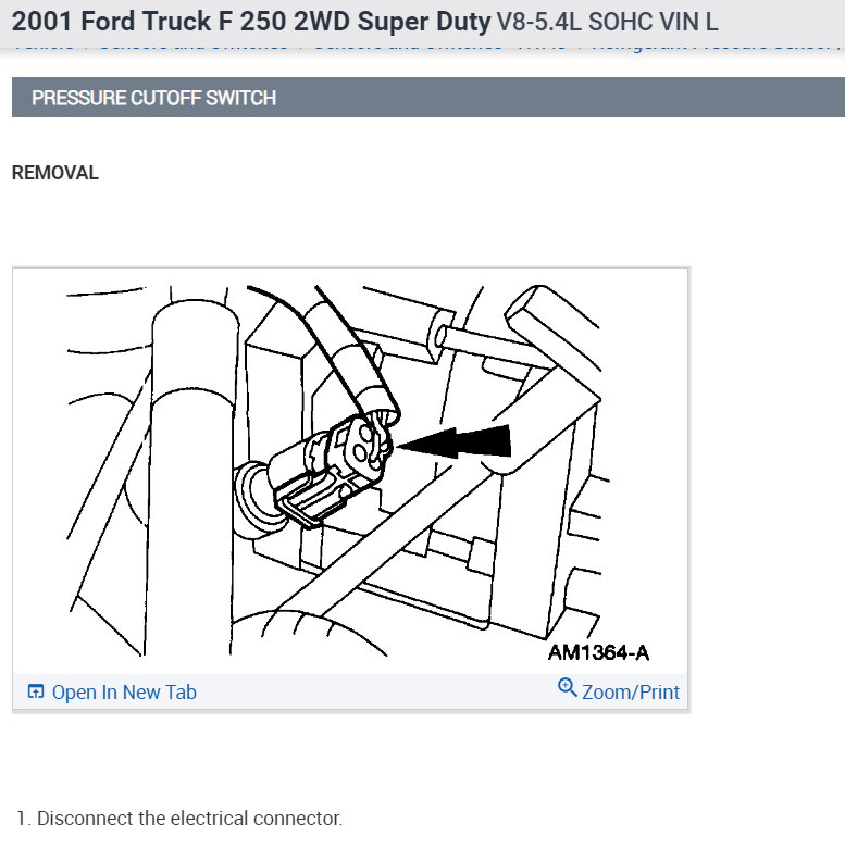

At 40 L and 190 H psi the system is low on refringent. At about 90 degrees outside air temp the high side should be at about 250 psi. The charge cans or keg have about 65 PSI so the system should take more. Please go over this guide:
https://youtu.be/4EqdrBVb0sY
Here is the high side pressure sensor location in case you want to change it out. Check out the images (below). Please let us know how it goes.
