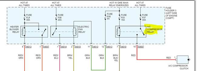

My A/C stopped working so I replaced the A/C compressor clutch which worked for a few weeks then it started whining and eventually the A/C totally stopped working. So, I bought a compressor and before installation had the Freon extracted then put back in professionally when finished. Again after a few weeks the A/C doesn’t work 90% of the time. On my way to work in the morning the A/C works great cold as ice but then from lunch time on the clutch and fans don’t even kick on. Since replacing it we had the machine hooked up and both low and high side are correct pressure and has no leaks. I’m stumped on what it can be with it only working when slightly colder out but not when it’s hot out and it being cold as ice when it does work.

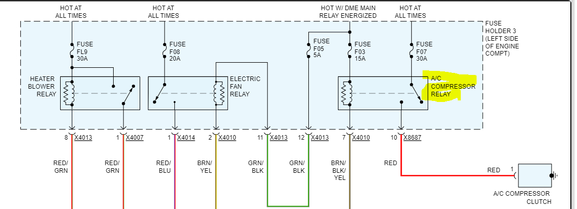

Have you checked or replaced the compressor clutch relay? It may be getting affected by the heat.
I attached a pic below that shows what I'm referring to. Switch that relay with a different one having the same part number and see if it will work. If there isn't one, here is a link that explains how to test a relay:
Let me know what you find. One other thought. When it doesn't engage, check to see if there is power to the red wire at the compressor clutch.
See pic below.

I tried “jumping” the relay to c if it would force on, but it didn’t do anything. And I switched the relay with the fan relay and the fan kicked on rite away but still no clutch engages. I could buy a new relay tomorrow just to c. And at work tomorrow I’ll check the wire on the clutch compressor to c if it has power. Thanks for the help I Appreciate it I’ll message tomorrow with an update.

If the condenser fan is turning on, there is a good chance the compressor clutch is getting power. However, please confirm that and let me know. If it is getting power and not engaging, the clutch coil is likely bad.

I totally understand. However, if you ran power from the compressor relay to the compressor, it should have engaged. I can't be sure, but I believe the clutch coil is faulty.

Did you check to see if there is power to the compressor? If you jump it at the relay, will it engage? These are just easier ways to check before you go to the trouble of removing the compressor,

First, you are very welcome. I just hope we can figure this out. As far as your question, if you are providing power directly to the relay and the clutch doesn't engage, either we have a broken wire or a faulty clutch coil. Also, you don't need to have the key on if the power is direct. You are controlling it.
Were you able to check if there is power to the compressor clutch?
