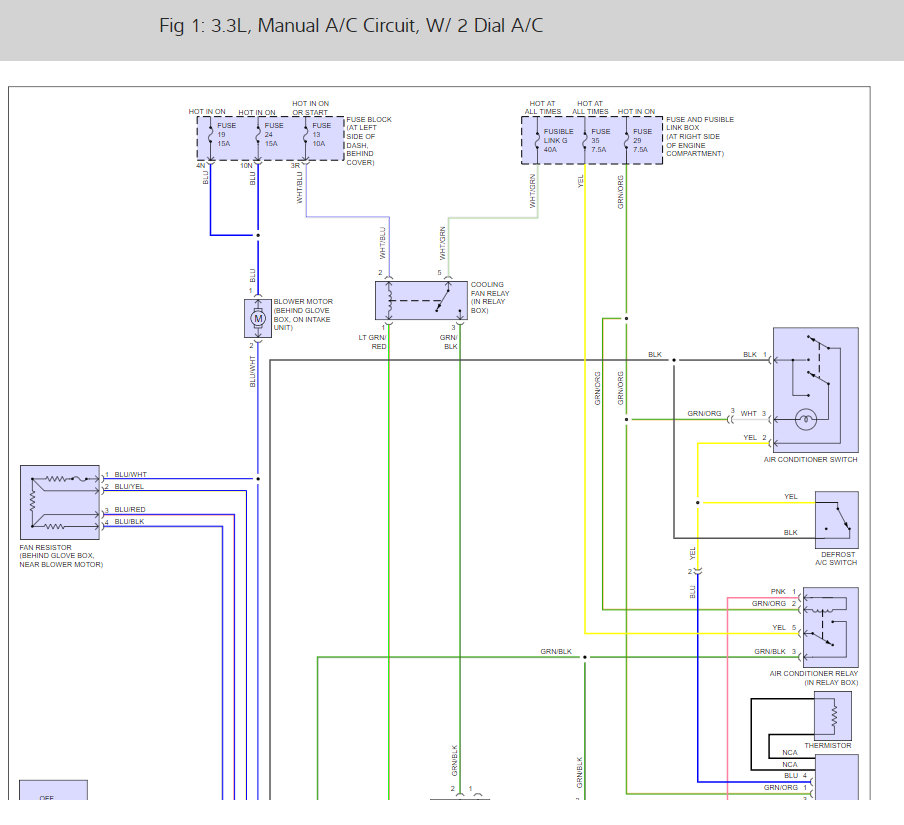

A/C clutch engaged all the time. I have replaced expansion valve, dryer, Freon. On off A/C switch in passenger compartment does not light up. If I disconnect the pressure switch on dryer clutch stops.
VIN number 1N6ED27T3YC400020.
May 3, 2018 at 12:19 AM
Good afternoon.

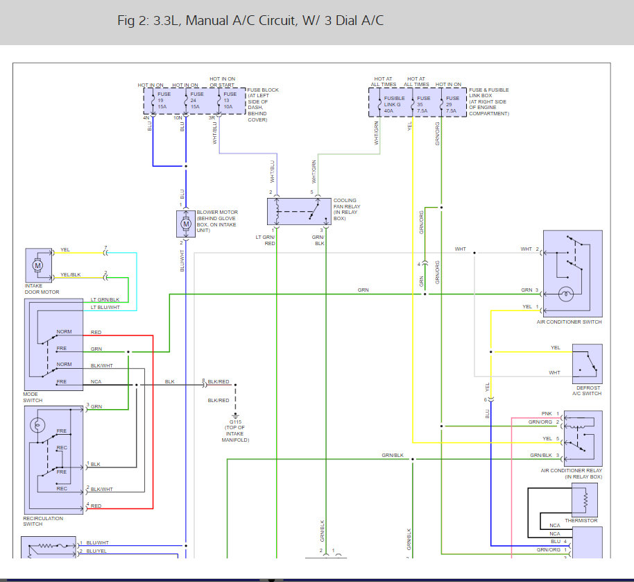

I attached a diagram for you of the A/C controls.
From the looks of it, the climate control head is commanding the compressor on all the time. It sends a signal to the ECM to turn on and when you turn off the A/C, the signal is still being sent.
That is why it disconnects when you remove the wires from the low pressure switch.
From all indication you may have a bad control head.

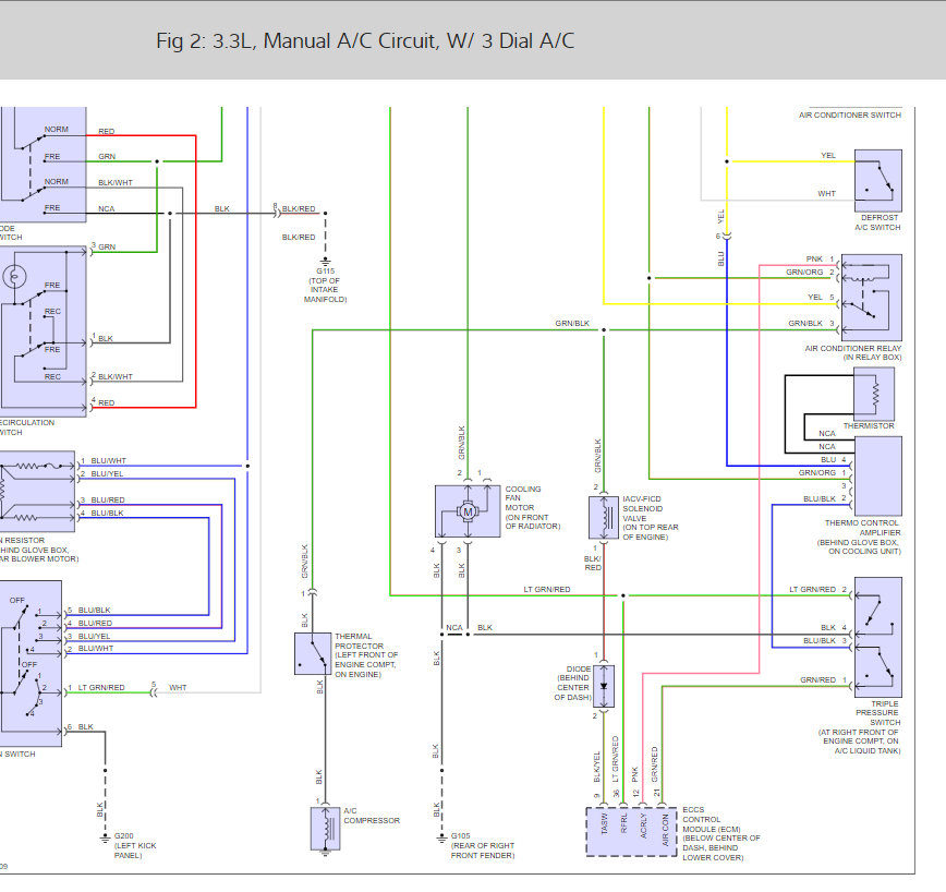

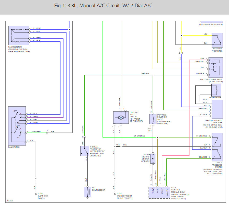

That is a good one, I have the wiring diagrams here and I am looking over as well, you can confirm that when you remove the ground (pink wire) from the ECU the compressor turns off? Pink wire grounding th relay. Please confirm this so we can continue.
Here are the wiring diagrams so we can be on the same page.
Please report back

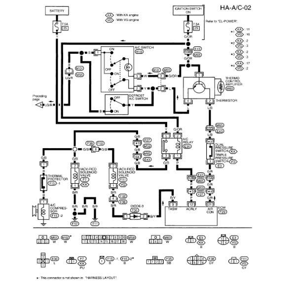

Ken, I removed the signal wire running from the relay back to the ECU. Compressor clutch disengaged and both rad fans stopped running. I was talking with the guy at O'reillys. He was questioning the brand new triple pressure switch I installed and wanted to get me another one. Sure, he is not the one that has to reclaim, vacuum and recharge 134a. :-/
Back into the wiring diagrams I go.
Jun 29, 2018 at 5:19 PM
  • 55,748 POSTS
Can you test the AC switch to make sure the signal is being cut when the switch is off? If the switch is stuck on this will cause the problem.

I will do you one better Ken. I swapped out the complete control head with another today and same deal. I am really starting to give the new pressure switch the stink eye. I have a spare stock Nissan one and I am going to try that next. Seems to me right after I rebuilt the entire AC system, I had rapid clutch cycling. So it was then I bought a new pressure switch and that was when I discovered I could never shut the silly thing off. O'Reillys said I probably got a faulty switch from them. Needless to say, I am not going to try another new one. Who knows, maybe the new ones are not wired correctly? And I have no desire to figure it out either. lol
Jul 19, 2018 at 11:56 AM
JATKINSON
  • 5 POSTS
Ken, I installed a used Nissan pressure switch tonight, vacuumed and recharged and finally when I shut the AC switch off it actually turns off. I will be taking my brand new pressure switch back to O'Reillys and they better have some money waiting for me. Their faulty new switch has cost me a butt-load of time, refrigerant, parts chasing, a control panel and on and on and on. Thanks for making me stay in the fight until I sorted this out. I was ready to go old school, but what bothered me was the IACV was activated all the time due to the ECU getting the signal for AC. I bet vital parts of my anatomy the new switch is wired wrong. Good lesson for anyone reading this in the future is never completely rule out brand new parts and always return to the scene of the crime. I like to say look at the last thing you messed with. Best wishes man and thanks again!
