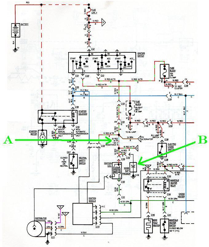

When are you finding that 2.8 volts, with the engine running or with it off and the ignition switch on?
I'm trying to picture the wiring diagram and everything I've seen before has battery voltage, (lets say 14.0 volts) applied to the resistor, then current flows through it to the coil primary where the voltage will be lower, through the coil where we would like it to be real low, then through the module which takes the place of the breaker points. It's a switch.
If you're measuring that 2.8 volts right after the resistor where it connects to the coil, that may be fine. 2.8 volts across the coil doesn't sound like much, and not enough to build a nice magnetic field, but that isn't done with voltage. It's done with current. Doing the math, if you have 14.0 volts on one side of the resistor and 2.8 volts on the other, that's a drop of 11.2 volts. Using Ohm's Law, current equals voltage divided by resistance. 11.2 volts divided by 1.1 ohms equals 10.18 amps. That's a pile. Knowing the current we could also calculate the resistance of the coil and module but that is irrelevant. If that was a breaker point system the contacts would be red hot.
If you're measuring that 2.8 volts on the control side of the coil that connects to the module, not where the resistor is connected, we'd have to include the coil's resistance which is typically about 1 ohm or a little less. Lets say the resistor and coil together totaled 2.0 ohms. Current would be 11.2 volts divided by 2 ohms equals 5.6 amps. That's still a real lot but not quite as dramatic as before.
Next, you have to remember that if that 2.8 volts was measured with the engine running, the module turns the current flow off when it wants a spark to occur. That 0.0 amps gives the resistor, coil and module time to cool down until the module turns back on to build the magnetic field for the next spark. If that 2.8 volts was with the engine not running, the module is keeping the current flowing and it's waiting for a signal to turn the current off and make a spark. I could see 2.8 volts at the module but the 5 amps is a lot to expect from that sad little switching transistor in it. Current makes heat and transistors hate heat.
I wish I had the exact diagram to look at. Without one is like trying to drive cross-country with no road map.

THe 2, 8 VDC was at the end of the resistance wire with power coming from the ignition switch.

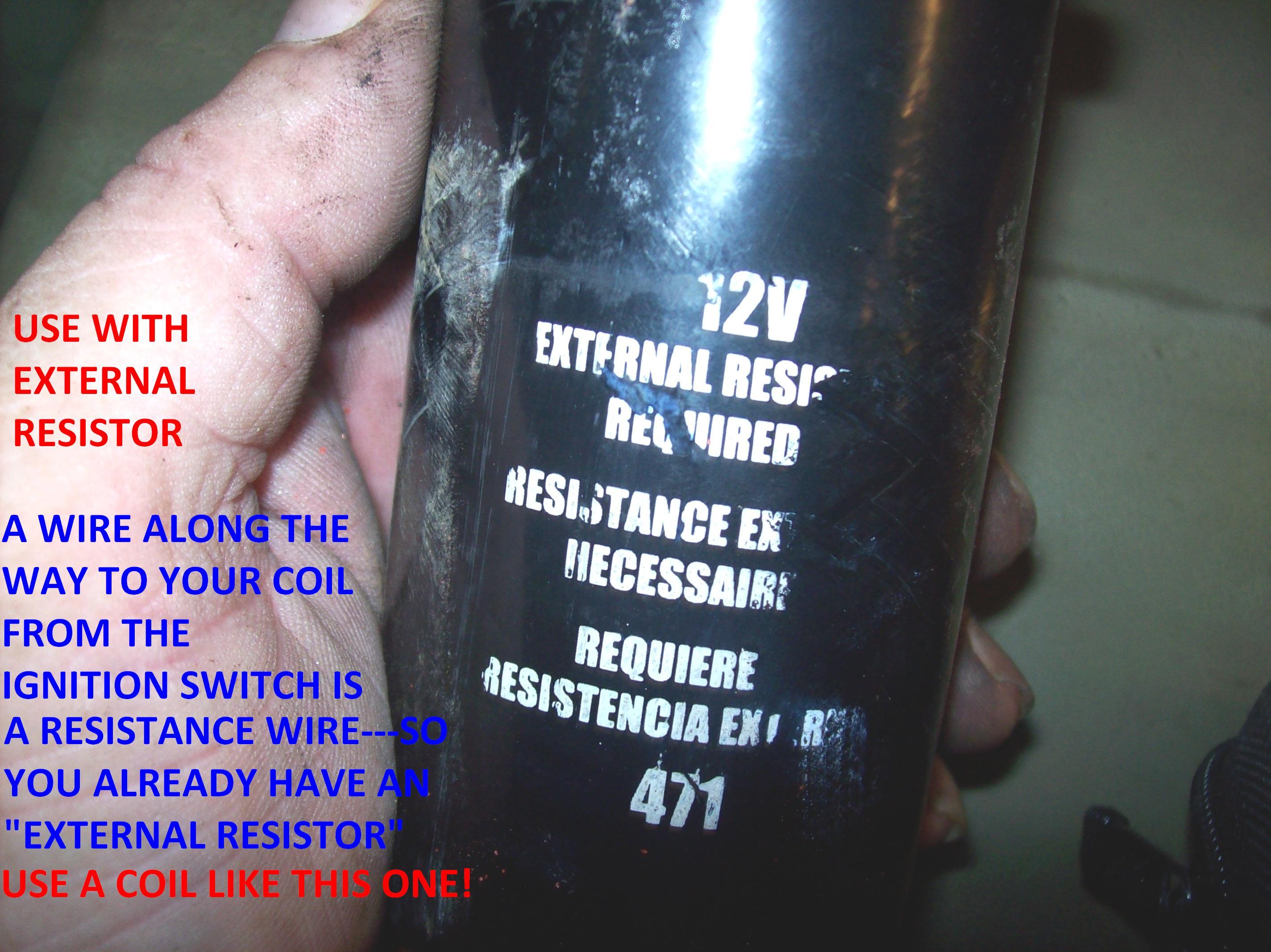

OK. THink I got it fixed. I think the straight 10GA wire to the Replacement TFI coil fried it, AND the new ignition module! I had the "New" Module tested and it failed.
Also when it died last time, the coil was so hot you could fry an egg on it. SOOOO. Here's what I found out
I installed the NAPA #ICR 22 Resistance wire, swapped in a NEW, TESTED, Duraspark 2 blue grommet module, using the installed "New" TFI coil. Crank. No start. No reference pulse to TBI.
I have two brand new Accell SUper coils that use ford style TFI plug. I un hooked the TFI coil was hooked up the Accell super coil (E-coil TYpe). FIred right up and ran like a top.
So as above, I'd have to say RUN THE RESISTANCE WIRE BY ALL MEANS! Running without --fried my NEW TFI coil and NEW Duraspark module within 15 Minutes!

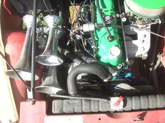

From the pics, my engine bay on the passenger side is pretty jam packed. It was a bear to find a suitable space to mount that Accell Super E-coil. It's BIG and has ample cooling fins. It didn't even get WARM with the engine running!
I mounted it on the inside of the passenger side fender next to the Jacobs Prostreet, and above the Jacobs Ultra COil.

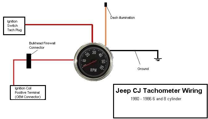

GUYS. I think I just figured it out!
Almost 20 years ago I had a no start/ cut out issue on this jeep. (Before the TBI was installed) Turned out to be a malfunctioning Factory Tachometer.
The Jeep factory tach works off the Positive side of the coil-- NOT the negative as most other aftermarket tachometers do. In fact, powers runs from the ignition switch THROUGH the tachometer and out to the coil. It's wired in series with the coil. If your factory tach starts going bad, it WILL cause a host of ignition issues.
Damn! I had forgotten all about this. You can bypass the tach by unplugging the red power wires that run TO and from it (and on to the coil and Ignition module) and then plugging the two together. A CJ without factory tach has these plugged together, instead of two and from the Tach.
I have noticed the tach has been somewhat erratic as far as the needle operation. Seems to bounce around a bit.
THis takes like 5 minutes to unhook and reconnect.
NONE of the factory manuals mention this. (Tat the OEM tach is in fact wired in series)! Look at the diragrams and pics and you'll see it.
I'll let you know shortly!
Monday, May 13th, 2013 AT 11:58 AM
AKMILSURP
  • 16 POSTS

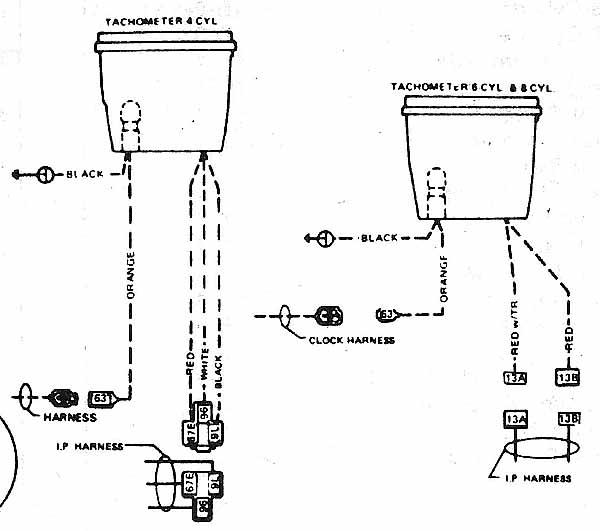

On an 80-86 CJ, the Factory tachometer is wired in SERIES from the ignition switch to the tach BEFORE the coil. IN fact if you disconnect the 13A and 13B connectors from the tach plugs, the Jeep won’t start-- NO power will go to the coil!
IF you connect 13A and 13B together to bypass the tach, the coil is powered and it starts right up.
So the Jeep factory tach is indeed triggered off the positive side of the coil, AND, is wired in series. If you have a bad tach, it can cause you all kinds of grief, and lead to madness! LOL

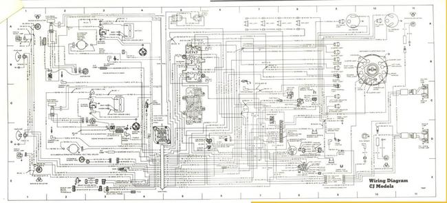

The factory Jeep Schematics do NOT show this, unless you look VERY closely. In fact, you may have to do as I did and look at Pre 1980 CJ diagrams. (Much is common with the newer models) Shoot the wires, you’ll see I’m telling the God’s truth here.
If you look at the Early CJ “General wiring” and trace the red power wires coming out of the ignition switch you will see the SAME numbered connectors. IT says “to tach”, but doesn’t SHOW the tach.
Hope this helps someone else!
