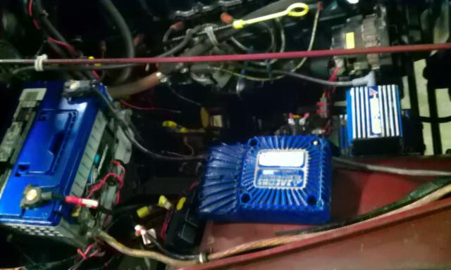

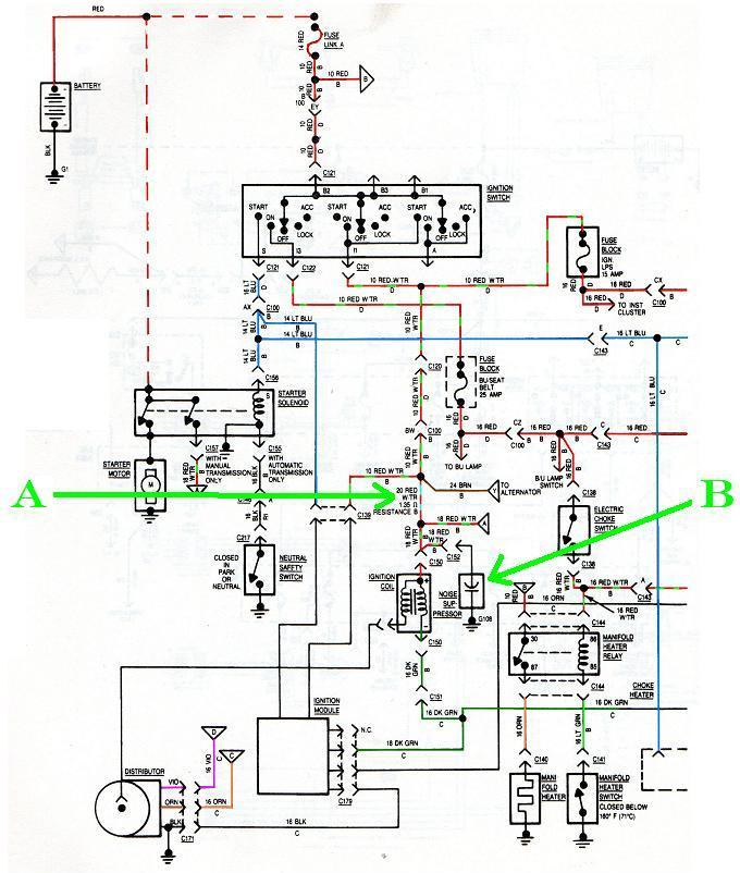

Is the CJ Medic there? Here goes:
- 84 CJ7 4.2 with auto tranny and CA emissions (resto'd in 2000 to basically stock)
- Been running rough for a few days, then died while driving (was rougher on hills and bumps)
- Cranks but won't start (good strong new battery)
- Replaced the starter solenoid about 2 mos ago (and freshly grounded it)
- Checked all fuses
- Coil is about 2 yo
- With key in run position I get power at both coil terminals (using simple lighted volt tester)
- Pulled one spark plug and cranked engine with remote starter; got a spark (maybe could have been brighter, but I did get one)
- Noticed that plug was very dry
- Looking into carb and manipulating the levers I can see plenty of fuel squirting in
- No air issues
- I have a voltmeter and am minimally competent in its use
I'm stumped! Please help!

O your basic ignition checks first like cracked cap coil wire to dist cap then to plug if the spark is weak then ti can be several things. How good are you at testing things? Do you have an ohm/volt meter?

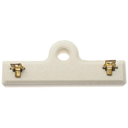

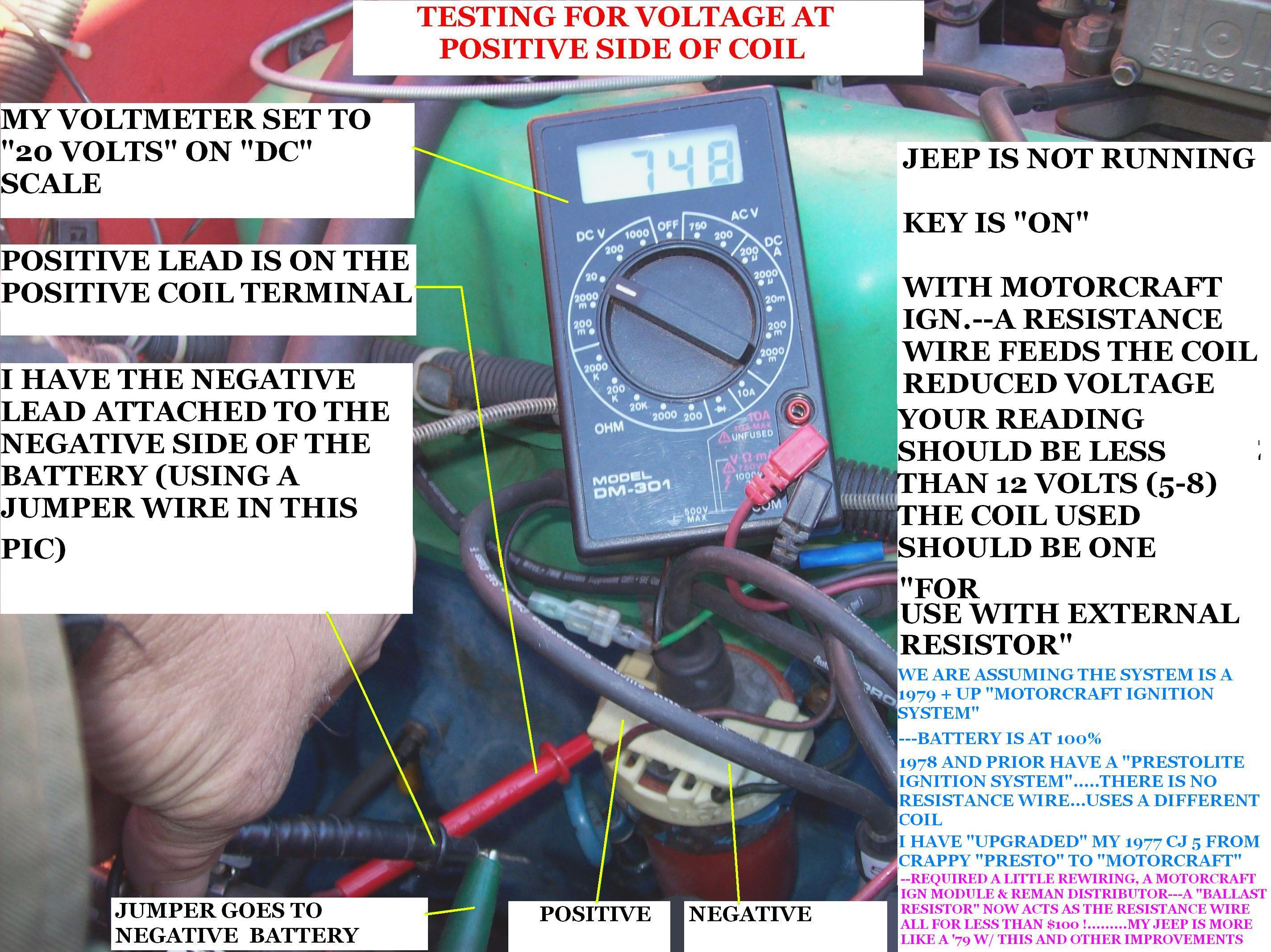

- I thought that maybe my spark was weak (see my post above) so I made two changes: (1) I installed a new ballast resistor (a previous mechanic had cut it out of the loop), and (2) I replaced the coil. I checked just about everything else I could think of (disconnected wires, corrosion, etc) - no major issues. Then tried to start. No joy. Great crank but it almost sounds like no gas getting to the engine (to me at least).
I read your post and did the voltmeter test on both old and new coils. Readings for both = 12.36! Based off of what you've told me something is not right. (And Medic I've read some of your other posts - your posts got me on this site.)

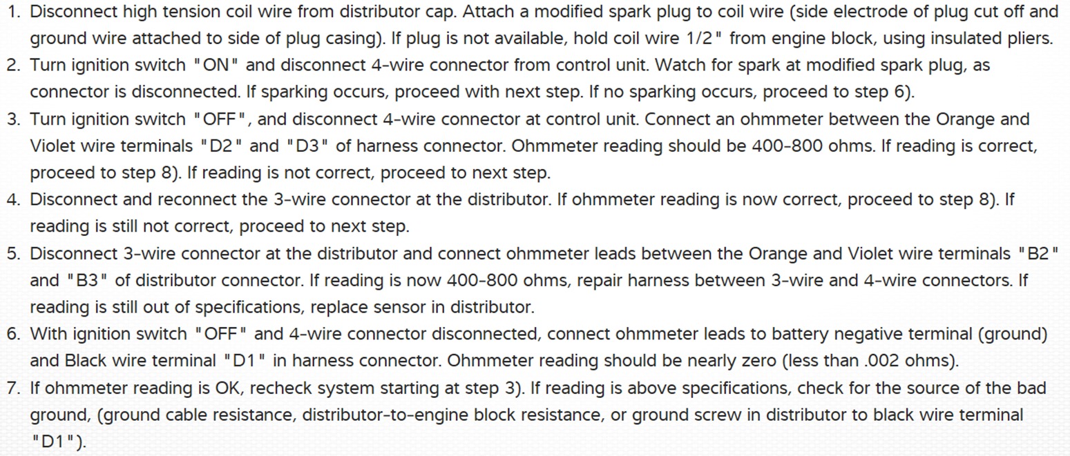

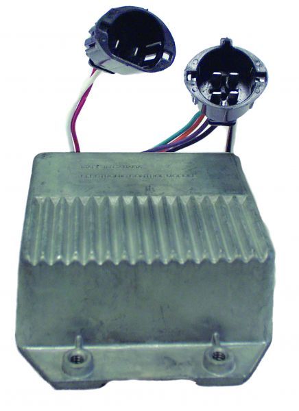

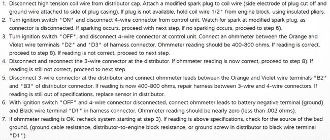

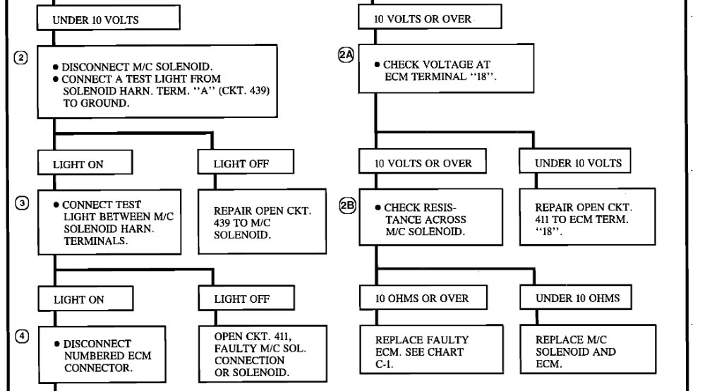

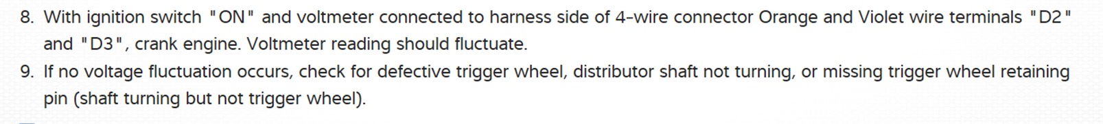

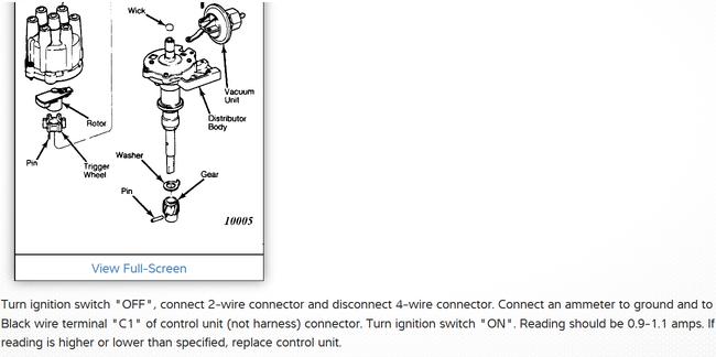

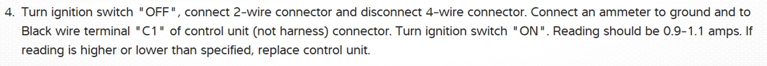

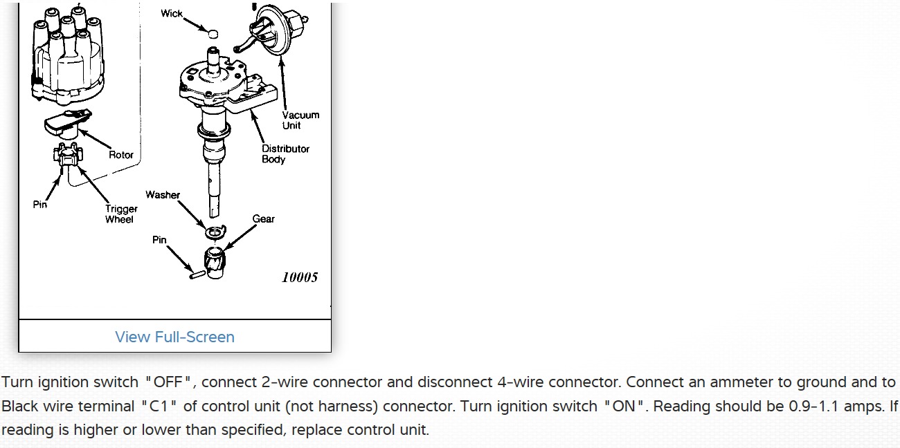

First ting if the ballast resistor was cut out then it probably fried the coil as it's supposed to cut the voltage down. It may have fried the ignition box as well.

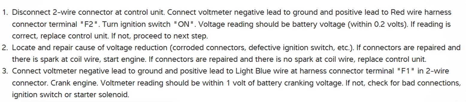

See pic below
Thursday, June 5th, 2014 AT 6:24 AM
VINNYL
  • 12 POSTS
Hmac,
- I can't see your second image.

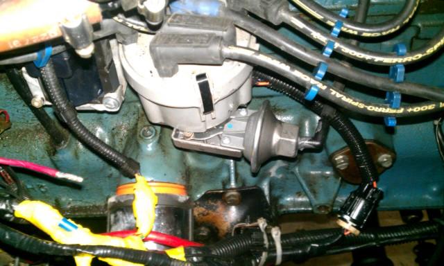

- First image is a pic of the distributor. I think the verbiage at the bottom is a procedure to test the ignition module. Is that correct? My ignition module looks kinda like the picture here, except I have a 3 wire connector (not 2) and a 4 wire connector I think. I will try to run this test tonight.
Thanks.
Thursday, June 5th, 2014 AT 9:07 AM

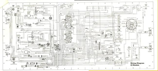

Ok've done these all in pdf so you should be able to get them full size or make them larger.
Thursday, June 5th, 2014 AT 9:52 AM
VINNYL
  • 12 POSTS
Can't make sense of any of these files - each one is cut off badly on the left hand side.
Thursday, June 5th, 2014 AT 1:59 PM

Trying again lol. These may enlarge don't know
Friday, June 6th, 2014 AT 6:22 AM
VINNYL
  • 12 POSTS
Got 'em! Thanks!

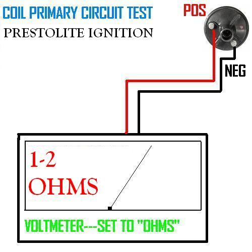

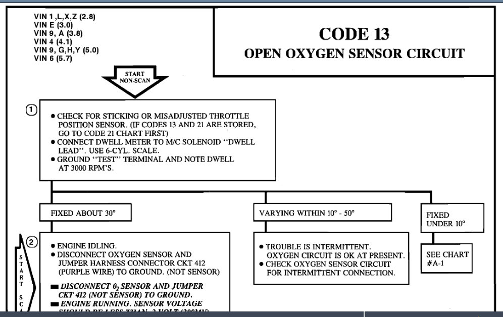

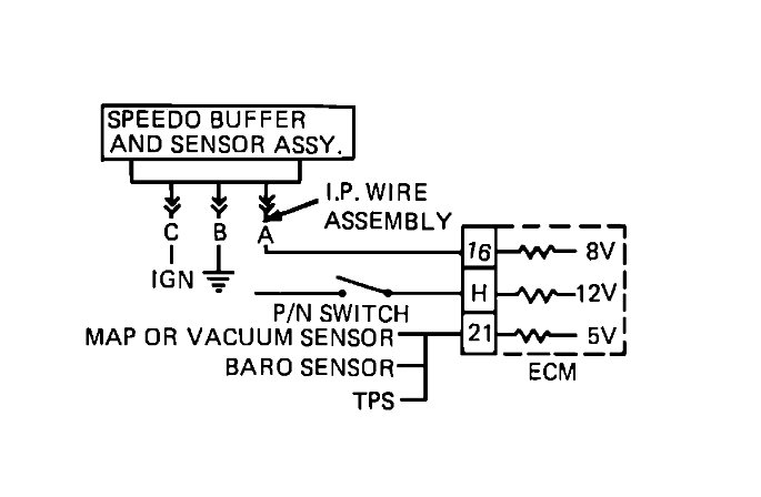

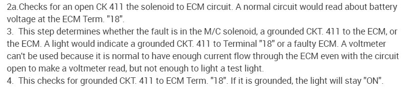

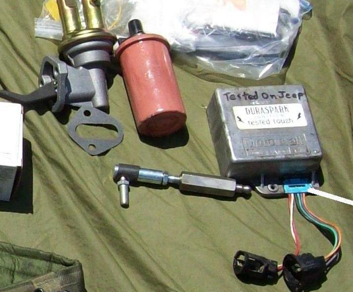

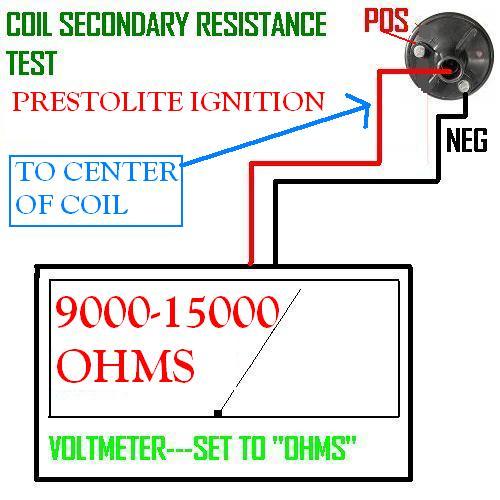

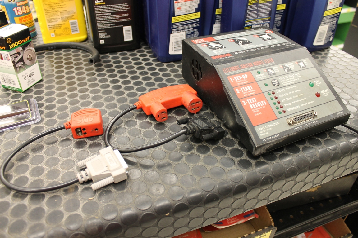

LETS GET A BABY FOOD JAR OR EQUIV, TAKE THE RUBBER FUEL LINE LOOSE AT THE CARB. STICK IT IN THE JAR AND TURN IT OVER TILL YOU HAVE 1/2 A JAR FULL. NOW OUT OF YOUR FUEL CAN, ADD SOME "GOOD FUEL" TO THE JAR. DO YOU SEE THE "GOOD FUEL" FLOATING ON THE "POSSIBLE WATERED FUEL"?

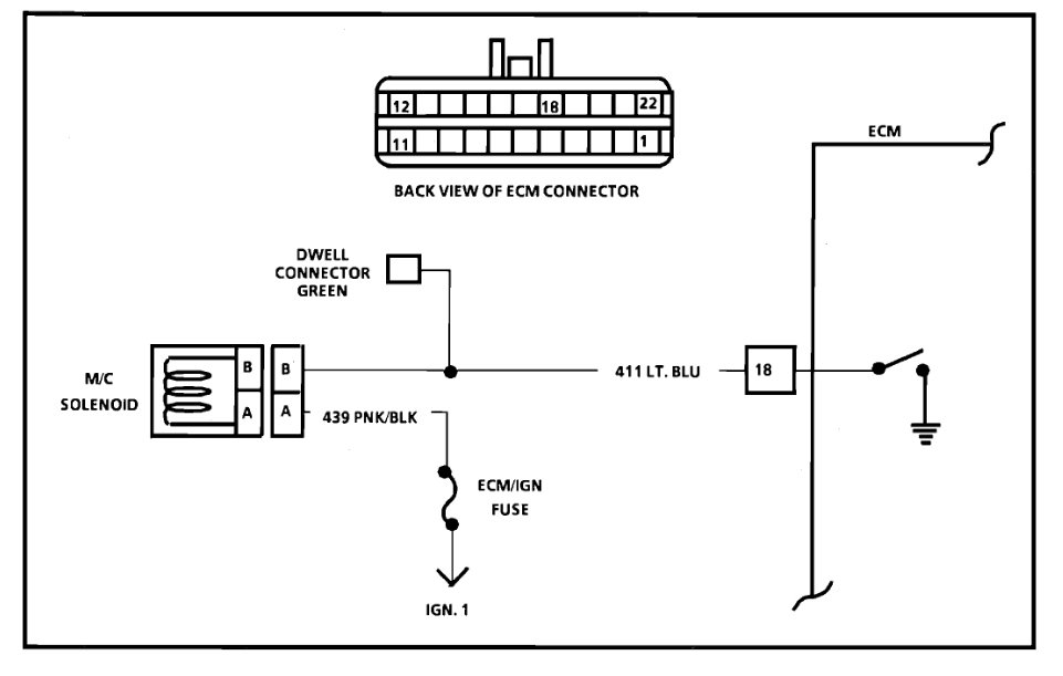

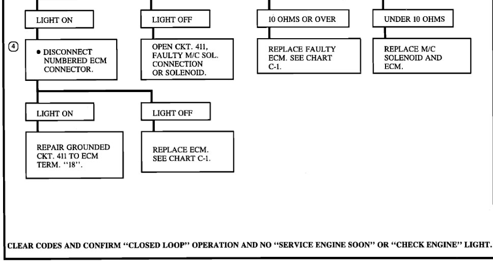

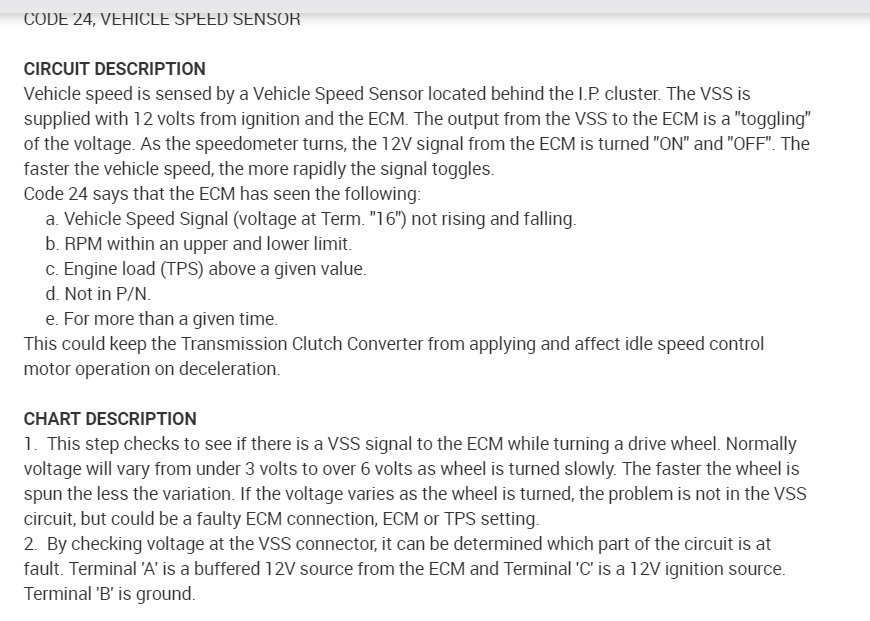

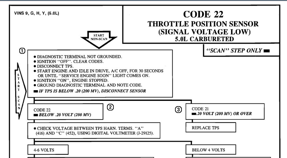

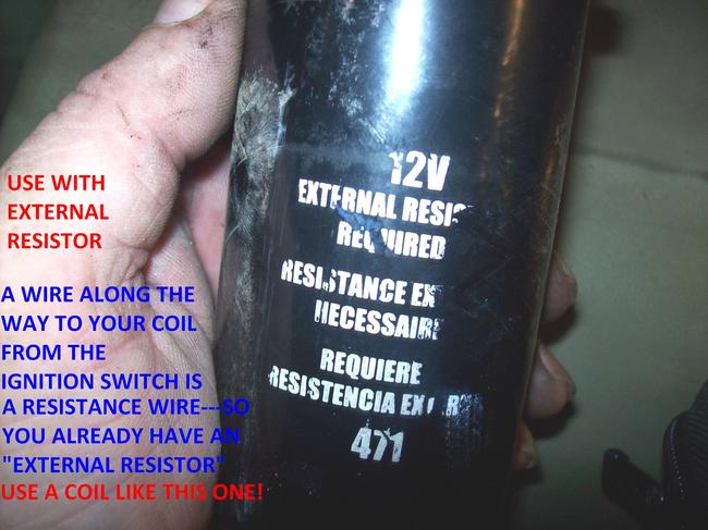

1) 12 VOLTS???? MAY BE TOO MUCH!!!!
2) DO YOU HAVE A STOCK COIL?
3) DO THIS TEST IN MY 1ST 2 PICS - WHAT ARE YOUR VALUES??? (THESE PICS ARE FOR A '77 WITH PRESTOLITE IGN) LETS SEE WHAT YOU HAVE!
4) PIC 3 IS OF THE "ADVANCE AUTO PARTS" IGN MODULE TESTER. (IF I SIZED IT SMALL ENOUGH TO WORK) HAVE THEM TEST IT AT LEAST 5 TIMES IN A ROW! (OR MORE) IMMEDIATELY ONE TIME AFTER THE OTHER. IF IT FAILS ONE TIME, REPLACE IT!. NOW TEST THE NEW ONE THE SAME WAY BEFORE YOU LEAVE THE STORE!!! YES, IT MAY BE "NEW-BAD"!
5) LOOK THIS POST OVER. THERE IS A TEST FOR THE DISTRIBUTOR WIRES IN IT SOMEWHERE IN THE 5 PAGES

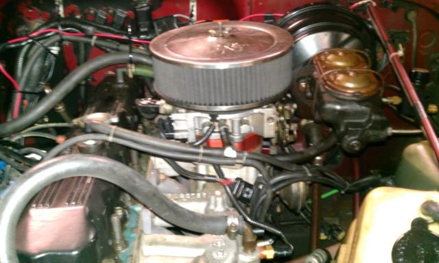

CAN YOU SEND GOOD PICS ? - FULL LEFT SIDE - FULL RIGHT SIDE OF ENGINE AND OVERHEAD TOO. HOOD RESTING ON THE WINDSHIELD FRAME-BREATHER OFF OF THE CARB

Success! It was the ignition module: I tested it per Hmac's second 'pic'. Replaced the module and she started right up. Not only that, she starts and runs better than she has in a really long time. Thanks guys!
So I think the ballast resistor being cut out of the loop may have caused or contributed to this. What do you think? I've reinstalled it.
Saturday, June 7th, 2014 AT 10:56 PM
HMAC300
  • 48,601 POSTS
Ke I said in one of the previous replies, cutting ballast resistor out probably burnt out the control module or ignition module they aren't meant to operate on 12 volts.
