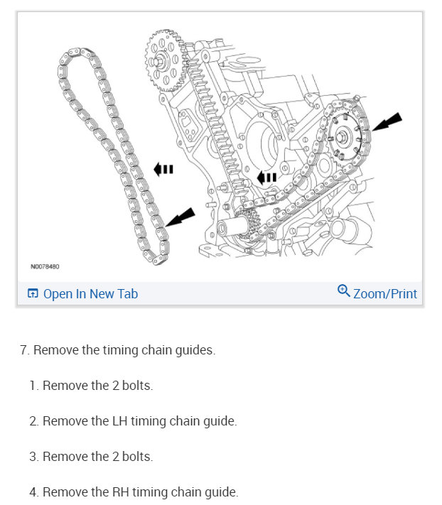

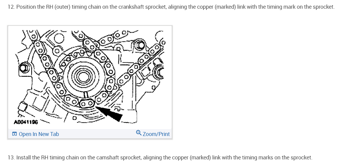

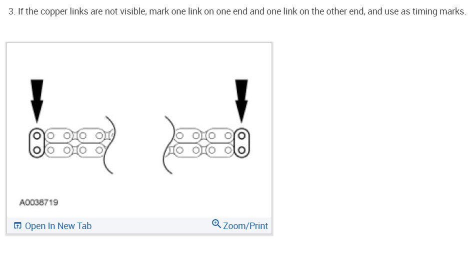

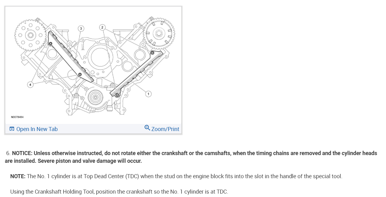

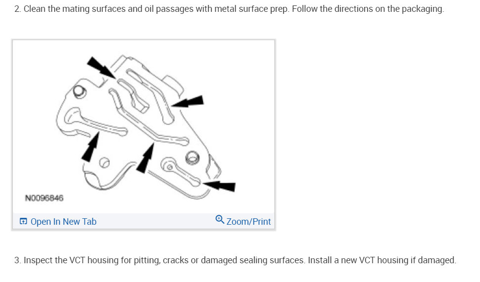

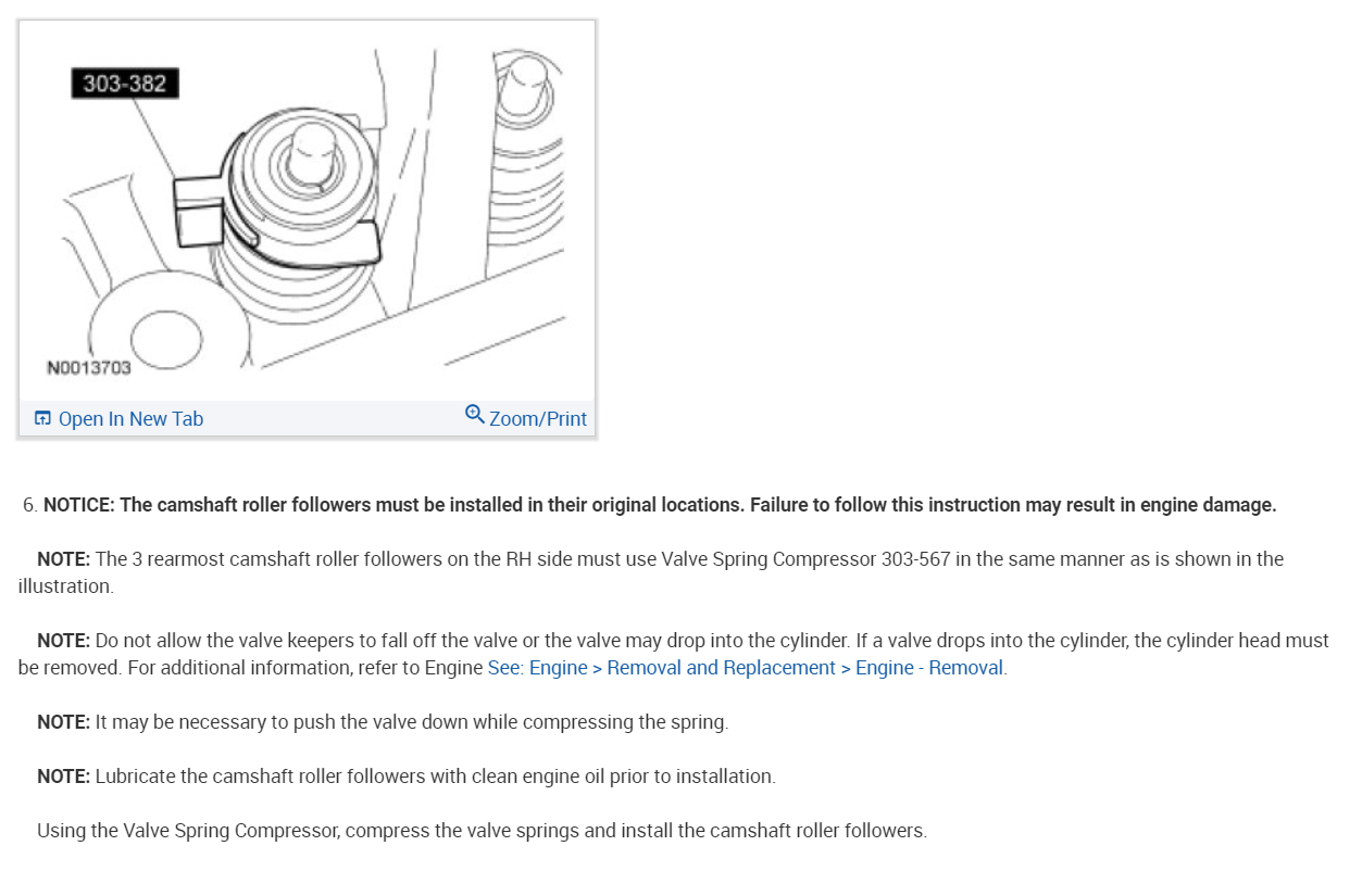

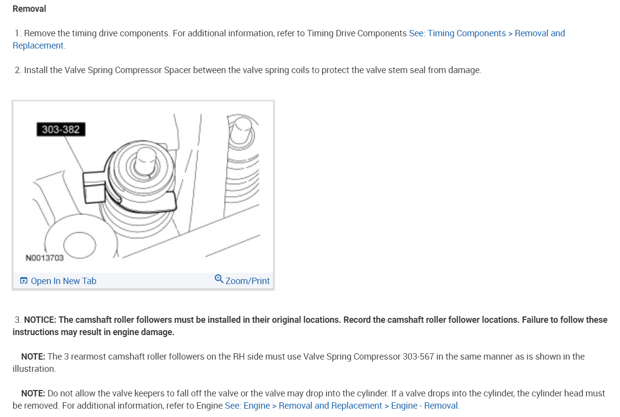

WES WRIGHT

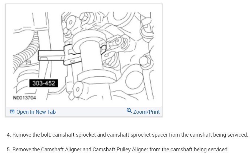

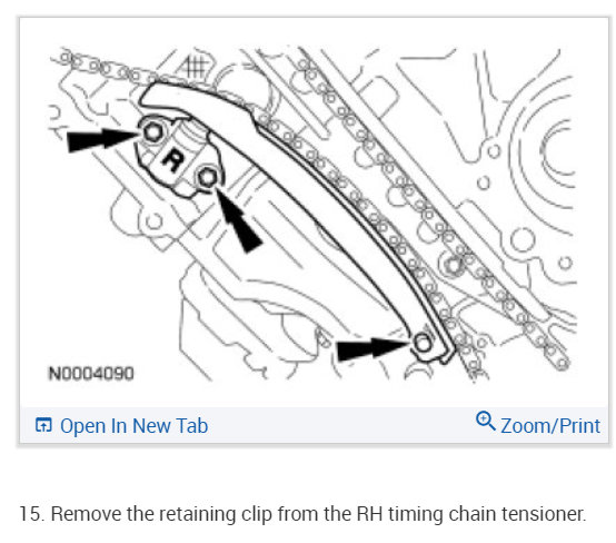

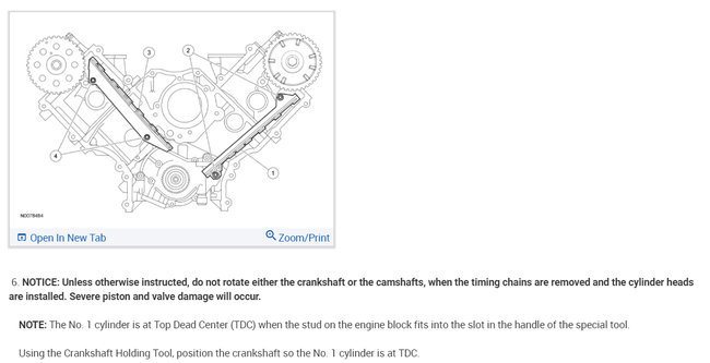

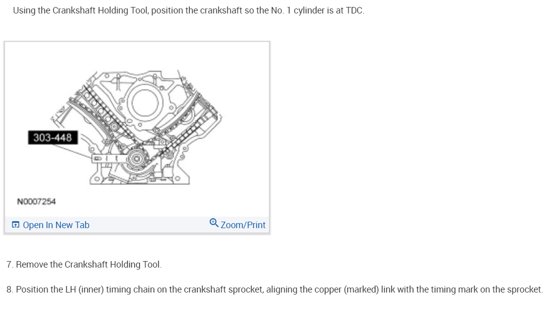

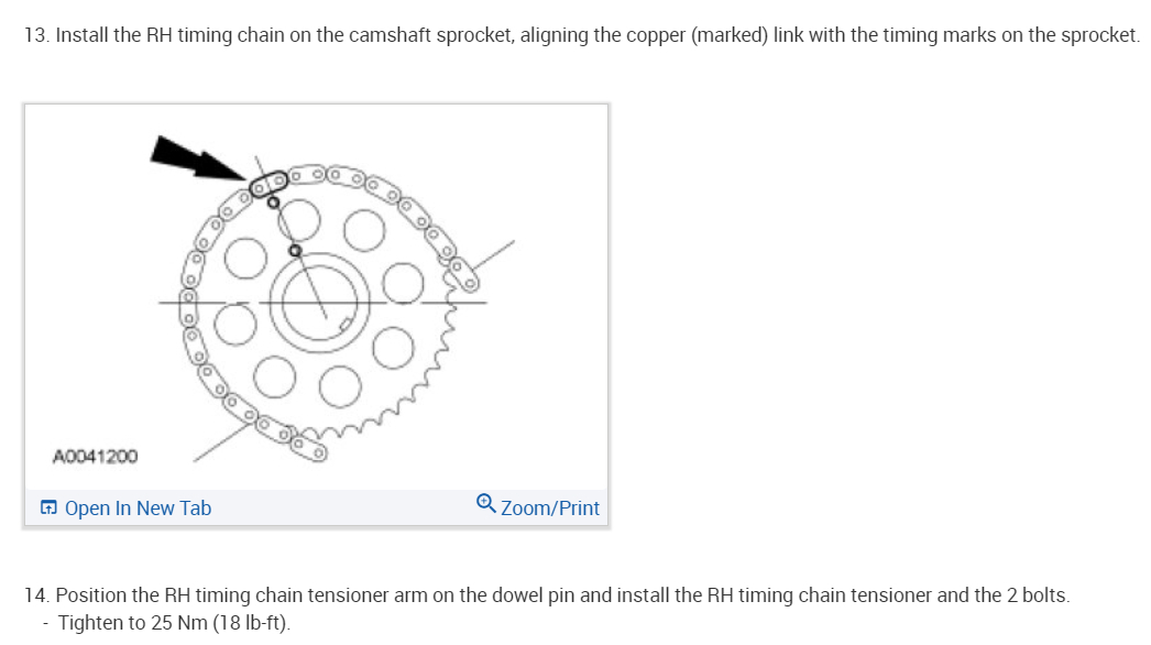

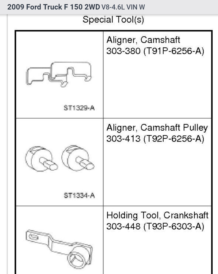

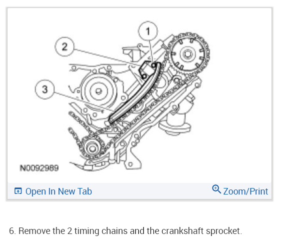

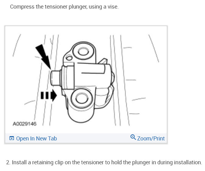

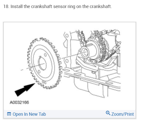

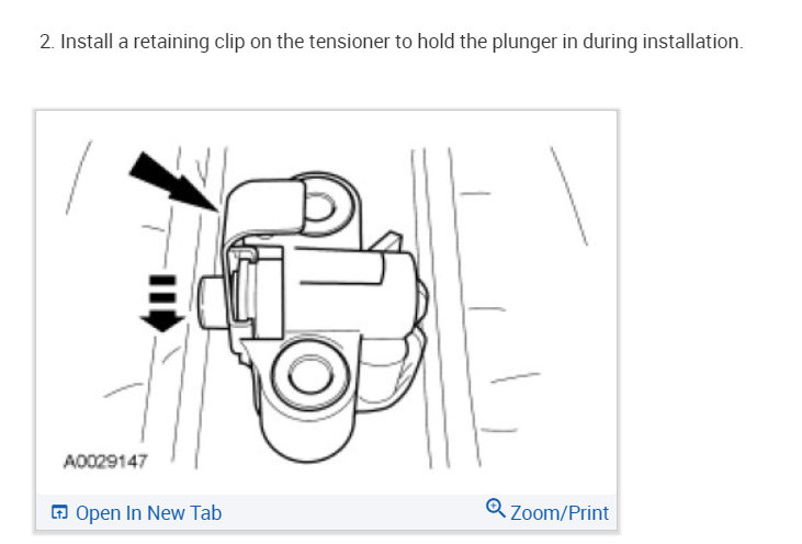

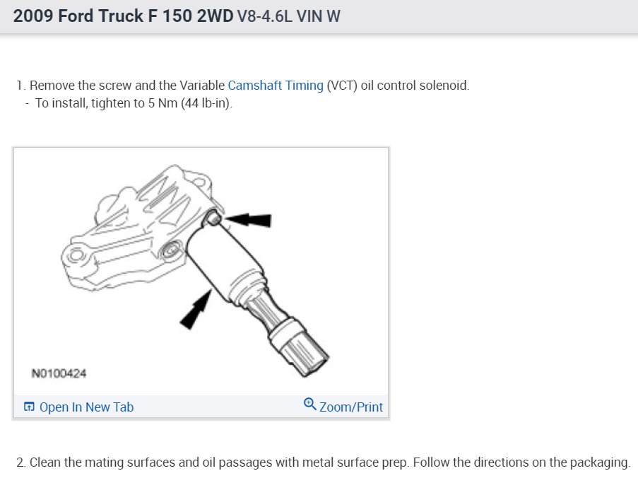

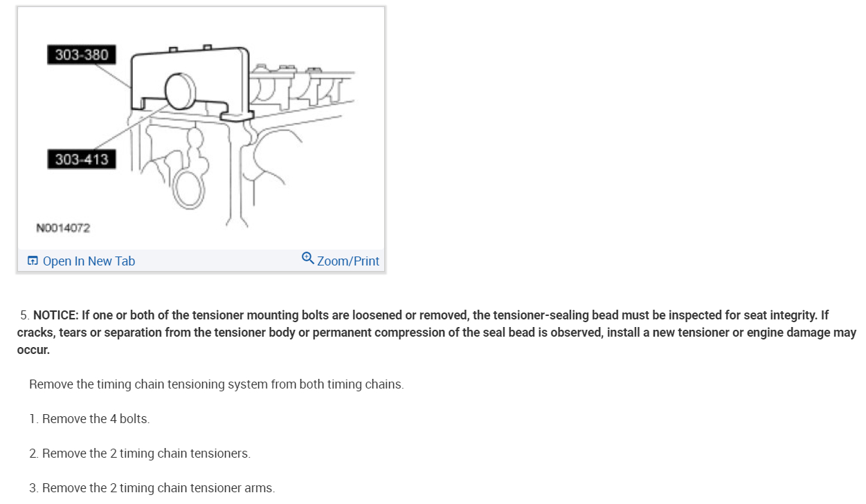

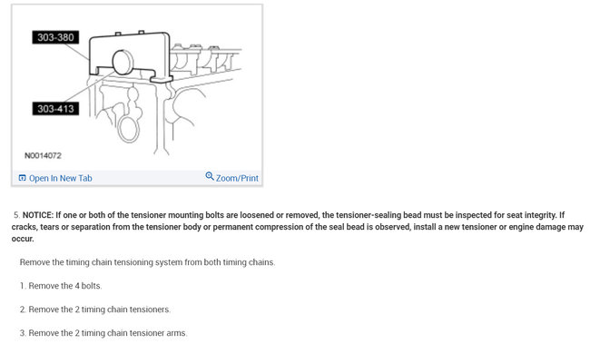

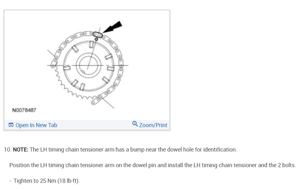

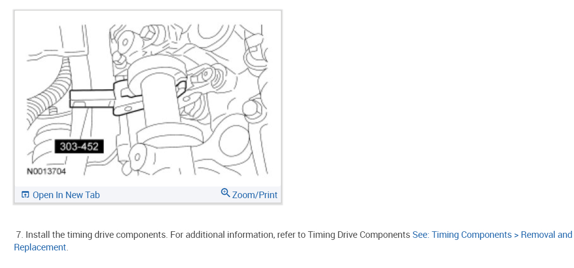

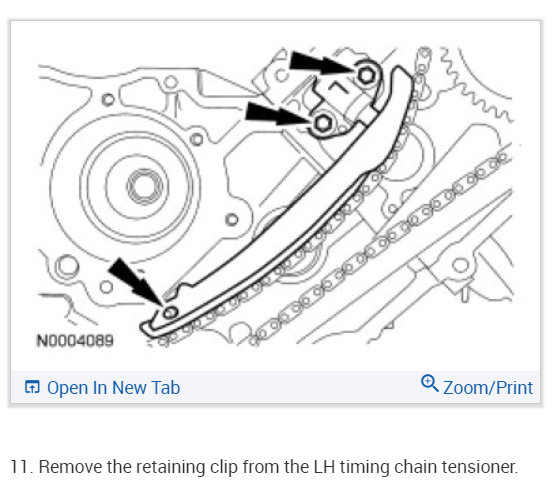

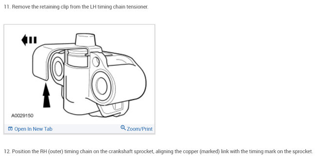

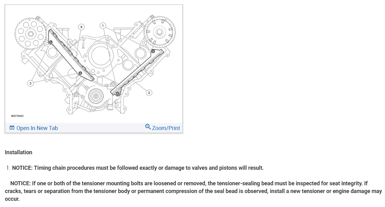

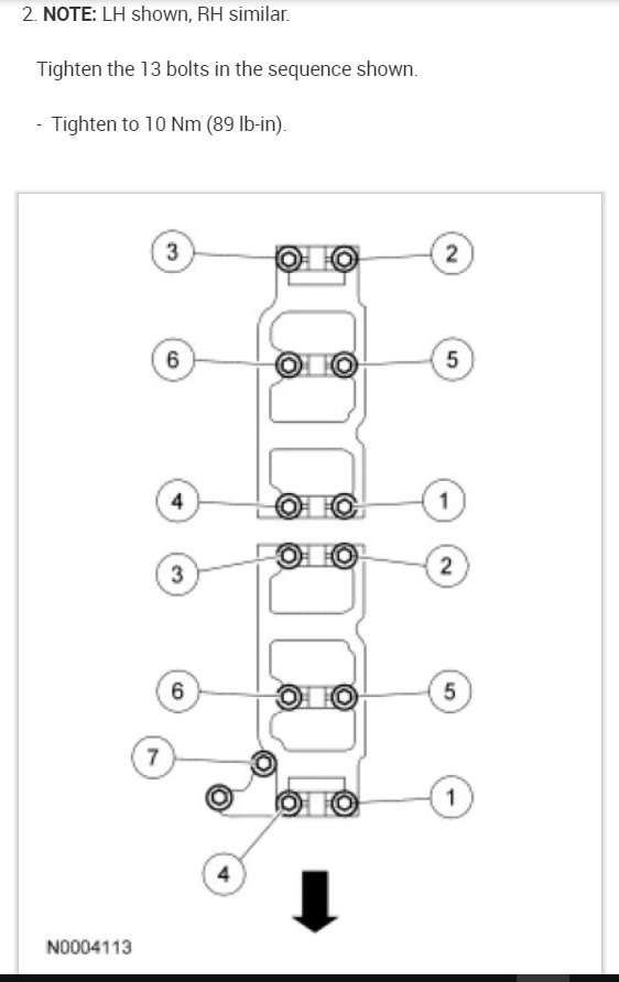

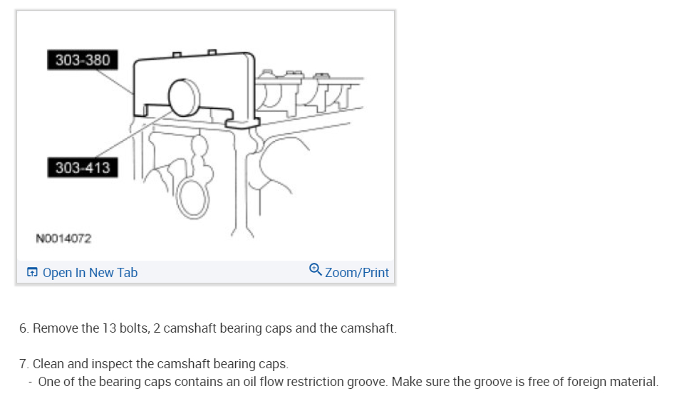

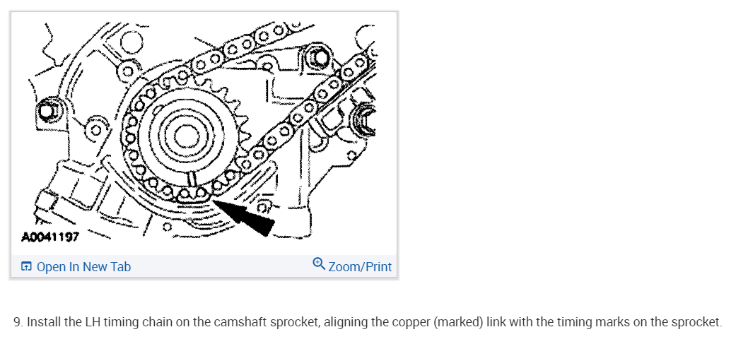

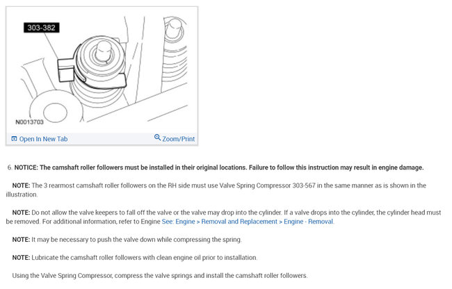

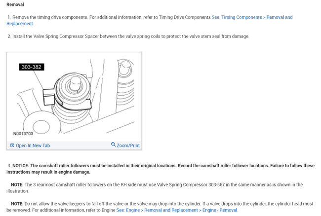

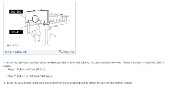

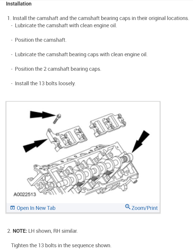

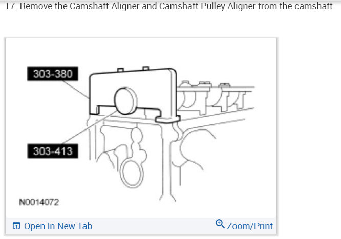

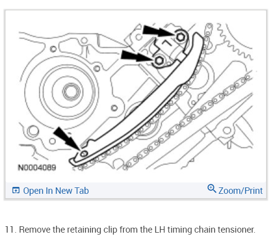

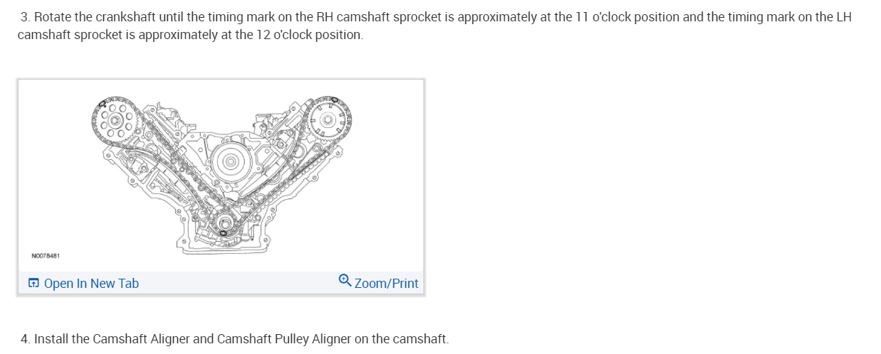

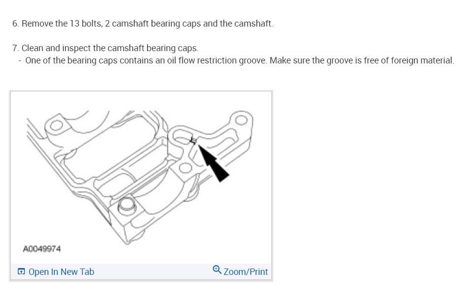

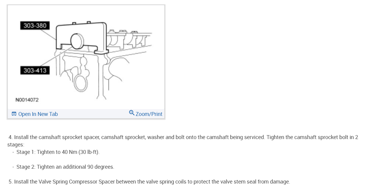

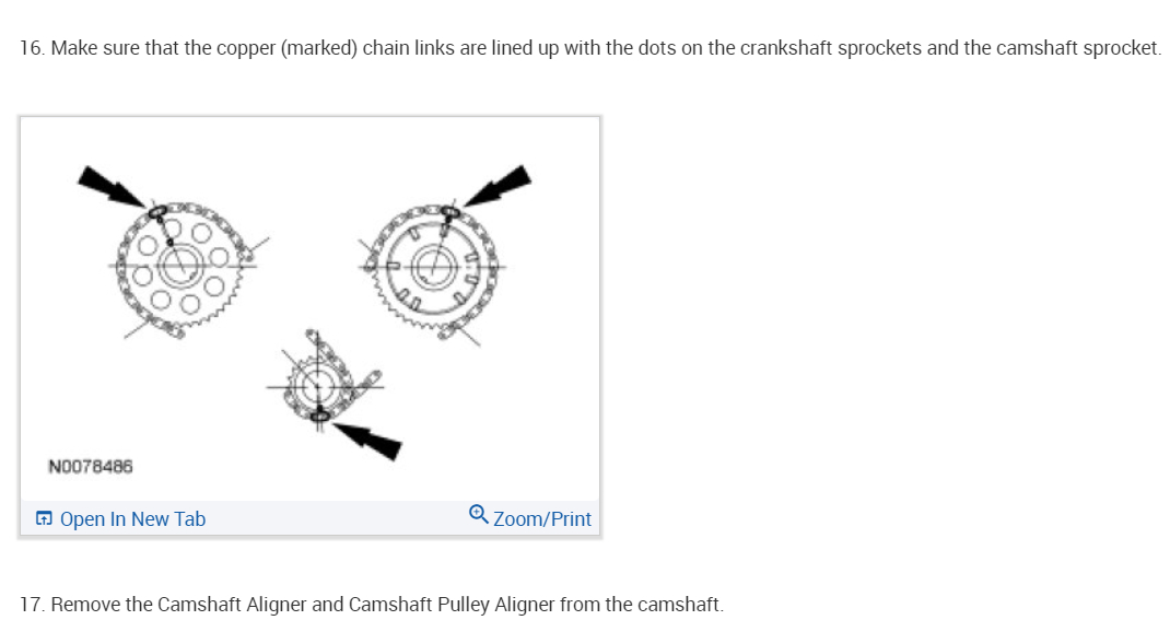

Changed out bank 1 camshaft and one follower. Also changed spark plugs and coils. I also changed both VCT solenoids. When I put the cam phaser back on I measured the gap between the phaser sprocket and the front cam cap and it measured 18mm which is the correct measurement. Now when running the engine it has a rough idle and check engine light has come on. Scanned the engine and found the following codes , P0022, PO303, P2007, P2006, P0300, P0341. I disconnected the VCT solenoids but it still has a rough idle have you any idea? I might add that the engine ran fine but I thought the VCT solenoids were faulty. The cam shaft needed changing cause I heard a tapping coming from bank 1 I pulled the valve cover and found number one cylinder exhaust follower had stopped working and wiped the lobe on the cam. What are your thoughts?
Dec 15, 2020 at 7:25 AM (Merged)
  • 55,381 POSTS
The cam lobe being gone will cause the rough running and the code P0022 is telling you the cam phaser is not working/holding oil or getting enough oil pressure. Is the oil level full correct weight freshly changed? I have seen all of these cause the problems with the phaser. Here are diagrams to help you get the camshaft and camshaft actuators changed out. You should do the chains while you are in there.
