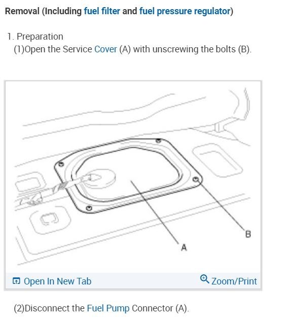

I need to change my fuel filter where is it?
AL514
  • 4,739 POSTS

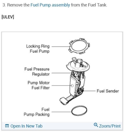

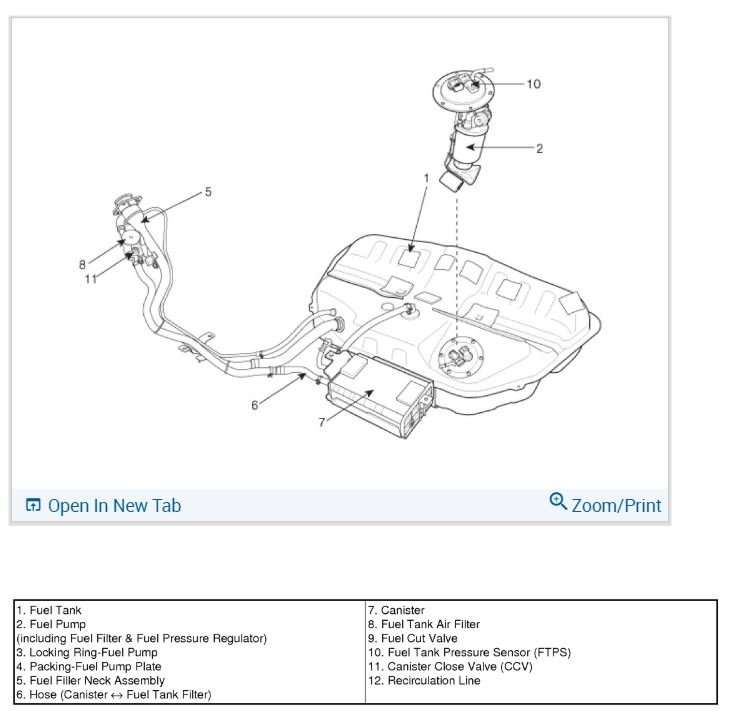

Hello, unfortunately the fuel filter is part of the fuel pump assembly. Here is a diagram showing its location. A fuel pressure test would verify if thats the actual problem or if its something else. Has the check engine light come on at any time?
Saturday, August 1st, 2020 AT 11:08 AM (Merged)
2CP-ARCHIVES
  • 4,540 POSTS
  • 2002 HYUNDAI SONATA
  • 191,000 MILES
How to get to gas filter and change it
DRCRANKNWRENCH
  • 3,380 POSTS
The fuel filter is inside the gas tank on top of the fuel pump assembly. You simply remove the hose clamps and change it. Make sure you take note of the arrow on filter that indicates flow direction and put the new one in the same way if it has one.
