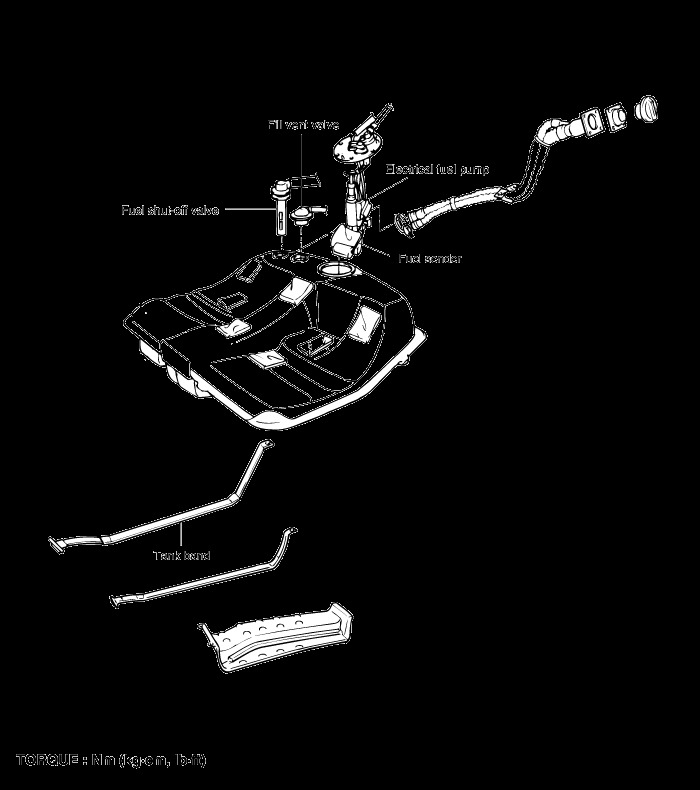

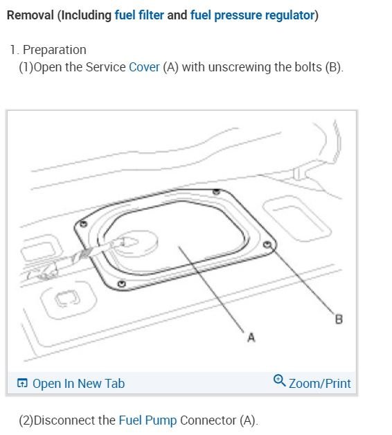

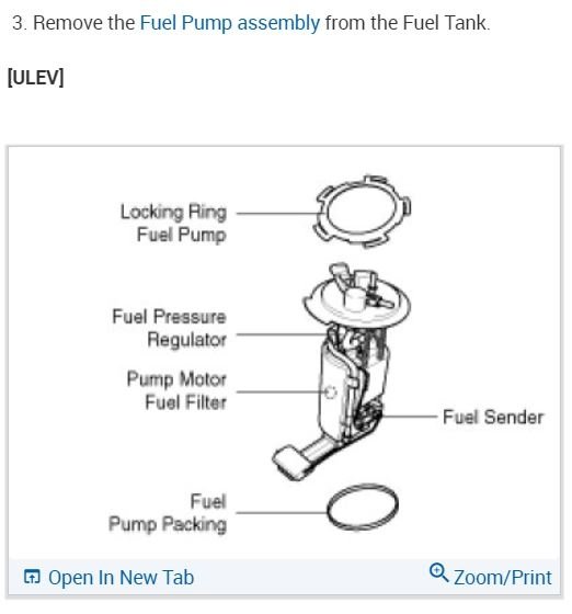

I need to change my fuel filter where is it?
49,500 MILES • 2.4L • 4 CYL • 2WD • AUTOMATIC
AL514
  • 5,700 POSTS
Hello, unfortunately the fuel filter is part of the fuel pump assembly. Here is a diagram showing its location. A fuel pressure test would verify if thats the actual problem or if its something else. Has the check engine light come on at any time?

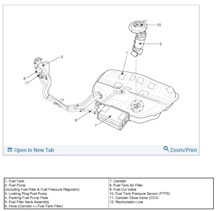

how to get to gas filter and change it
Aug 1, 2020 at 4:08 AM (Merged)
DRCRANKNWRENCH
  • 3,380 POSTS
The fuel filter is inside the gas tank on top of the fuel pump assembly. You simply remove the hose clamps and change it. Make sure you take note of the arrow on filter that indicates flow direction and put the new one in the same way if it has one.
