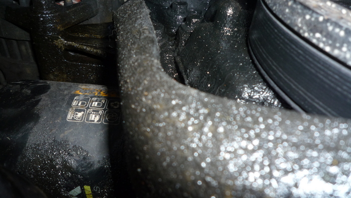

Can a bad aux water pump on 02 ls v8 cause overheating? Changed thermostat and it quit overheating for about 90 miles. Car began to overheat again. Heater also doesn't work. Cant get steady stream from bleed hose by degas when i try.. already have electric fan bypass installed
Jan 10, 2018 at 9:29 AM
Because of the heater not working along with the engine overheating I would think you have a blown head gasket which fills up the heater core with exhaust gases making it not work.

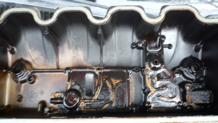

Here is a guide top help confirm the issue.
Please run this test and get back to us.
Jan 11, 2018 at 3:52 AM
Inhad the car for about 7 months woth the heater not working before having any over heating issues. Woukd that matter? Will follow link now
Jan 11, 2018 at 4:15 AM
It can happen overnight basically let me know what you find.
Jan 11, 2018 at 4:29 AM
Bottom of oil cap has residue like described in link
Jan 11, 2018 at 4:31 AM
Yep you have found the problem. Please let us know how much It will cost to fix.

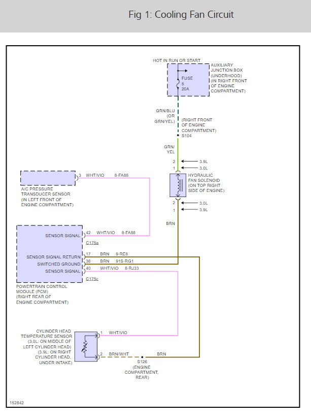

Hi, the cooling fan works off from a temperature switch that senses when engine temperature requires cool down. Also, a fan relay so the fan relay fan motor or temperature sensor has failed. I would have vehicle scanned for codes this will help pinpoint which one has failed. Here are the fan wiring diagrams so we can see how the system works.
These guides can help as well.
https://www.2carpros.com/articles/engine-overheating-or-running-hot
and
https://www.2carpros.com/articles/replace-electric-fan-motor
Cheers
and
Cheers
Aug 1, 2018 at 1:25 PM
(Merged)
I thought the Lincoln IS v-8 does not have a relay for the radiator fan. Although I am not sure. Is this an easy fix?
(Merged)
It has a relay but it is integrated into a multinational relay. The easiest part to change is the temperature sensor.
