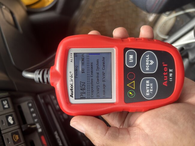

Codes P1457 and P1456?

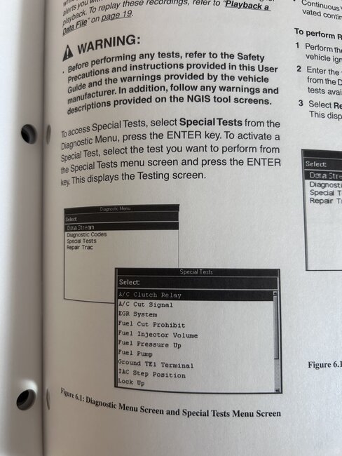

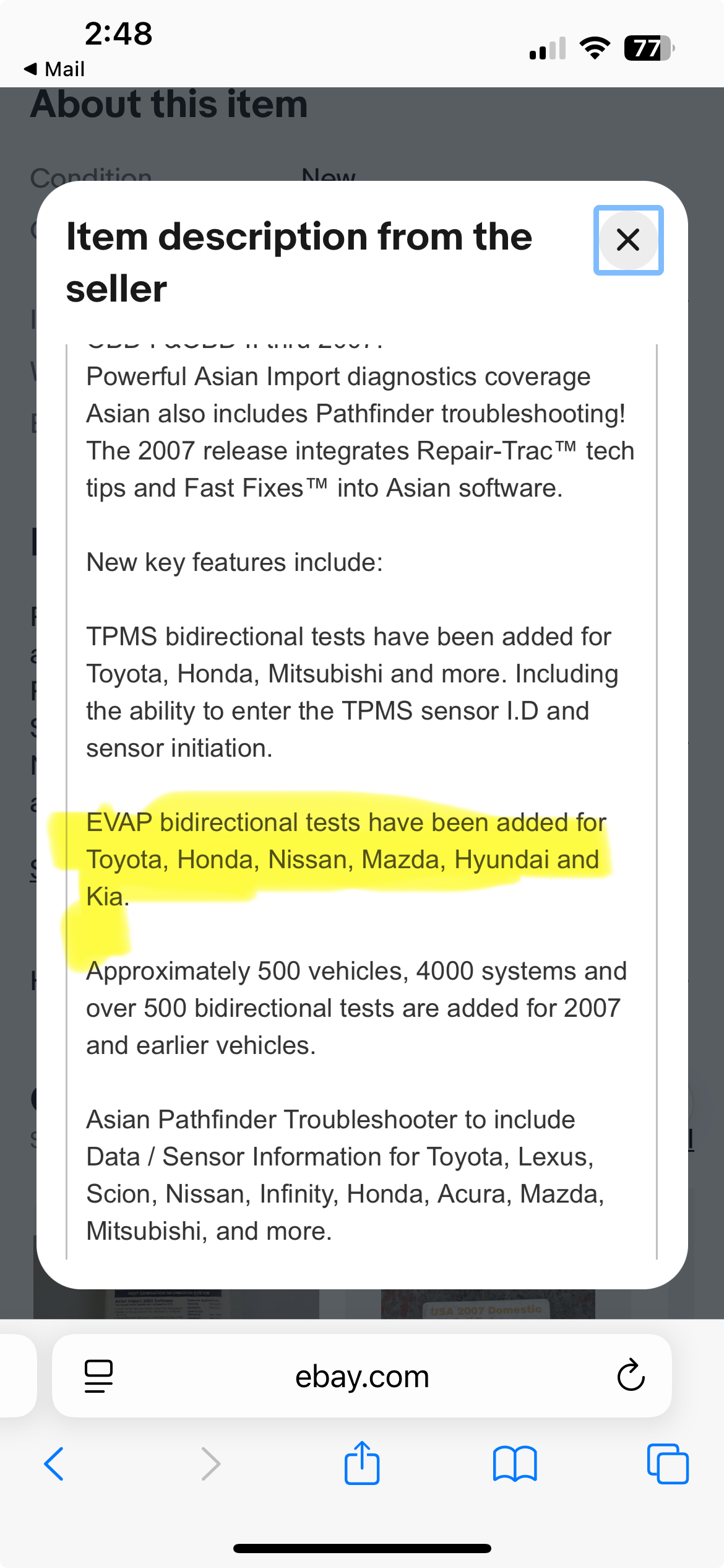

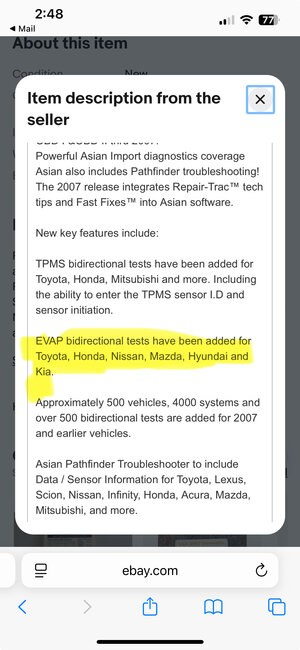

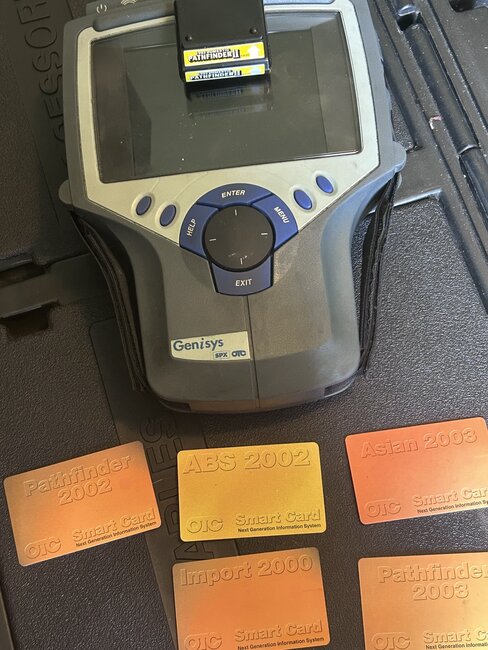

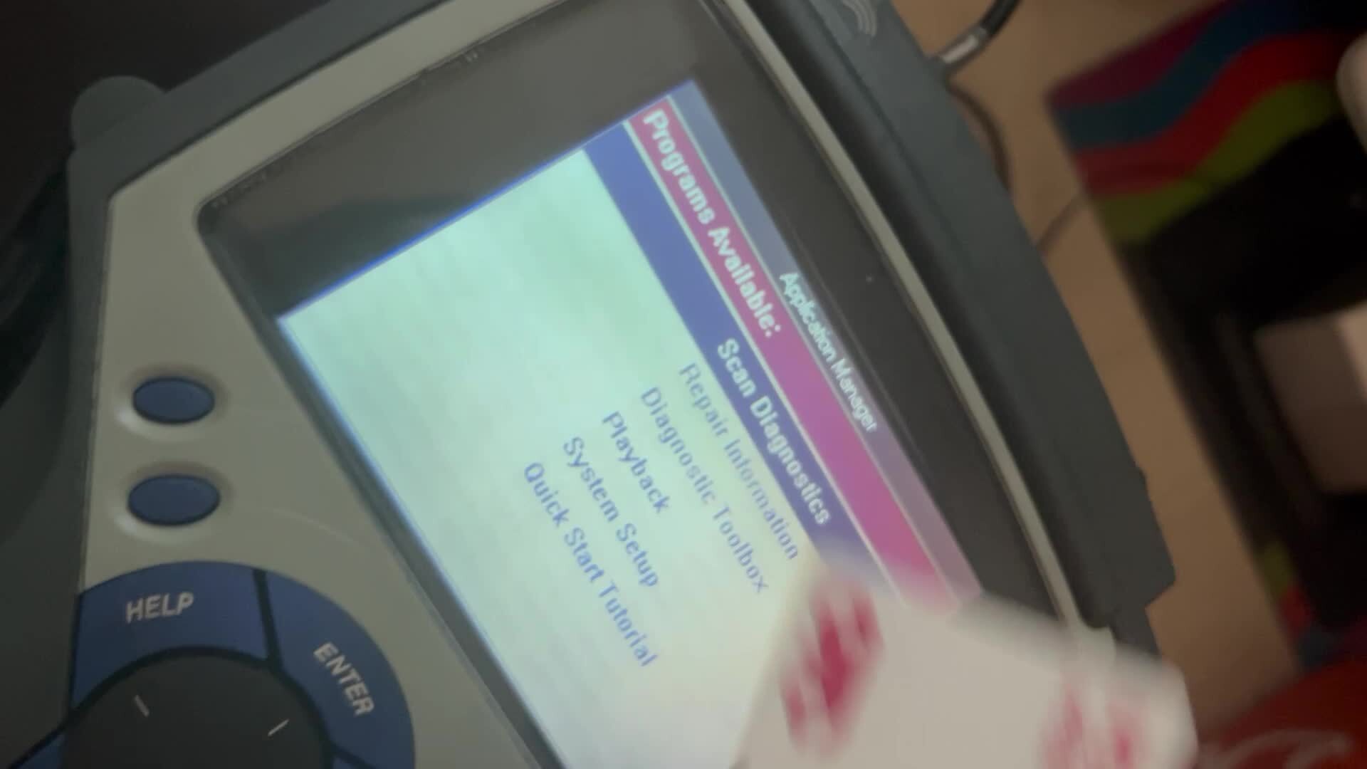

Hey there! I did attempt to upgrade the scanner to the 2007 but the computers are not recognizing the scanner despite purchasing a few retro items to accommodate the update. The internet upgrade doesn’t seem to function either. Do you know of an alternative way to get it to update?
It's been a while, but I seem to recall that to do the updates you loaded the software onto the computer, then updated the application on the computer then used that to update the memory card using a card reader. Then you plugged the memory into the tool and used the card to activate it.
Jun 3, 2025 at 2:44 AM
Thank you! I will give it another go. If I'm unable to, I will probably bite the bullet and get a more modern scanner.

Hey there! I did try it out again and was unable to get it to function. For some reason the USB doesn’t send down stream and up stream despite having a cord from that era.
I believe my scanner was before the memory card version. The 2.0 version of the scanner I have has an ethernet to RS232 cord. Maybe I needed the 3.0 version to upgrade to the Asian 2007 card.

The memory card should be under the cover on the left side of the tool. It is a large compact flash card. Do not try to format it. Instead, you use a card reader and the software on the disc to load the card. You should be able to go to 2008 on the system 2 and 3.

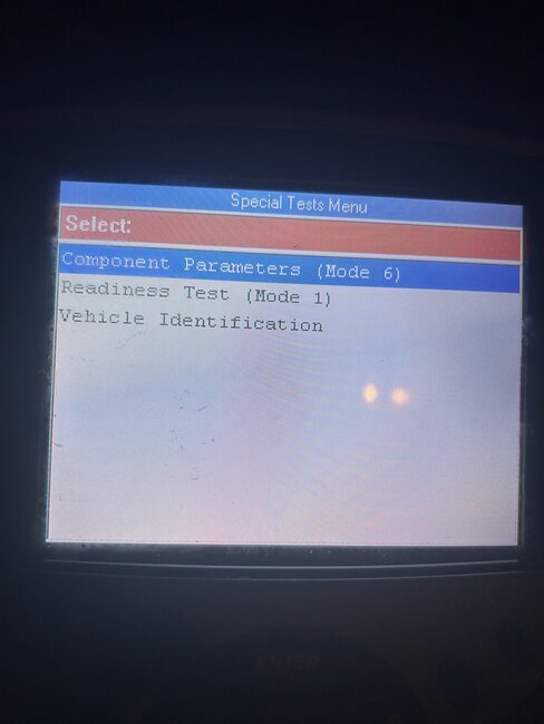

Jun 7, 2025 at 10:32 AM

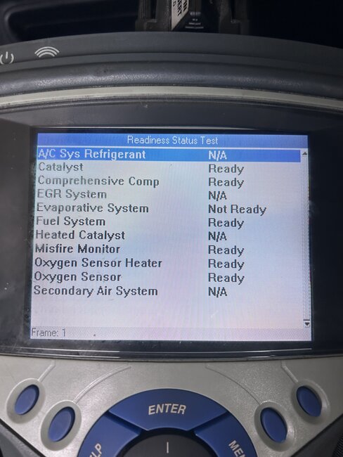

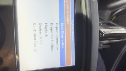

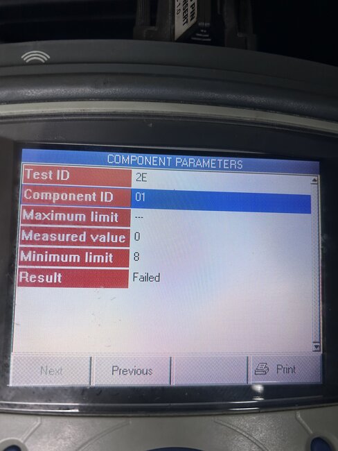

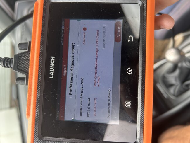

Hey there! I Had returned the unit before the window to do so closed. I only had a month. I went on ahead and went for a more modern scanner. I have a 2025 LAUNCH Creader Elite V2.0 for Honda and Acura.

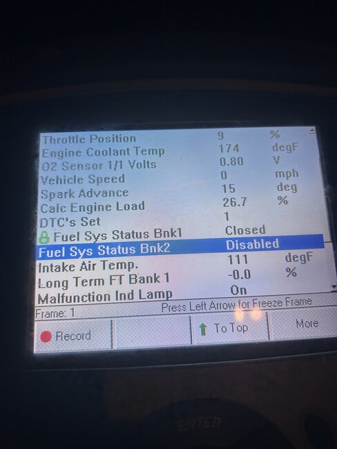

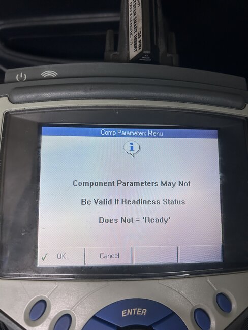

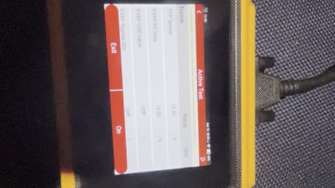

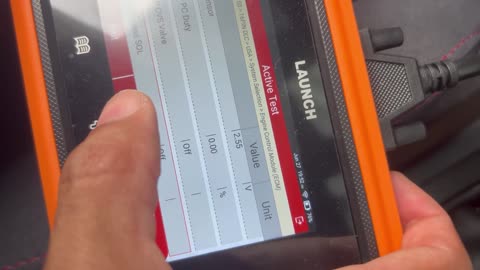

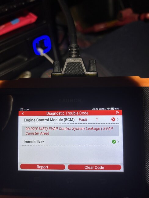

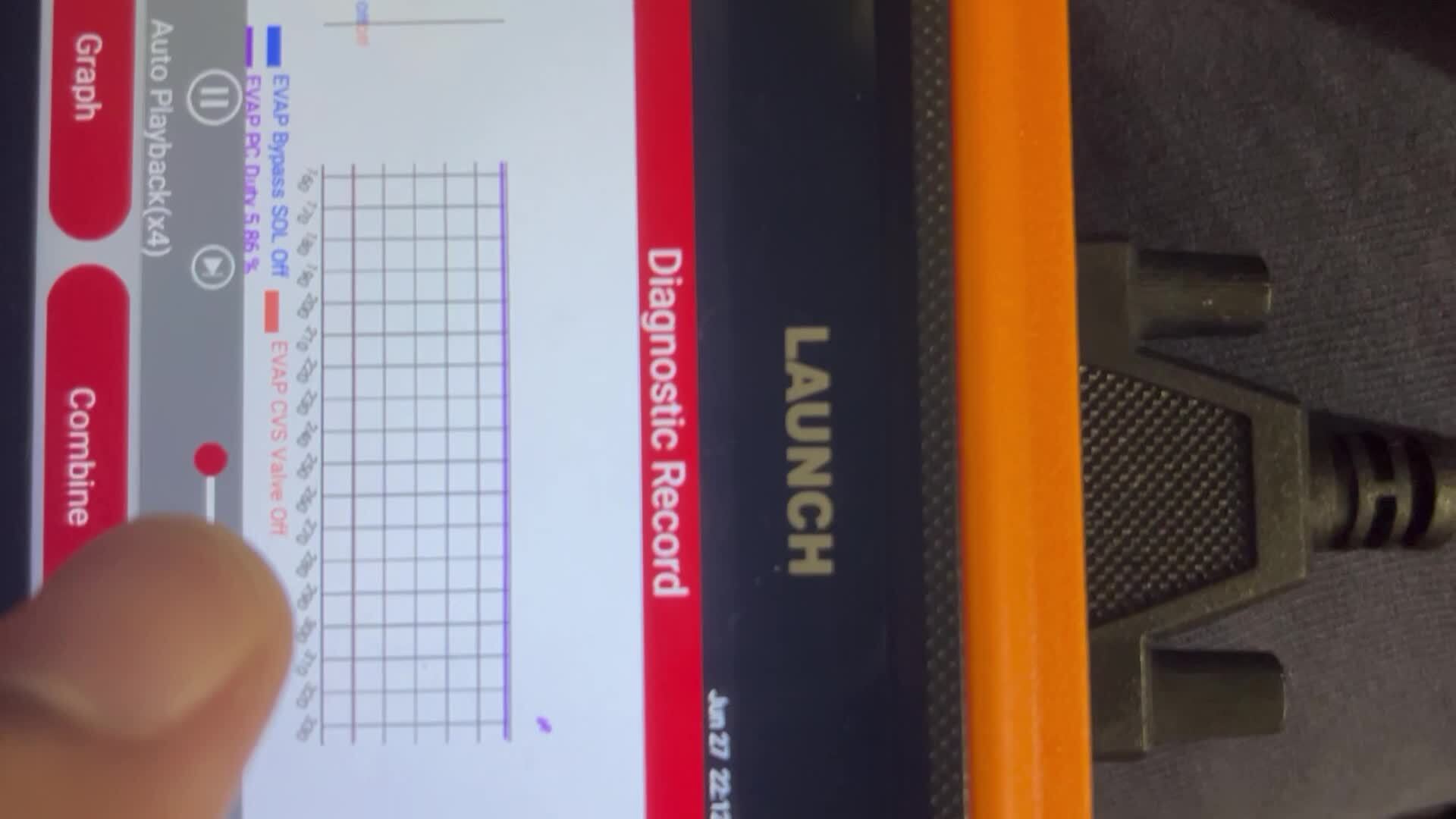

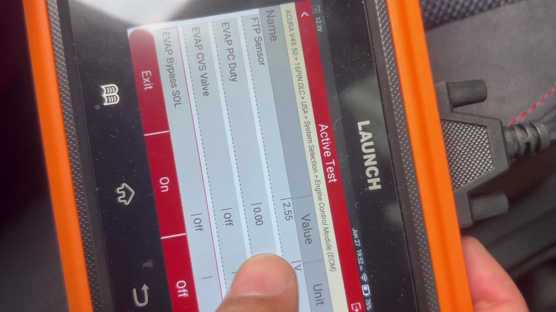

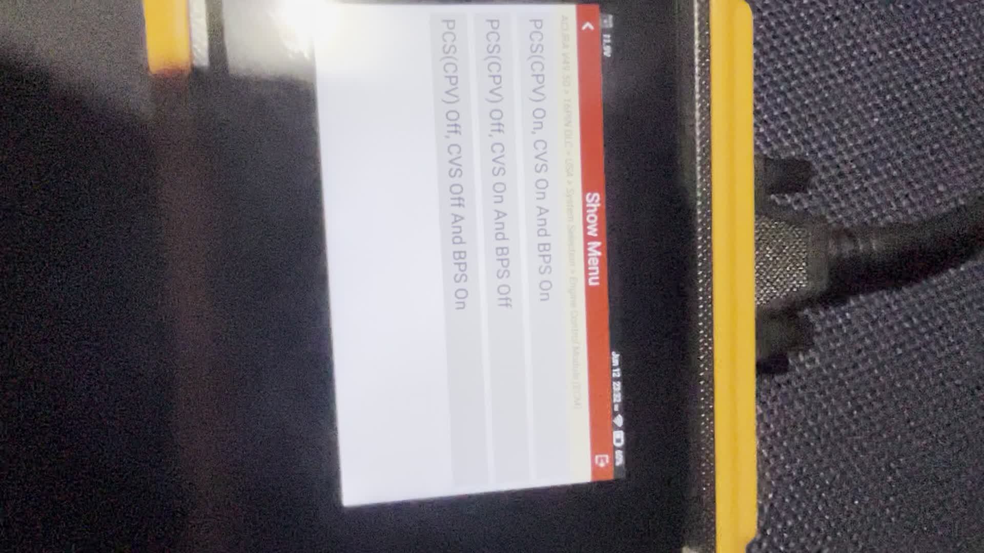

It did detect the P1457, and also let me do the active solenoid tests. I attached a video but here is what happened for each test:
1. PCS(CPV) On, CVS On And BPS On - FTP Sensor value fluctuated. It almost filled like the engine was bogging down while all were engaged.
2. PCS(CPV) Off, CVS On And BPS Off - FTP Sensor fluctuated slightly. No noticeable difference in idling.
3. PCS(CPV) Off, CVS Off And BPS On - FTP Sensor stayed steady. No noticeable difference in idling
I’m uncertain what the other metrics meant, but the check engine light has not fully come back on.
Thanks for your continued help!
Jun 12, 2025 at 3:33 PM
Well looking at the video and the tests I would say the issue isn't the purge or vent solenoids or the canister. However, there are other parts that you can't really use a scan tool to test. Like the fuel filler neck, the pump and the lines. That first test showed that the purge will open and pull a vacuum (that is why the voltage dropped on the FTP) It also showed that your vent solenoid seems to work. The bogging was the very rich fuel mix being pulled through the purge system. The last test will normally only show anything if you wait a while as it should show the FTP rising from the fuel in the tank warming up. I believe the solenoids and valves are not the issue. That leaves things like a small leak around the fuel pump, a small leak in something like the filler neck or vent line. Testing those would need a smoke machine and a quite place to work with no breeze. There are a few of them you can build out of a paint can and a BBQ regulator if you want to DIY. You don't get the fancy features, but they do work. The hard part is usually finding the tiny leak.

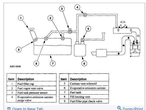

You want it on the line that goes back to the tank and other parts. That will allow for smoke to fill all the lines and the tank and filler neck. One thing I have done is add a few drops of UV dye into the mineral oil. Then use a bright light and a UV light to see if you can find the leak. It can take a bit. Another trick you can do to help is to look for smoke on every line, fitting and all around the tank. If you can set the last test in the video that would close the tank vent so you shouldn't see smoke there. Then get a bottle of bubble fluid (the stuff in the dollar store that you wave to create bubbles) Mix it 50-50 with water and put it in a small spray bottle. You can spray that on suspect areas and see if you see bubbles. The .5 psi is enough to create bubbles if there is any leak.

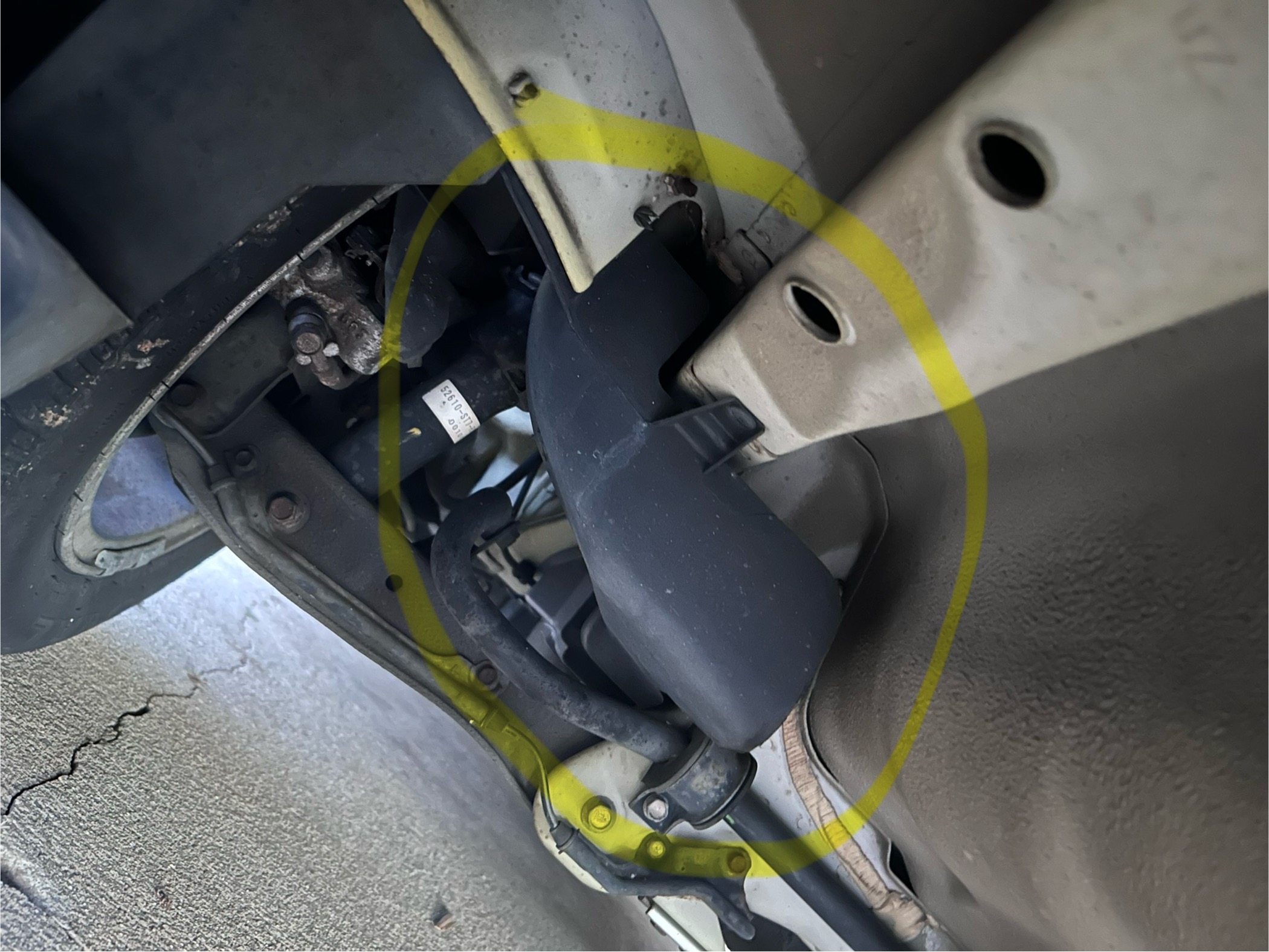

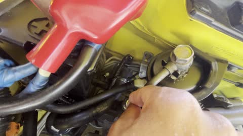

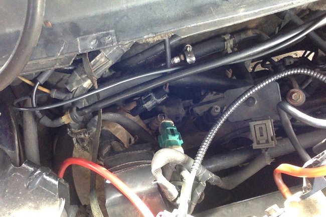

I was able to do a smoke test and saw a bit of smoke leaking from around the top of the charcoal canister, but both had been replaced previously. Could this be masking the actual leak somewhere else? Or could it be some type of seal issue design flaw where the two parts meet? Does the car need to be on?
Jun 20, 2025 at 10:00 AM
Check the connection itself for cracks. If you want to see the smoke better use a bright hand light with the lights off. That usually lets you track the smoke easier. A way to drop the pressure would be to open the machine and connect a BBQ regulator in the airline. That would drop it to a half of a PSI.

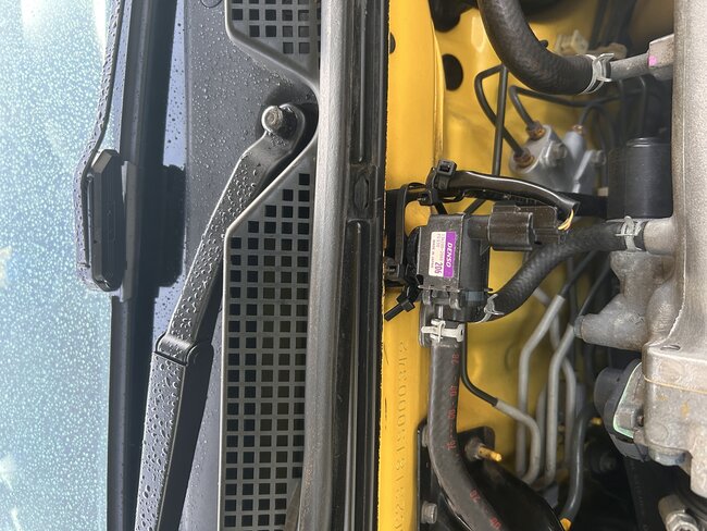

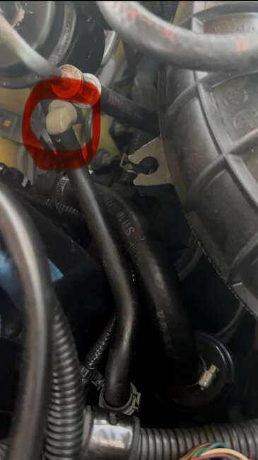

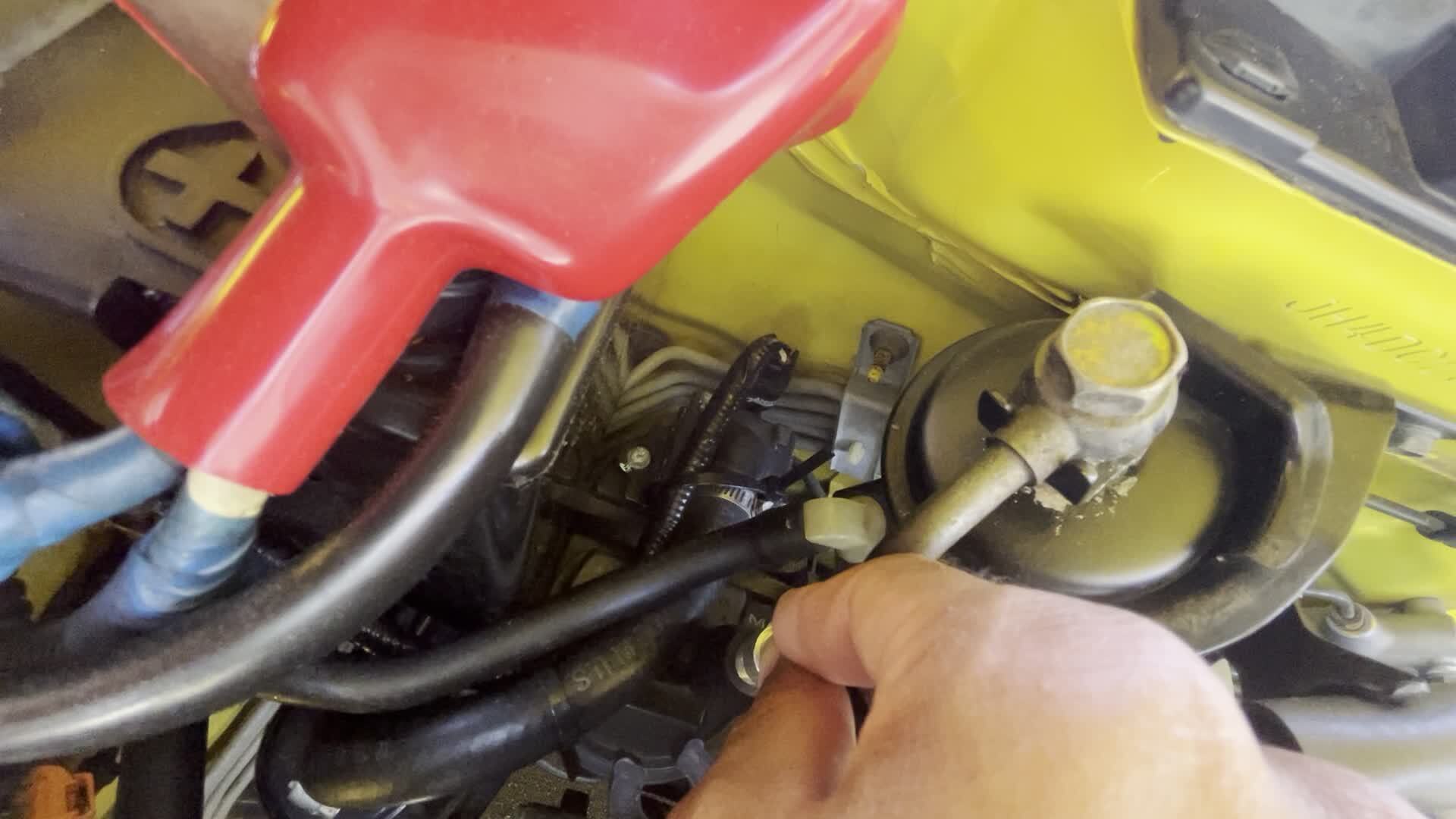

I will be picking up the regulator this weekend, but I was able to do another short test.
I found that where the smoke was coming from is a vent tube meant to be open to the atmosphere. I plugged it during the duration of the smoke test (about 30 seconds) and saw no smoke anywhere from the canister area

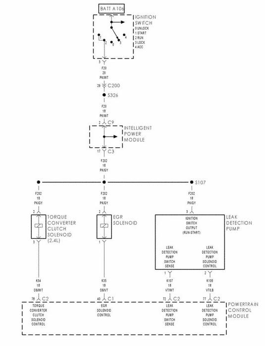

That tube is likely the canister vent. Your scan tool should be able to close the valve it has for that. If you turn it "off" so the vent is closed and still gets smoke out of it, the valve is bad. It may turn on and off, but it isn't sealing.
Jun 27, 2025 at 8:42 AM

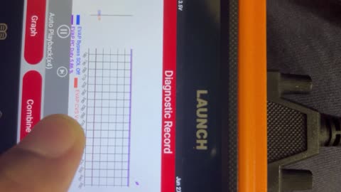

I didn’t see any smoke when I ran with the ignition on and everything set to off. I also did a test drive for 30 minutes after the light came on while monitoring the solenoids. They stayed “off” the whole time. Is that normal?
Also, i noticed i didn’t hear a click when cutting the evap bypass solenoid on and off but did with the evap pc and cvs valve. Is that also normal?

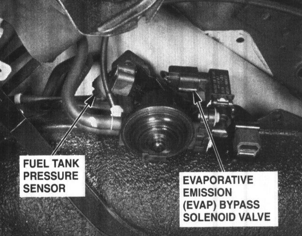

The EVAP normally operates under specific engine loads and temperatures. You don't want the purge open at idle or conditions where the extra fuel would cause problems. I would think you could hear the valve, but it depends on how it's damped internally. I also found this in the Honda section. You replaced the unit, but it might have damaged the PCM driver as well. That may be why you don't hear it, the driver is fried, and it isn't operating.
03-001
January 28, 2003
Applies To:
MIL Comes On With DTC P1457: EVAP Bypass Solenoid Valve Failure
SYMPTOM
The MIL is on, and DTC P1457 [leak detected in EVAP control system (EVAP control canister system)] is set.
PROBABLE CAUSE
The EVAP bypass solenoid valve can fail due to corrosion. The solenoid valve may get water inside. If the water contains road salt, the solenoid windings could corrode, causing the valve to fail. In a few rare instances, the corrosion could be severe enough to cause an internal short in the solenoid valve, which could damage the ECM/PCM. If this happens, both the bypass solenoid valve and the ECM/PCM would need to be replaced.
CORRECTIVE ACTION
Test and, if necessary, replace the EVAP bypass solenoid valve. Replace the ECM/PCM if needed.

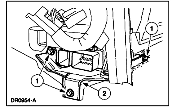

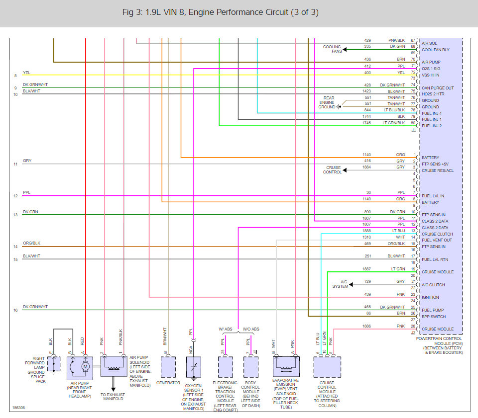

Jun 27, 2025 at 5:54 PM

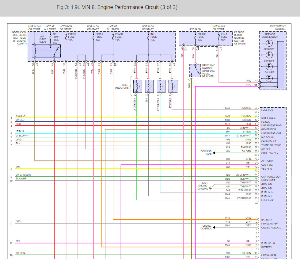

Wow, thanks for this information! Would it be possible to confirm its damage and repair this driver on my own instead of having to replace the entire PCM? Like open it and fix the faulty section?
I suspect I may have shorted it on both my PCMs because I didn’t immediately replace the part itself until recently.
Jun 28, 2025 at 8:31 AM
I found this forum discussing transistors. Is this related to this type of issue? https://www.typerclub.org/forums/viewtopic.php?t=1309
Jun 28, 2025 at 8:47 AM
Yes it would be a driver transistor like that. You could probably repair it if you are good at board level repairs.
Jun 28, 2025 at 11:30 AM
Perfect! Thanks for the insight; I think we may be getting closer to a solution!

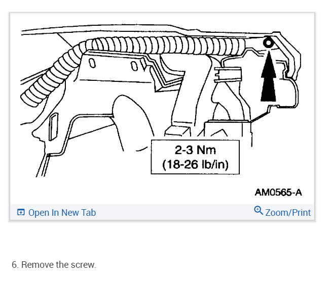

Do you think a pc technician may be able to handle soldering a new transistor in place? Or should I find an auto shop? Would anything special need to be done to it after the repair?
Also, are there instructions on how to remove the PCM?
Jun 28, 2025 at 2:18 PM
If you want it tested and repaired I would use someone who has the tools for those repairs. There are a few. Maic Salazar https://www.maicsalazardiagnostics.com/ is one who might not have a backlog. Give him a call and see what he says. He has a YouTube channel showing his work. PCM=ECM behind the right kick panel.
