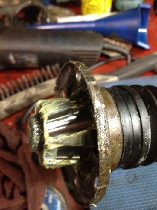

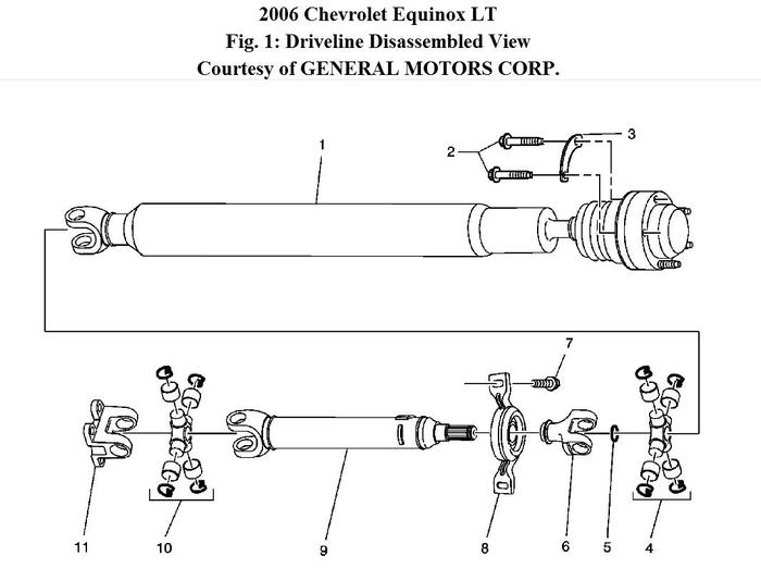

Drive shaft removal?
no just one in front and one in back unless it is posi-traction.
The bolts? We do not have that information the dealer will.

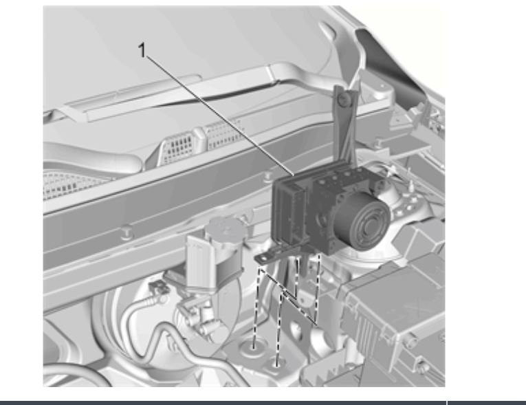

Both front ones rotate. Nothing on the rear ones. They just sit still. Even when I hit the gas. And the ABS and traction control lights came on. After lowering the car these lights stayed off. Any ideas?
Sep 19, 2020 at 10:54 AM
(Merged)
Ii may have messed up the readings on the ABS once that light goes off so does traction control and all wheel drive. have a mechanic scan for codes if no problem then he can clear the codes.
(Merged)
I have a code scanner. No codes are thrown. ?
(Merged)

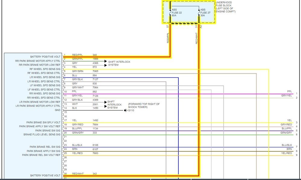

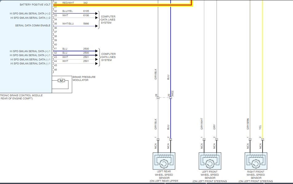

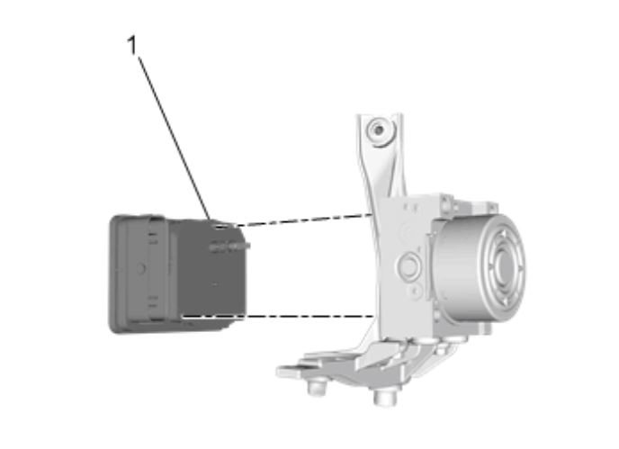

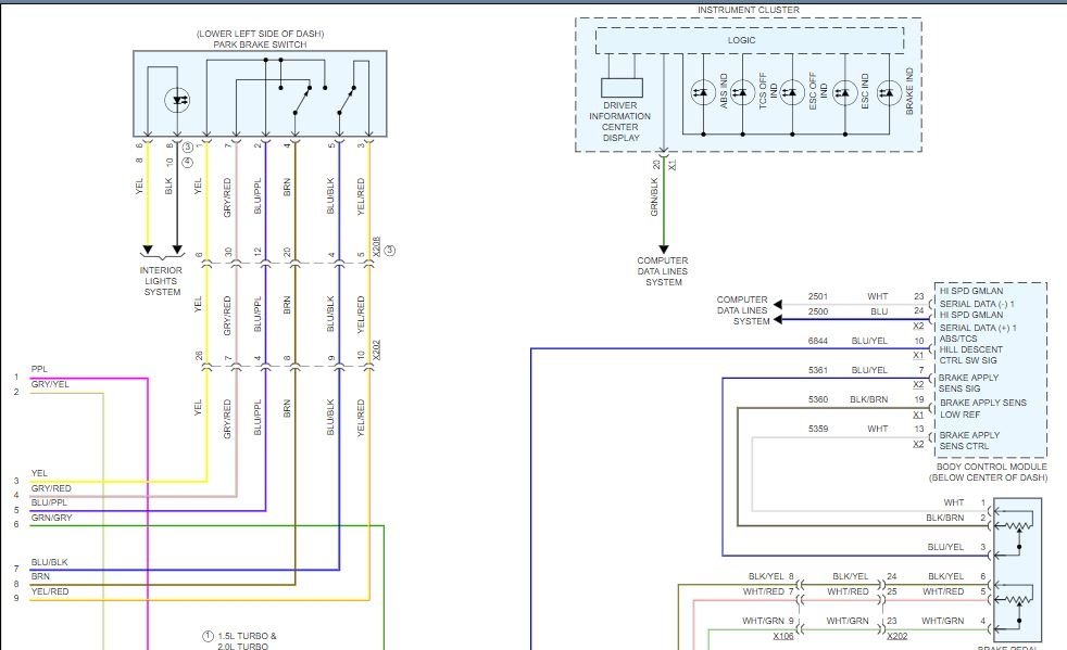

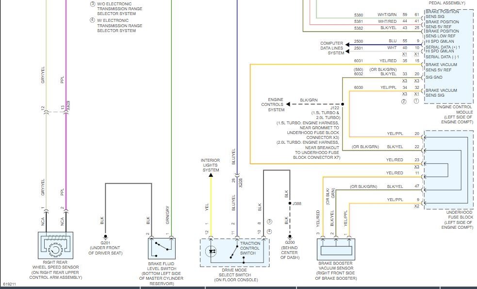

Good afternoon,
If the lights are still on, check the fuses to the module.
I attached the diagrams for you of the system as well as the location of the module.
The module may have failed. If it did, it should be a warranty item due to the age of the car.

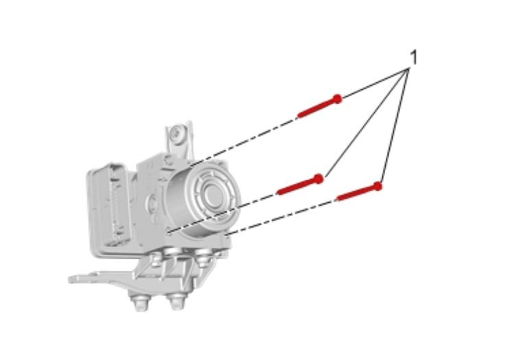

Removal Procedure
Warning: Refer to Brake Fluid Irritant Warning.
Caution: Refer to Brake Fluid Effects on Paint and Electrical Components Caution.
Caution: Always connect or disconnect the wiring harness connector from the EBCM/EBTCM with the ignition switch in the OFF position. Failure to observe this precaution could result in damage to the EBCM/EBTCM.
Place the ignition switch in the OFF position.
Electronic Brake Control Module with Brake Pressure Modulator Valve (1) » Remove — Electronic Brake Control Module with Brake Pressure Modulator Valve Replacement
Open In New TabZoom/Print
Electronic Brake Control Module Bolt (1) » Remove [3x]
Electronic Brake Control Module (1) » Remove
