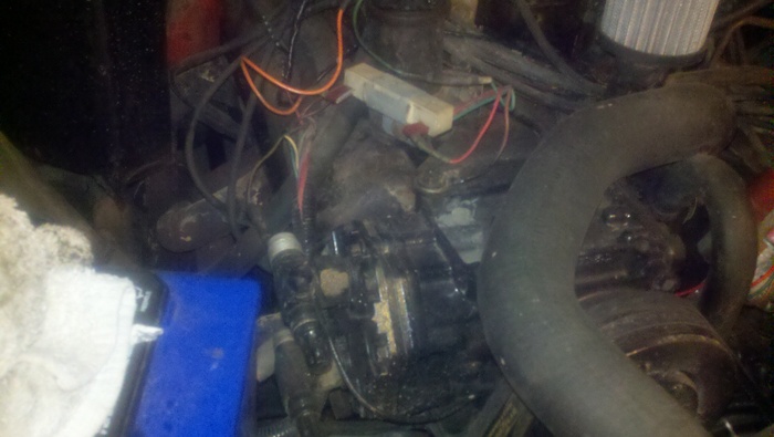

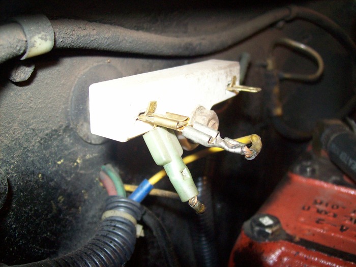

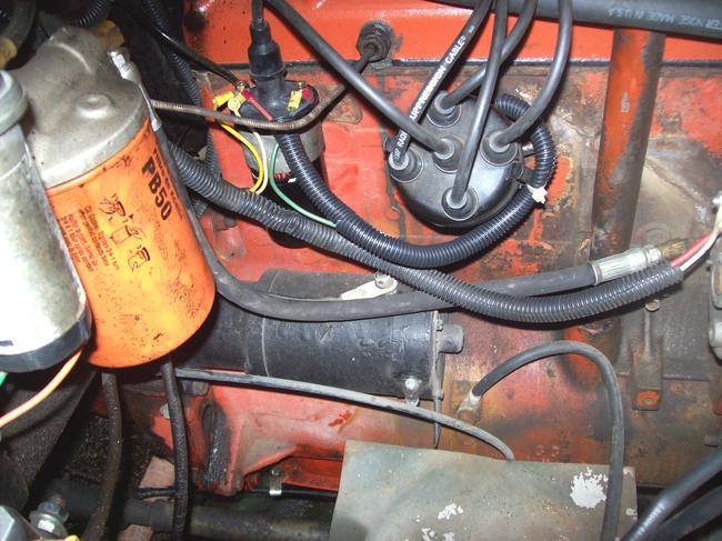

I have a 232 six, Prestolite ignition system. I have changed the distributor, cap, rotor,plug wires, ignition module, spark plugs, it still runs poorly at speed, but does okay if I keep the rpm down. I noticed when I grabbed the with wire going from the module to the distributor it would start missing and shut off? I changed the wire out and tested it again, if I grasp the wire or allow it to touch ground any were along its length it will start missing back fire and shut off.

You may have a broken or almost broken wire to the module or distributor.

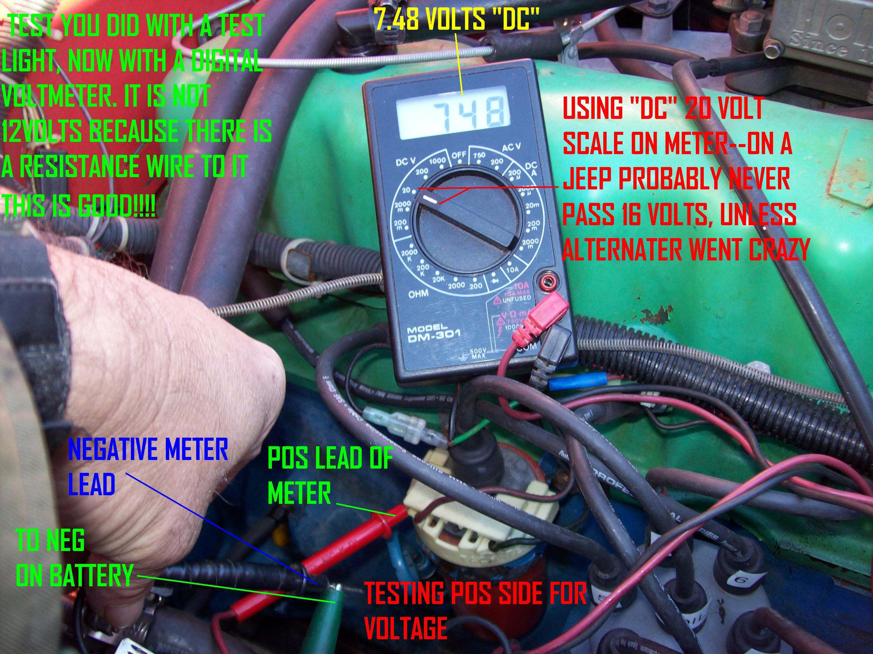

Do you have a voltmeter, can you check DC voltage with it?

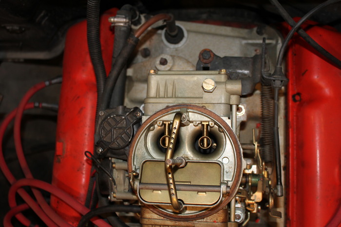

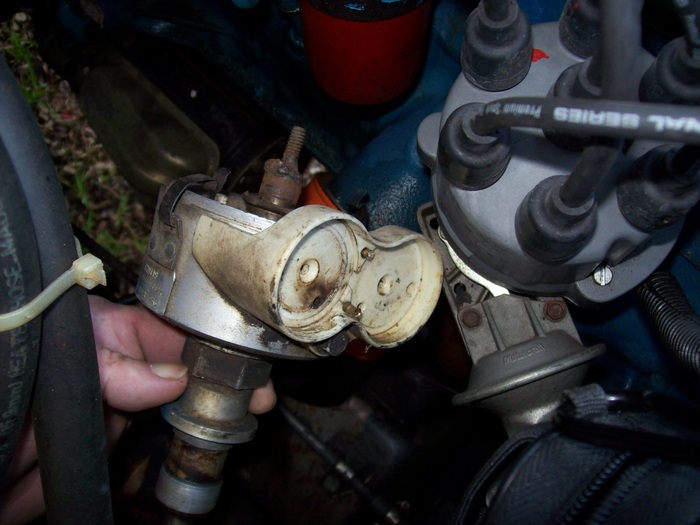

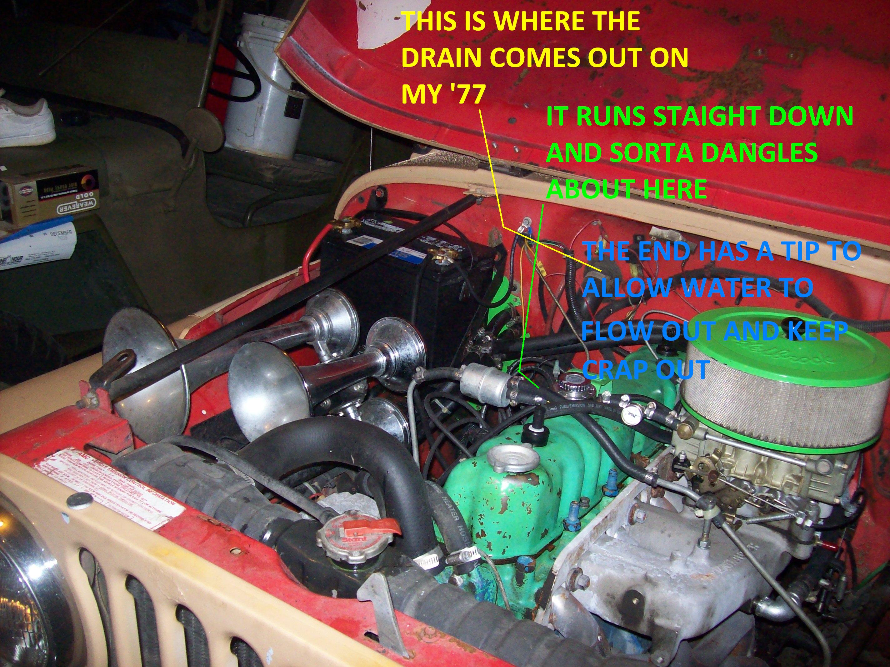

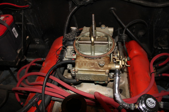

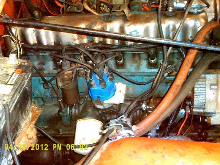

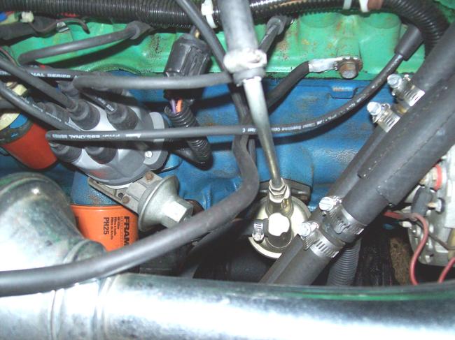

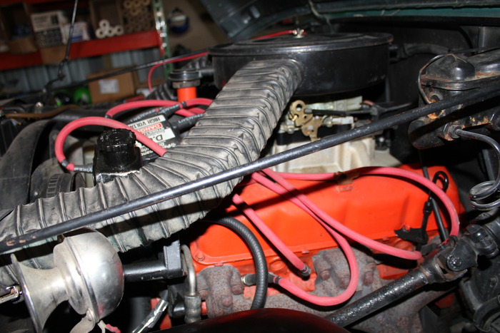

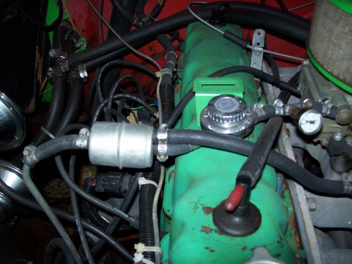

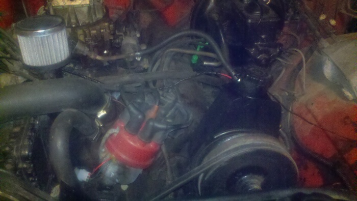

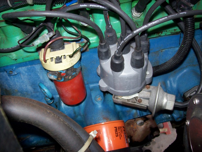

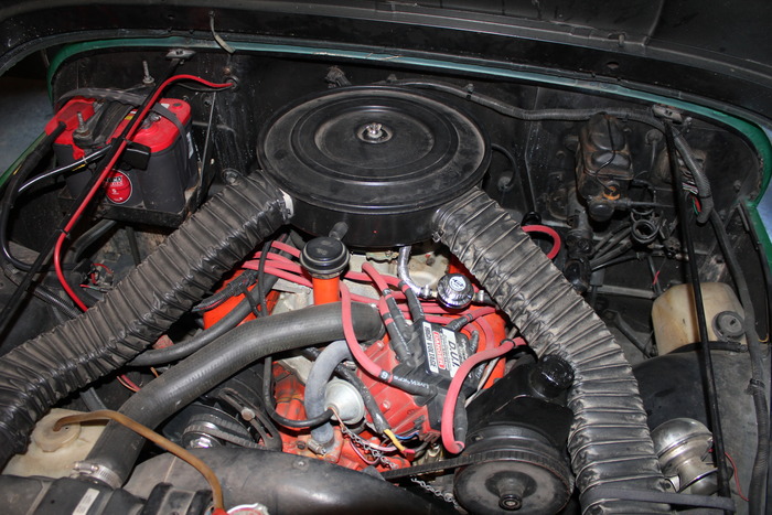

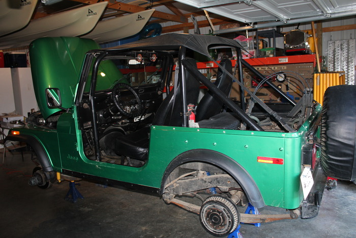

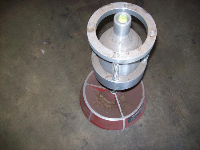

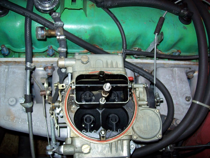

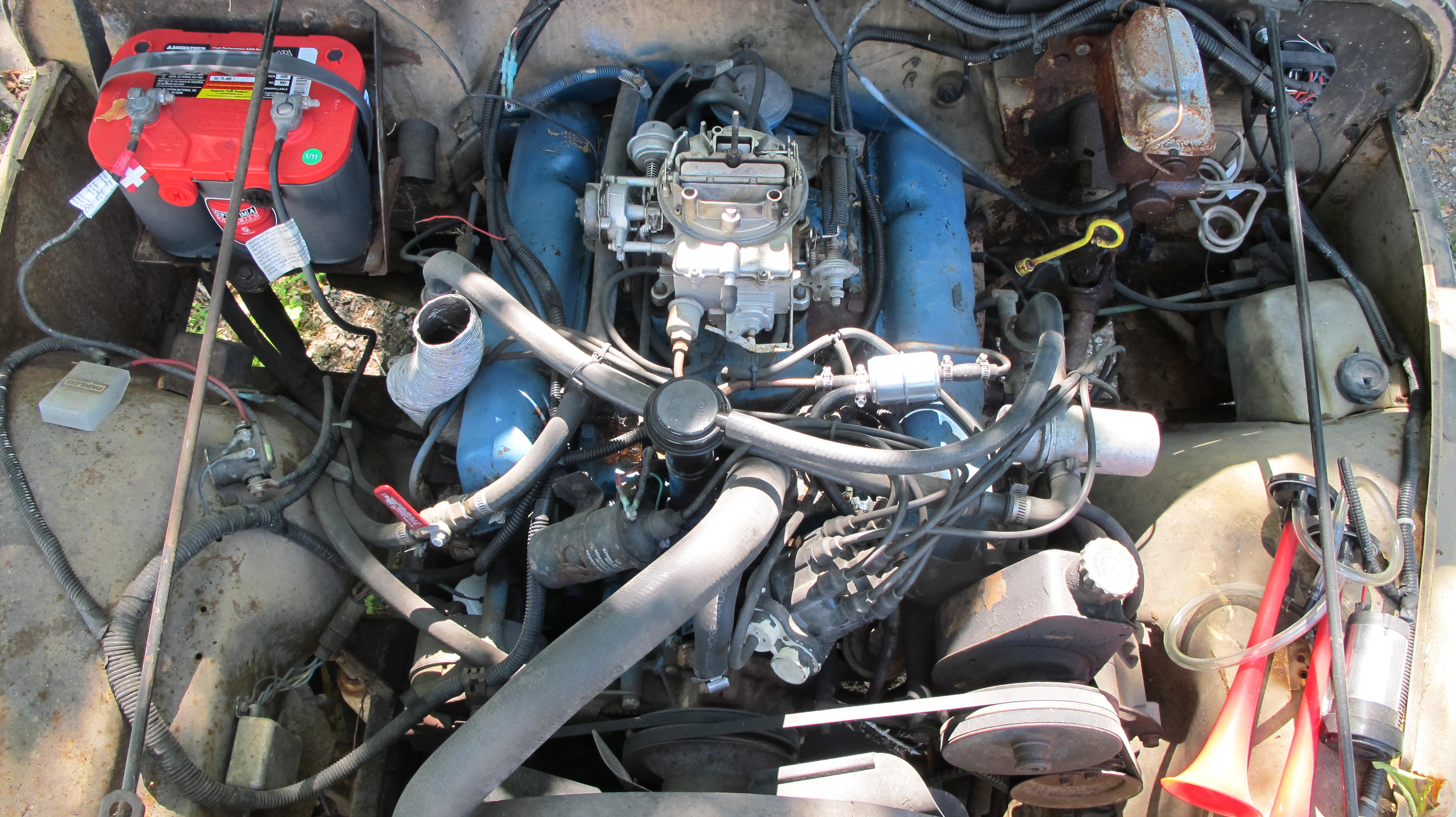

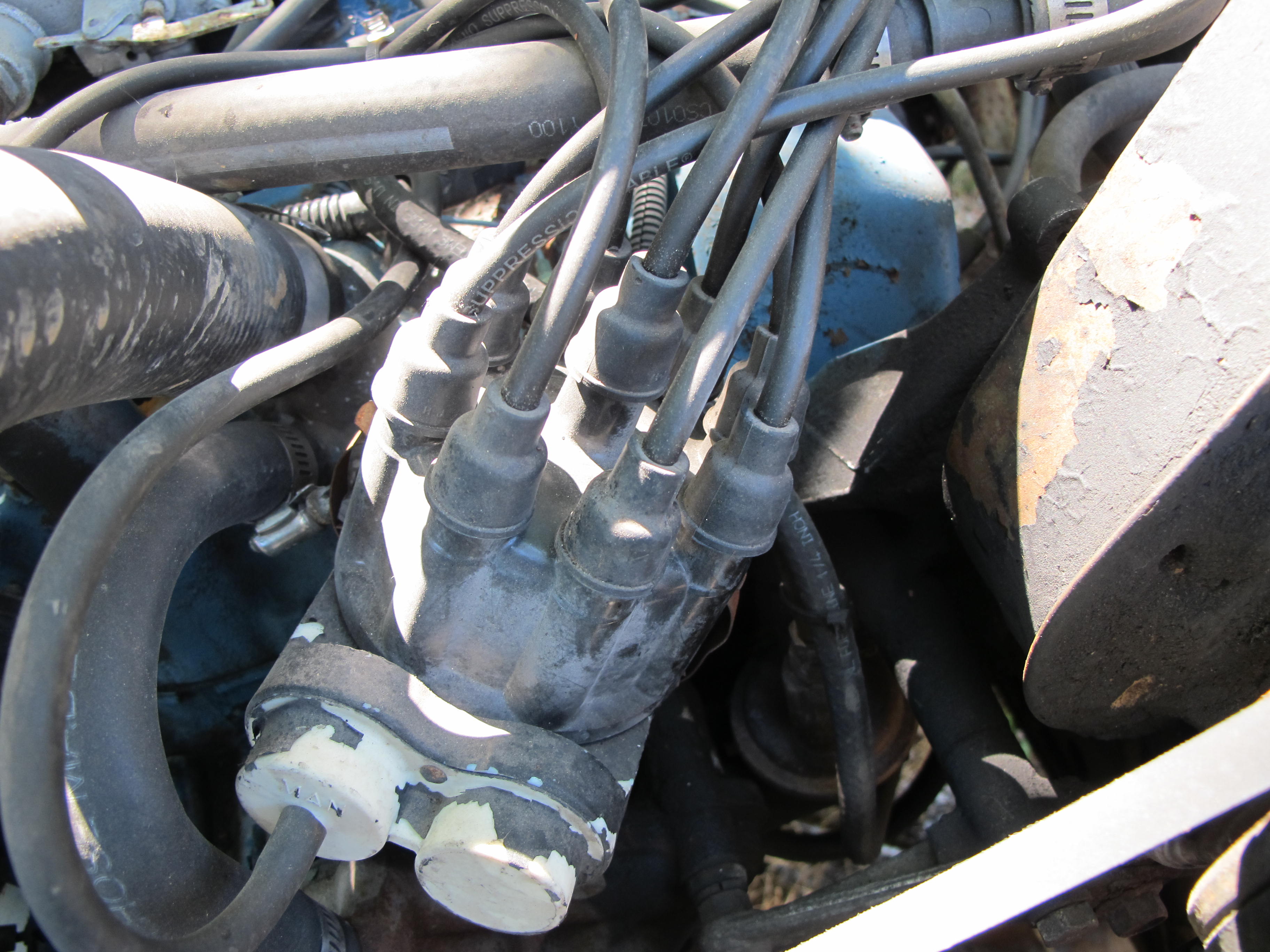

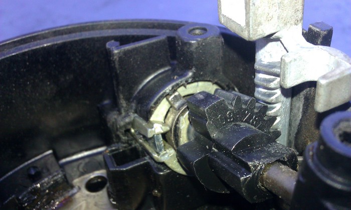

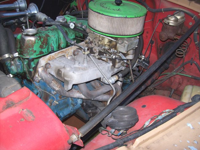

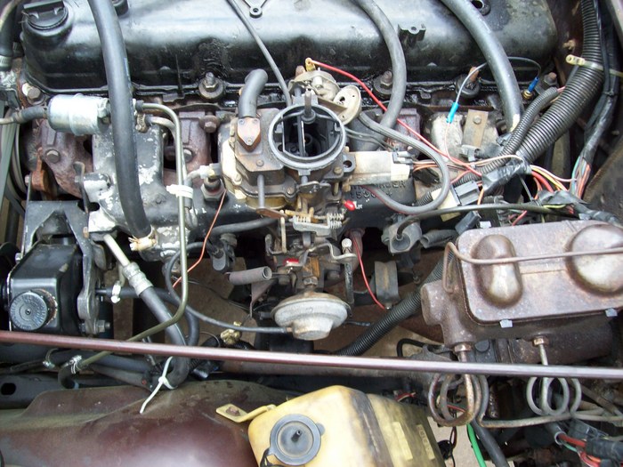

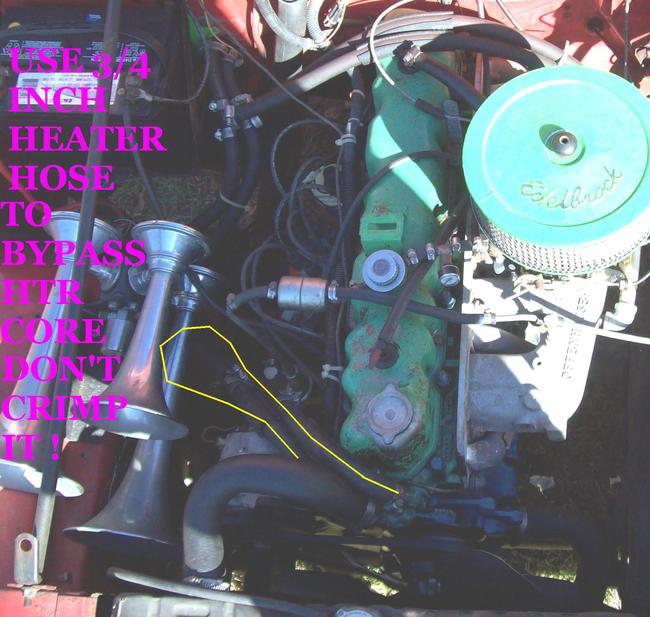

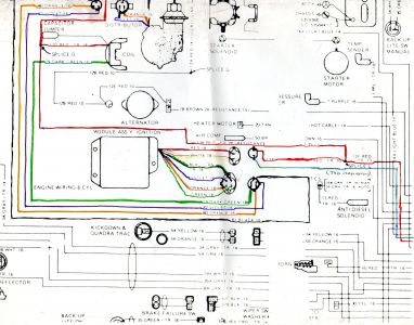

Below is my old Presto distributor, now modified into a oil primer for rebuilt engines. You will see my upgrade to Motorcraft, ignition (1979 Jeep), my four bbl intake and carburetor other good stuff.

Thanks for your offer, I was really wanting to figure this out? I have changed all the wires and such just to find out my alt was putting out 21 volts ac? I changed it and now it seems fine, I am going to up grade to a Chevrolet style distributor with the coil in the cap though, there only $150.00 and I have always liked them.

The problem with Prestolite is the wires are little "solid" copper wires going into the distributor, no matter how well you tie them up and support them they vibrate and break.Living example now typing to you! Motorcraft uses stranded wire, I think it is 18 gauge.
The other problem it has is the darn "Bellows" contained in the white plastic (this is how the advance operates) will also split/ break/ get a hole in it. No timing advance and vacuum leak all in one shot. You will not know it until, you experiment with your timing gun, and see it does not advance!
Modules seem to go bad more often too.

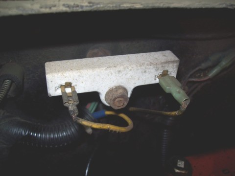

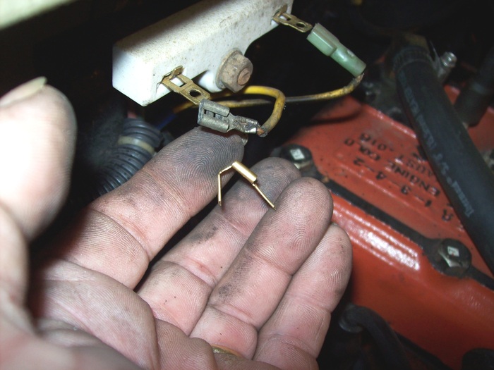

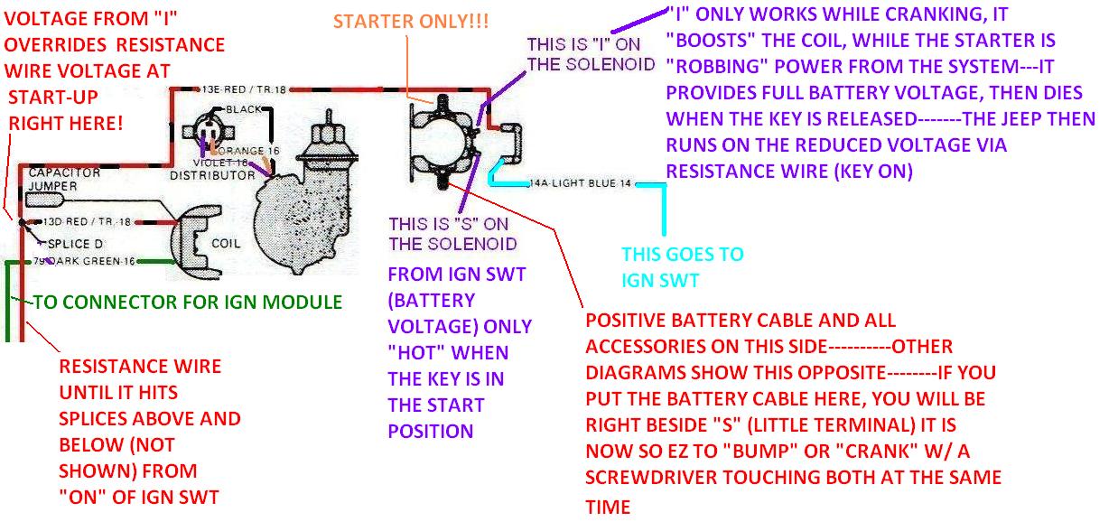

The problem with the "one wire" distributors is it will not work with the "resistance wire" (normally feeding the coil) from the ignition switch--Full 12 volts must feed the new , and you must tie in a regular wire in behind the "splice" where the resistance sire, comes into being (basically replace or make a "twin", for the "RW" out of regular old wire to be the new "key feed".
You are really not gonna gain much, just because you are wanting to use the "in thing" A "high speed, low drag" aftermarket coil on the Motorcraft system, will be super, and you will see no giant leaps in performance, which ever way you go.

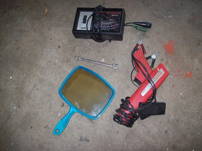

As for tuning stuff you will need (mainly to set idle speed and get timing back to specs this kit is available at "Harbor Freight" for less than $40.00.
