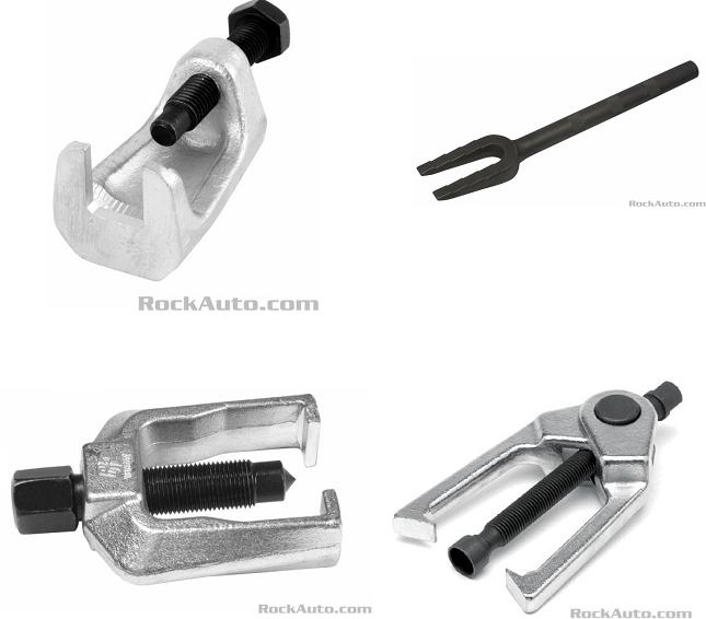

The first step for removal is to remove the nut, then break the connection between the tapered stud and the hole in the spindle. The new joint should come with a new nut. If it does, the old one can be discarded, so to make the job easier, you can use it to shear off the old cotter pin. Those cotter pins usually get impacted with dirt and rust, and they'll break if you pull too hard on them. Just shear 'em off since all those parts are going to be discarded anyway.
There are tools made for pushing on the end of the stud, but professionals rarely need to resort to using them. The best way to get the stud loose is to use a large hammer and pound on the spindle, just to the side of the stud. Those spindles are much too hard for you to worry about deforming them, but the shock will loosen the stud. Be ready with a means of support under the control arm as the spring is going to slap it down with a lot of force. A small floor jack is preferred because you'll need it later to raise it back up to insert the new stud. On many models you'll need to loosen the wheel bearings so the rotor can be moved out of the way, and on some models the outer-most lip of the control arm will catch on the brake dust shield. This especially must be avoided on Ford products because their dust shields are plastic and will shatter.

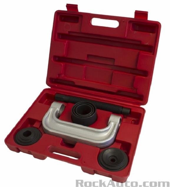

You're going to need a ball joint press for this type of lower joint. It is nothing more than a really beefy c-clamp with a selection of discs and cones. You can buy this tool at Harbor Freight Tools or any auto parts store, and very likely you can borrow it from an auto parts store that rents or borrows tools. In my city, they charge you for the tool, then you get a full refund when you take it back. If you decide to keep a tool, you still return that used one, then they order or give you a brand new one.
The second photo shows the most common version of this tool. Other, more-expensive sets have a larger variety of cones and discs for special applications. To press the old joint out, select the cone that just fits over the lower lip of the joint, as shown by the two pink dashed lines. This cone pushes against the lower control arm, and the joint slides through it as it comes out. The disc in the lower right corner of the red case sits on the bottom of the cone and has a matching step to keep it centered. The pushing screw pushes against this disc.
The other end of the c-clamp pulls on the disc shown in the lower left corner of the case. That disc has a hole in the center large enough for the ball joint's stud to pass through. That lets the disc rest on the housing of the joint and put pressure on it. It will be less-cumbersome if you can pry the dust boot off to get it out of the way, but if that is too difficult, just drop the disc over it and let it crush the boot. The disc will be sitting on the joint's housing where the two blue arrows are pointing. As you tighten the clamp, the joint will be pushed out, and it will drop into the cone.
The same discs are used to press the new joint in, but you'll likely need a different-size cone, and it goes on top now, to make room for the housing to be pulled in. The disc with the small hole goes on the bottom, as before, but with no cone. That disc has two sides, and you must choose the side that makes contact with the housing at its outer lip, as shown with the green arrow. It must not push on the raised area shown with the red arrow. Pushing there will deform the gold plate in the center of the housing. That plate is what holds the spring and / or nylon insert that holds pressure on the ball. If that plate becomes bent or bulged outward, the joint must be replaced. Most of the time hitting that ridge can't be avoided, then you'll need to insert one of the other cones between the disc and the joint. One of the cones will fit right around the bulge and push on the lip, (green arrow).

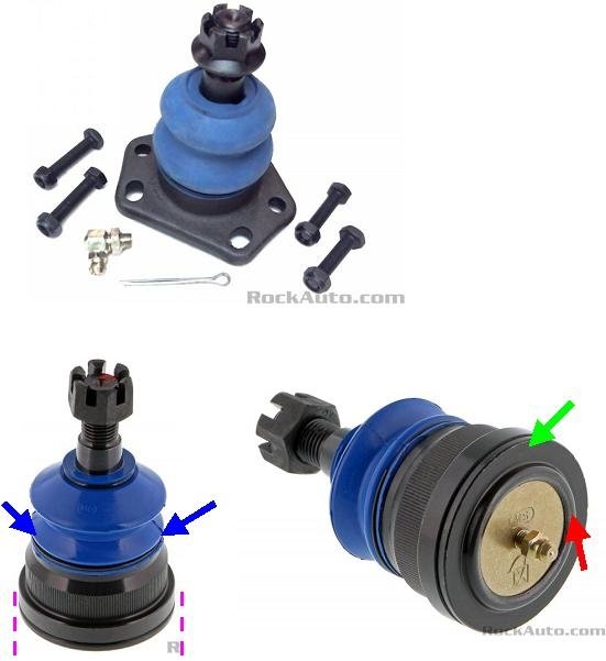

Upper Ball Joint
In this application, the upper ball joint is the "follower" joint, also called the "non-load-carrying" joint. It doesn't hold up any vehicle weight. It's only job is to hold the spindle upright, in perfect alignment. The smaller S10 / Blazer model is well-known for eating upper ball joints, often needing replacements every two years. As such, you can expect these have been replaced before, so you're going to find they are bolted onto the upper control arms with four nuts and bolts each. That will make removal a lot easier. The nuts that come with the replacements are lock nuts, and you may find they are so tight, the bolts are likely to snap. Be sure to use a good-quality six-point socket on the nut and the bolt head. Cheap tools are likely to round off the nuts, then the job becomes more difficult. If the nuts do unscrew, toss those bolts aside and use the new ones that come with the new joint. The old ones were stressed, and now the nuts could be more likely to work loose, or the threads could peel before you reach the torque spec. You may not find a torque spec for these in the service manual because nuts and bolts were not what GM used at the factory. There will be an instruction sheet that comes with the new joint. That will list the specified torque value for those nuts. In the absence of any written torque spec, common sense applies. These are not hardened bolts, and they don't have to withstand a lot of force. Hand-tightening with a 3/8"-drive ratchet is sufficient.
The castle nut on the stud does have a critical torque spec. That is needed to insure the stud is pulled into the tapered hole in the spindle with enough force to wedge it tight. Any time you find a stud that has popped out and is loose and wobbling around, both that ball joint and the spindle must be replaced. The hole and stud will be worn oblong to where they no longer have matching tapers. The new stud will not be supported squarely in the spindle, and if you're lucky, it will just continue to work loose. If you aren't lucky, which is more likely, the stud will snap and lead to loss of control and a crash. It snaps because it is only supported at the very end near the threads. Being of smaller diameter, that area is weaker and is not designed to withstand sideways forces. Because of the deformed hole, the stronger larger part of the stud is not resting against the spindle, so a hard shock can break it right under the threaded area.
The original upper ball joints were riveted to the control arms. Those can be very time-consuming to remove. A standard air hammer with a chisel bit won't do it. At one shop I worked at, they had a much larger air hammer that used larger-than-normal bits, but it was even a struggle with that one. You definitely needed hearing protection. Also, that hammering caused the stem of the rivet to bend and deform, making it even harder to punch them out with the air hammer. While it may take longer, it is easier to grind the heads off with an angle grinder, and then use a standard air hammer to drive the rivets out. You'll want to stick a piece of wood, or some type of block, under the control arm to prevent it from bouncing up and down as you try to punch the rivets out.

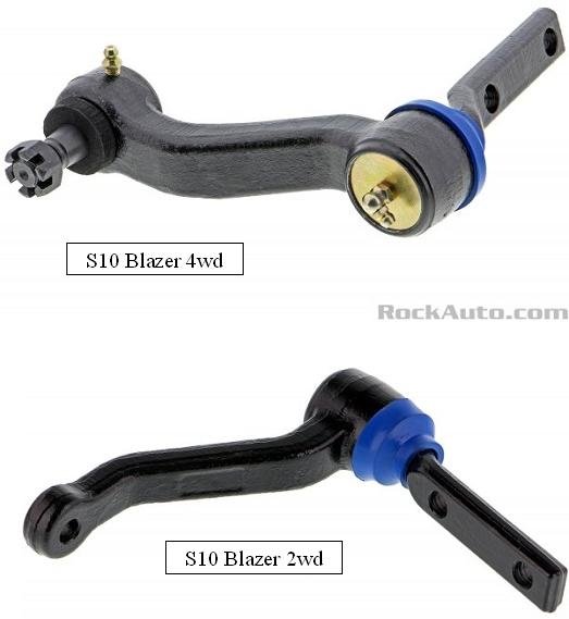

Idler Arm
These are another part with a high failure rate on GM products. They don't come apart, but they develop looseness in the swivel, and that allows that end of the center link to move up and down. In fact, that is how these are checked during an inspection. I'm sure there is a spec given for how much movement is allowable, but for most of us, that is "none". When you have the vehicle on a drive-on alignment hoist with the front tires resting on turntables, when you move the idler arm up and down, you'll see the right front wheel turn left and right a little. Any visible turning movement is way too much to keep "total toe" in specs. Total toe always affects tire wear on both tires, regardless of which tire is not staying in alignment. This sets up a choppy, or "featheredge" pattern on both tires. When you run your fingertips over the tread, you'll feel it is fairly smooth one way, then you'll feel those raised sharp edges the other way. When this wear is bad enough, you'll have excessive steering wander too.

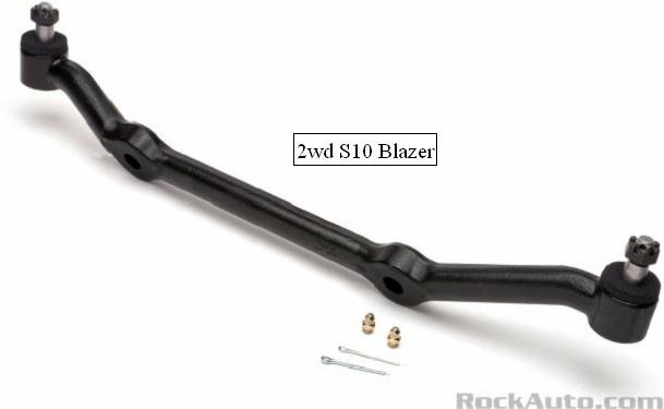

One often overlooked characteristic of center links is they must be perfectly parallel to the ground to avoid the vehicle darting off to one side when hitting small bumps in the road. Most often that causes a miserable failure to track straight down the road, and a somewhat tiring vehicle to drive. To add to the misery, there is some play in the two mounting holes in the frame for the idler arm. Before the two bolts are fully tightened, the arm can be moved up or down a little. A good habit to get into is to find a point on the ground or hoist to measure to, measure to a point on the end of the arm, then set the new idler arm to the same dimension when you tighten the bolts. Most people overlook this step, and they usually get away with it, but this, along with many other little things like this, are what keeps the vehicle handling like when it was new.
If you're replacing all the tie rod ends and center link, you don't have to separate all of them from each other. When you do need to disconnect a tie rod end, or when removing the center link requires separating a tapered stud that has to be reused, you'll want to look at the tools in the third photo. The top right one shows a "pickle fork" that is struck with a hammer repeatedly until the tapered stud pops out. This tool almost always destroys the rubber dust boot. The other tools are quieter and gentler, and are preferred, if you have them.
As with the ball joint studs, you never want to reuse any part with a tapered hole that had a loose stud in it. You won't find that very often, but if you ever do, both mating parts must be replaced.

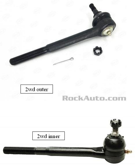

Tie Rod Ends and Adjuster Sleeves
Adjuster sleeves do not have to be replaced unless they're bent, but when replacing both tie rod ends, most professionals will use a new sleeve because their very low cost is less than the added cost of labor time to prepare a used one for reuse. When you're replacing just one tie rod end, there are special sockets for use with an impact wrench to make the job go faster. The problem is the pounding is going to be absorbed by the ball and socket in the other tie rod end that isn't being replaced. These joints are physically very small in relation to the forces acting on them, so it's real common to find all four of them have unacceptable looseness when you squeeze them. The pounding from air tools isn't going to help an end that is going to remain in service.
One trick is to loosen the clamp bolt for the end being replaced, then use an air hammer to drive a chisel bit into the sleeve's slot, and expand it. Now remove the tapered stud, and you may find you can unscrew the tie rod end by hand. Even if you do resort to the impact wrench, the stress on the other end will be a lot lower.
If it hasn't occurred to you yet, the threads on one tie rod end are going to have normal threads, and one will have backward threads. When looking at the threads in the sleeve, you are going to be sure you can tell which end has the backward threads, and there's a fifty percent chance you'll be wrong. I've been tricked many times when the tie rod end wouldn't screw into the sleeve. Don't go by looks. Instead, unscrew just one of the ends first, then screw the new one in before you remove the other one. That will eliminate any confusion.
Standard practice is to count the number of revolutions needed to unscrew an end, then run the new one in the same number of turns. In actual practice, that will only get you close. You can't know if an aftermarket manufacturer decided to cast their part a quarter inch longer or shorter, or even if the original one was a standard length. GM may have made the original parts in-house, or they could have bought them from multiple suppliers. The number of turns has no relevance because this link comprised of the sleeve and two tie rod ends is one of the two final "toe" adjustments. Once all the other alignment angles are set, the steering wheel is locked perfectly straight ahead, then these sleeves are turned to adjust their length, thereby adjusting each wheel to also be straight ahead.
If you didn't count the number of turns each tie rod end was screwed into the sleeve, run the new ones in 27 turns. That will get you real close to the final correct length. Also be sure to run both in the same distance. I've never found two tie rod ends to have different thread pitches, but if that were a design variable, it would mean one of them needed to be screwed in more or less turns to get it in the same length as the other one. By having both run in the same amount, it insures one of them won't run out of threads if the sleeve has to be turned a lot to get to the desired toe setting.
It's okay to put a little axle grease on the threads to prevent them from rusting to the point it takes two men and a boy to turn one during a future alignment. I use Spray White Lube to insure the sleeves stay freed up. Never use penetrating oil, especially Chrysler's "Rust Penetrant". That stuff works real well, but it opens up the way for moisture to sneak in after it. That moisture causes the sleeve to rust even tighter months later. Regular grease and oil won't do that. Also never use any type of anti-seize compound on these threads. That stuff is too slippery. The fear is a hard impact could let the threads jump, or even worse, two parts could pull apart.
Once two tie rod ends and the sleeve are assembled, that entire link can be installed either way on most older rear-wheel-drive Chrysler products. From the factory, you don't know if the tie rod end with the normal thread is the inner one or the outer one. The only issue with that is you don't know right away which way to turn the sleeve when you need to adjust toe on that wheel, until you try it. You can't switch them on most older Fords because the inner and outer ends have seriously-different lengths, and they have bends in them for clearance from other parts. The link can also be switched on GM cars and light trucks, but on all of these vehicles it is customary to make the normal-threaded end the outer one. One way to tell the ends apart on GM vehicles is by the location of the grease fittings. One comes out the bottom of the housing and one comes out the end of it. If the entire assembly is turned around, it is possible one of the grease fittings could hit the control arm as it moves left and right. Typically that causes the grease fitting to be knocked off, and nothing more.
No torque spec is listed for the castle nuts on the tie rod ends, so again, rely on common sense. These are smaller nuts than those for the ball joints, so expect their torque spec to be a lot lower. It's irrelevant anyway on most models because the nuts are on the back side of the center link where you can't get a socket on the inner ones, so you can't use a torque wrench without a hard-to-find special adapter. Even getting a box wrench on them can be difficult. Expect these nuts to take around 20 †30 foot †pounds, which is easy to achieve with an open-end wrench, then, as before, tighten them just enough more so you can get the cotter pins in.

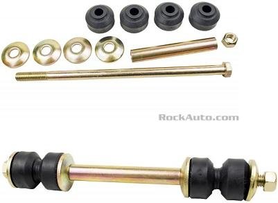

Outer Anti-sway Bar Links
These are of a real common design found on various models from every manufacturer. They fail in two ways. One is when the bolt rusts apart in the middle. Most often that occurs right near the end of the sleeve in the middle of the assembly. The truck body will tip more than usual when cornering at high speeds, and there may be a banging or crunching noise if the two parts hit against each other.
The second failure is when the rubber bushings dry-rot and split apart, then fall off. You'll hear the classic rattling "tambourine" sound when driving over bumpy roads. That's from the washers on the link. Other than slightly reduced cornering comfort, these broken links do not cause a safety hazard. They do not have to be replaced for the truck to be aligned.
Removing the links is harder than it looks. The sleeve is usually rusted to the bolt, but it has to be slid off. Instead, some people use a torch to cut them off. I use an air-powered cutoff tool to cut off the head of the bolt, and then cut through the nut. When you install a new link, the threaded end can go on top or on the bottom, as long as the threaded end doesn't interfere with and hit other parts.
There's two things to be aware of to help this job go better. The first is when you're replacing both outer links, slide in both bolts with their first two washers, two rubber bushings, and sleeve, then the next washer and bushing. I use a rubber band to stop the bolt from sliding out on one side while I assemble the other side. Now swivel the bar up so both bolts go through the other holes, then install the last bushings, washers, and nuts. As an alternative, you might get away with totally assembling one link with the nut just started, then do the other one. The problem is when you fully install one link and tighten the nut, you won't be able to pull the bar far enough to allow the parts to be assembled on the other side. Even two men pulling on the bar will need two boys to help.
The next hint has to do with how far to tighten the nuts. Some people will tighten them as much as possible, but that crushes the bushings so much that they won't be able to flex as the bar moves around. That will reduce the life of the bushings to almost nothing. Proper procedure is to watch the bushings expand as you tighten the nut. Stop tightening it just when the bushings have expanded to the same diameter as the washers, and no more. This will leave them with just the right amount of flexibility and free movement.
