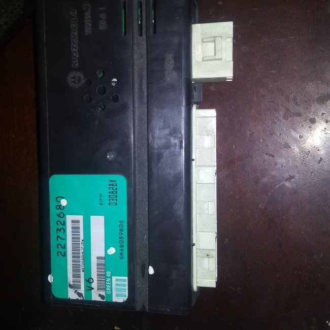

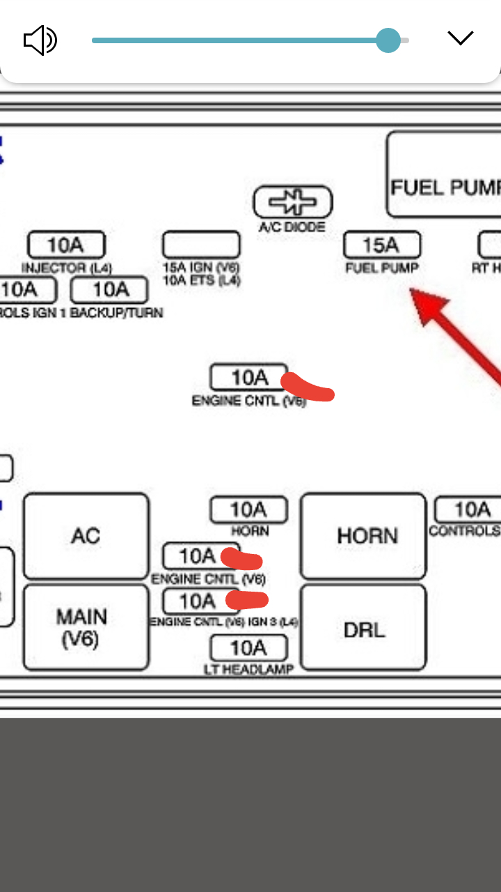

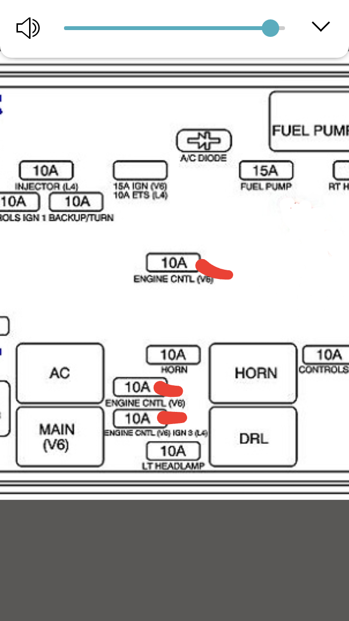

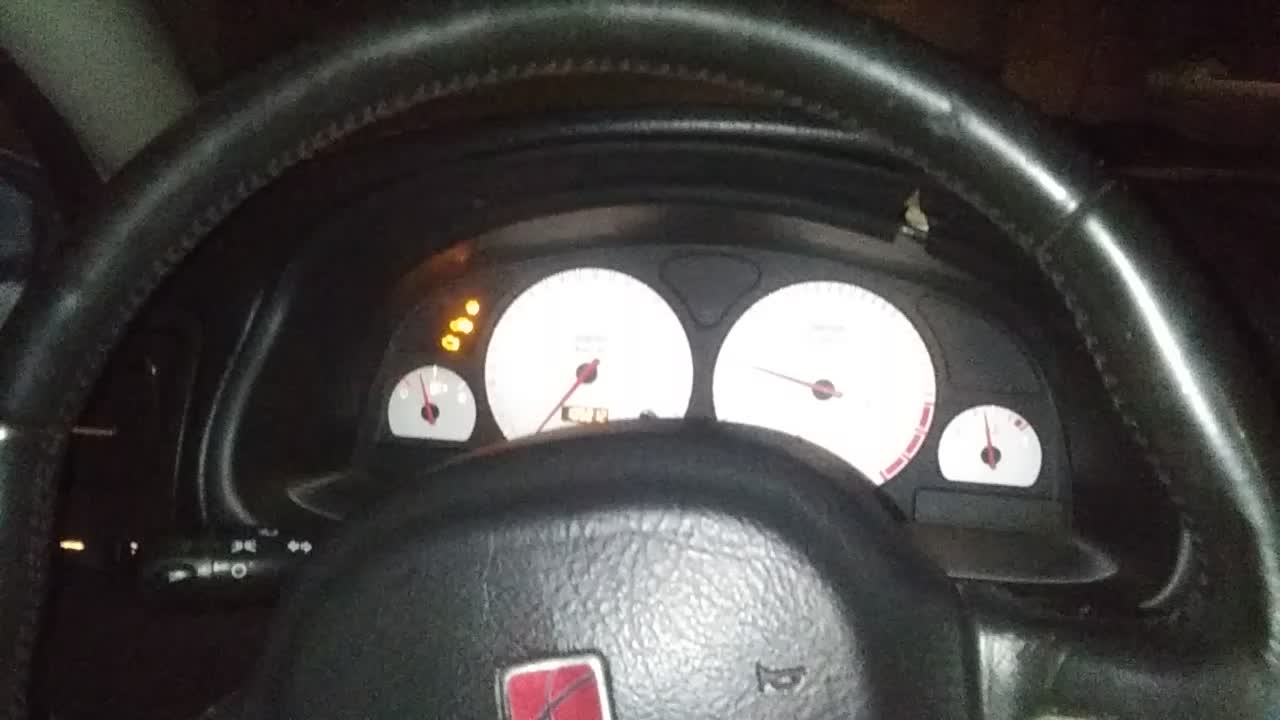

Okay got bad news and good news, sorta. Well i put in BCM and car still didn't start. So i was pretty bummed out. Check all fuses again and same issue. No 12v going to ECM fuses. Hmm. So put old BCM back in and car started. Ran rough as hell but then i got out and looked at engine and gas was squirting out from test valve. Button was stuck in so i shut it down. Now letting gas dry up before i try starting again. So. What the heck happened? Why did it start? I know it's not fixed yet but hoping if i get it to start i can get codes off it and maybe something new will show up.

It sounds like it could be the ignition switch. Can you please shoot a quick video with your phone so we can see what's going on? that would be great. You can upload it here with your response.

We've been concentrating on the Main Relay not turning on. That is turned on by the Engine Computer, but where the problem usually comes in is it's the Body Computer that is turned on when you turn on the ignition switch, then, if the programmed-in VIN matches, it is what tells all the other computers to turn on. The assumption has been the Body Computer hasn't been sending messages onto the data buss to the other computers. From what I've been reading, this appears to be a common problem that is solved by replacing the Body Computer. Some people have reported it only took disconnecting a battery cable to let the computer initialize and reset when powered back up, but you tried that already.

Jan 24, 2020 at 11:28 AM
I will do that. I have to say that i'm a service tech for arcade like games and slots. so when i opened the BCM i notice that some pins looked like they got hot and could use re-solder. I didn't but when i put the BCM back instead of sitting on top of glove box i twisted it up above a little higher. so i'm thinking maybe now those pins are making a connection for now anyways. I might pull it out and touch them up a little bit and see what happens. I will go now and shoot a video.

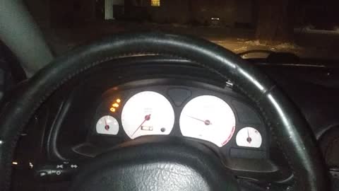

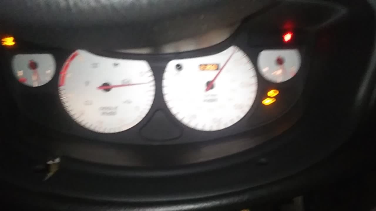

Just unhook negative to battery last night and kept trying to restart it and it started up. I let it warm up drove it 10 miles and let it run at idle at a buddy's and it just quit running and now I have to go and tow it back home. I stop there because i notice i didn't have turn signals but had everything else. And it was idling 10 minutes and just shut off.
Jan 26, 2020 at 6:52 AM

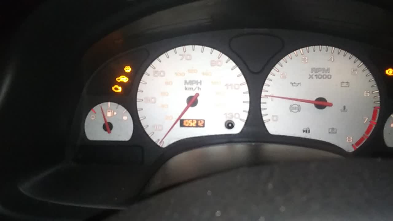

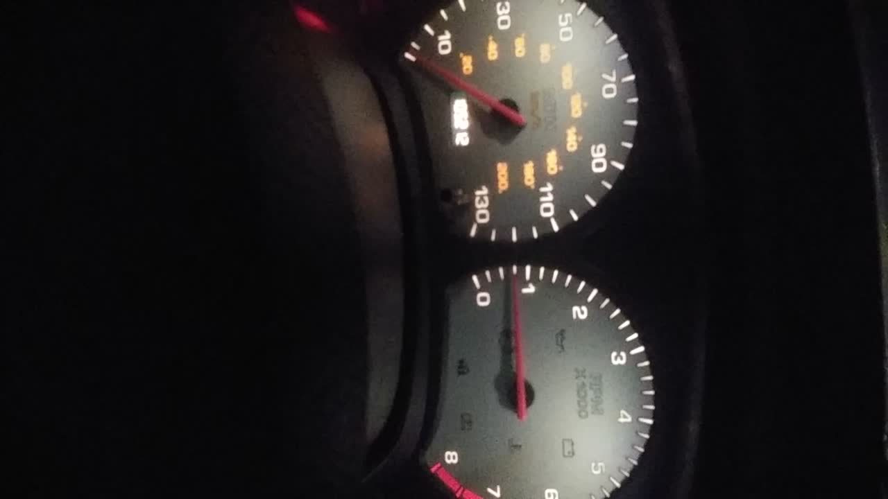

Put the new used BCM and relearned the pass-lock but still no start and no fuel gauge no tachometer movement also. And scanner wont connect. Crankshaft position sensor? It was changed in 2012.

Thanks guys you did help a lot. it was my fault. after I took a couple days off from it I went back started over . It end up being that I purchased a faulty main relay from the store after finding the same relay. I swap it out and I got power to my ECM am I fuel gauge came on. I did a relearn on a BCM car started right up. thanks guys you were a great help. I owe you big time but tell you what I learned a lot and I'm going to save this information that you posted. The 2004 Saturn L300 crank but no start problem is solved thanks to 2CarPros. If I knew where you were I'd buy you a drink.
