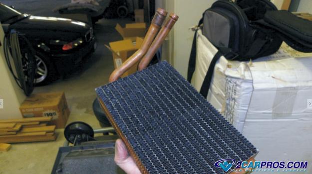

2. Air Inside Heater Core: When air bubbles get trapped inside the heater core and can make a gurgling sound while the engine is running. This problem usually goes away after several cycles of driving and allowing the engine to cool, but if not, start the engine, (heater on) and raise (jack up) the rear of the car and air bubbles should work their way out after a short time, (5 minuets approx), if that doesn't work raise the front of the car and repeat.

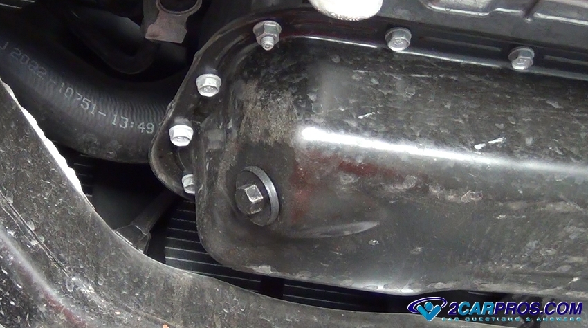

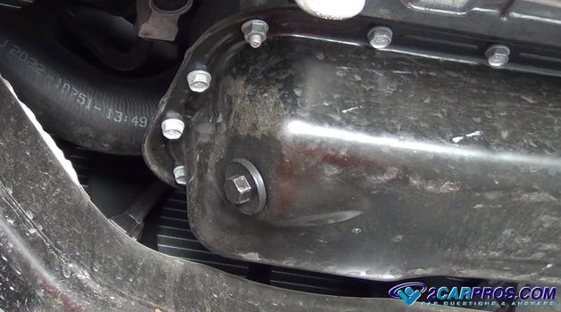

4. Gurgling as Engine is Shut Off: Engine oil is circulated throughout the engine while its running, when the engine is shut off this oil which is now pumped to the inside the cylinder head(s) will drain down and back into the oil pan, again this is normal and not a problem.

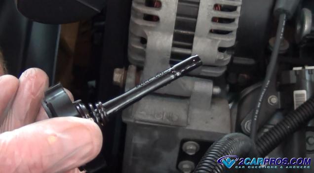

5. Power Steering Fluid: If the steering fluid level is low, it can pull air into the system causing a gurgling noise due to the air bubbles in the system. Check the power steering fluid level by locating the fluid reservoir and removing the cap (twist counter clockwise). If the fluid level is low add manufactures recommended fluid and allow the system to stand for a period of time to allow air (aeration) to dissipate.

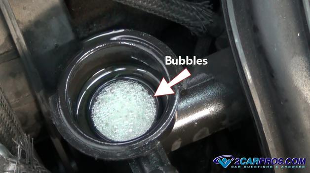

6. Blown Head Gasket: If the head gasket has failed, it will continuously pump exhaust gasses into the cooling system creating bubbles inside the radiator. To check for this, wait until the engine is cold and open the radiator, then start the engine and observe the coolant. Iif it looks like the image below the head gasket needs to be replaced to fix the issue.
