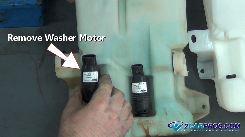

If only the fluid reservoir is being replaced, remove the washer pump motors motors from the old container.
remove washer fluid motor

Match the new washer pump motor to the old pump to ensure a proper installation. When replacing the washer fluid pump only, be sure to clean the reservoir thoroughly to ensure proper pump operation.
new washer fluid pump
Install the new motors into the washer fluid container, again use a lubricate such as WD40 to aid the seals function.
installing new washer pump motor
