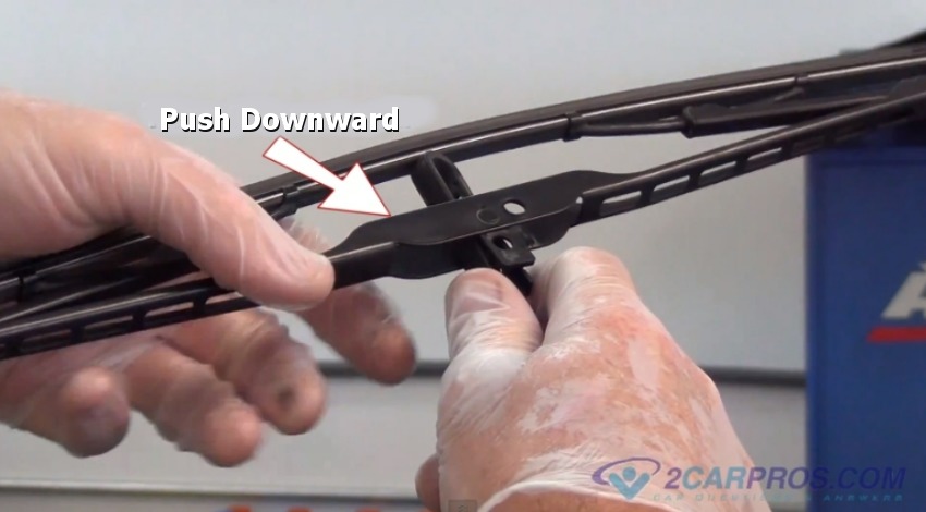

Use a small screwdriver or your finger to release the wiper tab or pull down the collar retainer.
wiper tab released
With the tab or collar released, push the wiper arm downward to disconnect the wiper from the arm.
push downward in wiper
