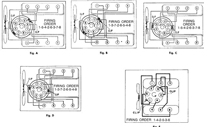

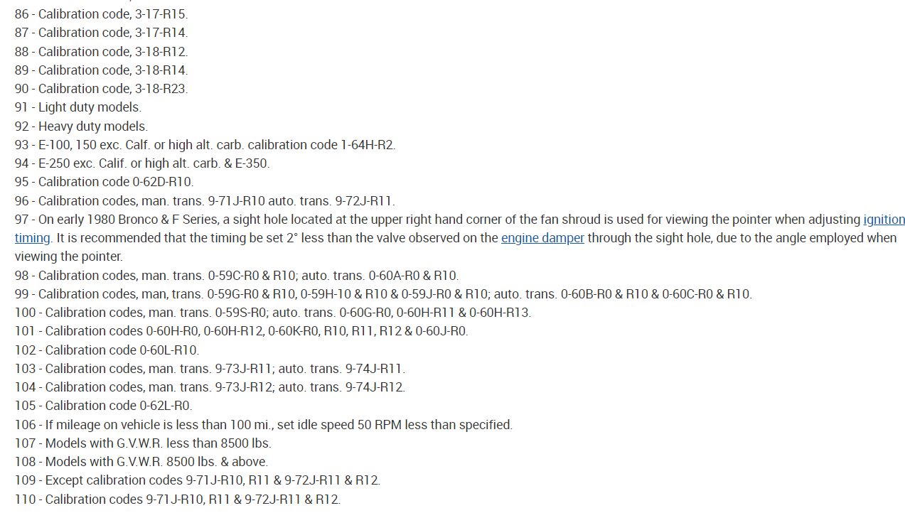

It sounds like the lifters have not bled down after the disassembly; can I ask how long after the reassembly did you try to start it? Sometimes if you let it sit for a few days the lifters will bleed back down and you will get the compression back. Also, is there a change the firing order is incorrect? Here is what the firing order should look like. Check out the images (below). Please let us know what happens.

It was at least a couple of weeks if not more between buttoning up the engine and trying to start. The lifters were not removed from the engine, just the pushrods and rockers. As far as firing order is concerned, I have the wires in an aluminum wire loom, so all goes back together correctly. Removed all in one piece from both sides.
