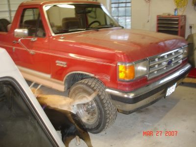

Thanks Raxmataz, can you recommend the best manual for this job and also an engine stand? I will order them now and have them delivered by the time I get home. I have a overhead winch in the shop large enough to pull the engine, but would like a stand. The picture below is when I first picked it up and before the body and paint work.
