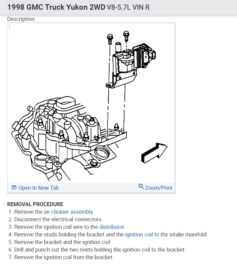

Hasn't started in several days, has spark but it's weak. Fuel pump, filter and line are good, but seems to not get as much gas to the throttle body. The distributor seems to be in good condition , and while trying to get it to start, it developed a back fire.

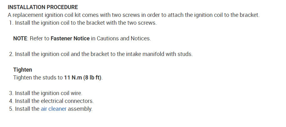

We need to fix the weak spark first which can be caused by a bad ignition coil. here is the location and how to change it out in the images below. Once the coil is replaced, see if the engine will start on starting fluid if it will not run on its own. You may have a bad spider injector which is common on these engines. This guide can help as well:
