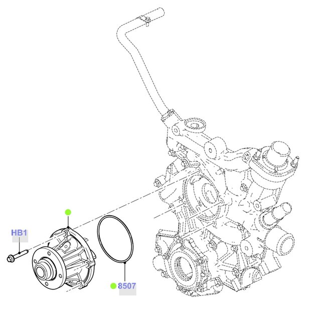

Waterpump

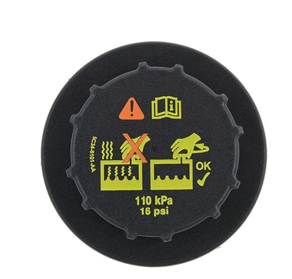

If you leave the coolant cap unscrewed the cooling system can't build pressure. If it can't build pressure the coolant will boil, fill the system with air and will not be able to cool the engine effectively. It will also puke out the top of the reservoir and get everywhere.
Keeping the coolant cap tight will ensure your cooling system will be effective at removing the heat from your engine. If there is too much pressure the cap will release at a certain pressure, usually around 13 psi, and the coolant will go through the overflow hose.
Sometimes this cap can become faulty and allow too much pressure to build in the system. This will cause leaks and I have seen it blow a radiator hose right off.
Here is the Motorcraft part number for a new cap. Part number: 9C3Z8101B.
My advice is to fill the system cold to where it should be and put a new cap on it. The cap should be around $15. Don't get a universal one, get the Motorcraft one from ford so it is made for your exact system as it is set for a specific pressure.

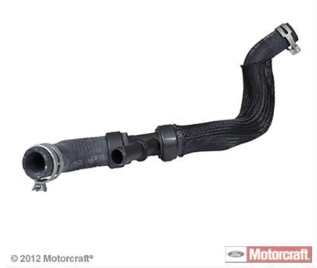

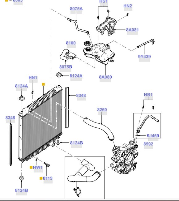

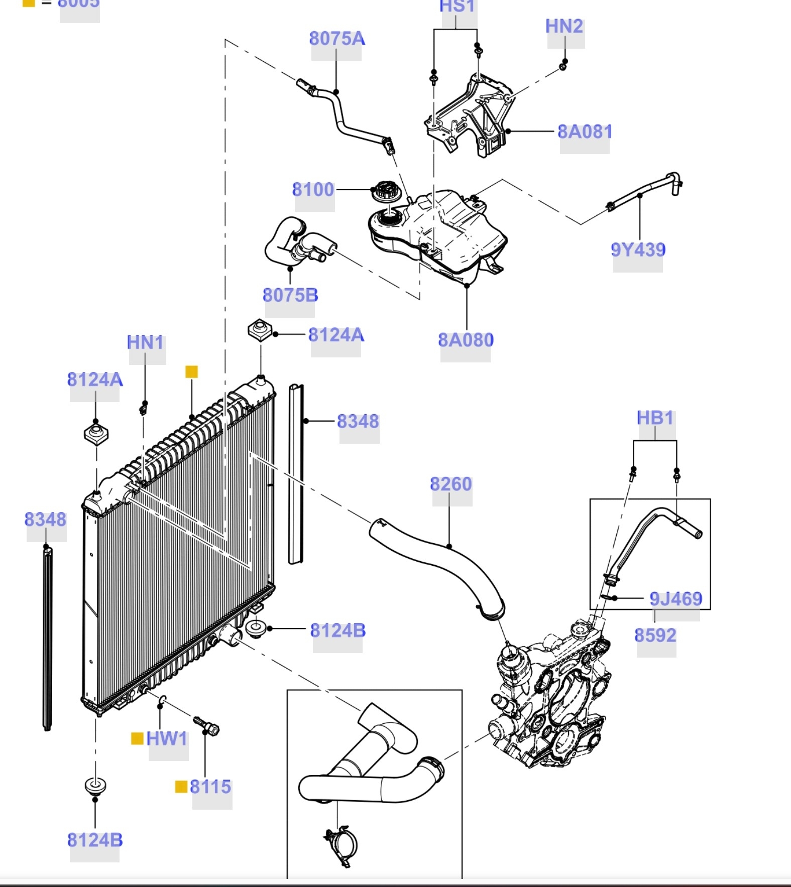

If you think the plastic "Y" is leaking I got the part number for that for you.
Part number: 5C3Z8075CB
I have added a picture for you as well. Since it is plastic, it is definitely a good possibility that's where it is leaking.
Coolant on rubber components can definitely make them squeak. Plus unfortunately sometimes the wrong people put lifts in vehicles and they are not put in the right way. Not saying this is your issue but we won’t rule it out for now.
Let’s tackle the coolant leak and go from there as you may have a few issues going on.

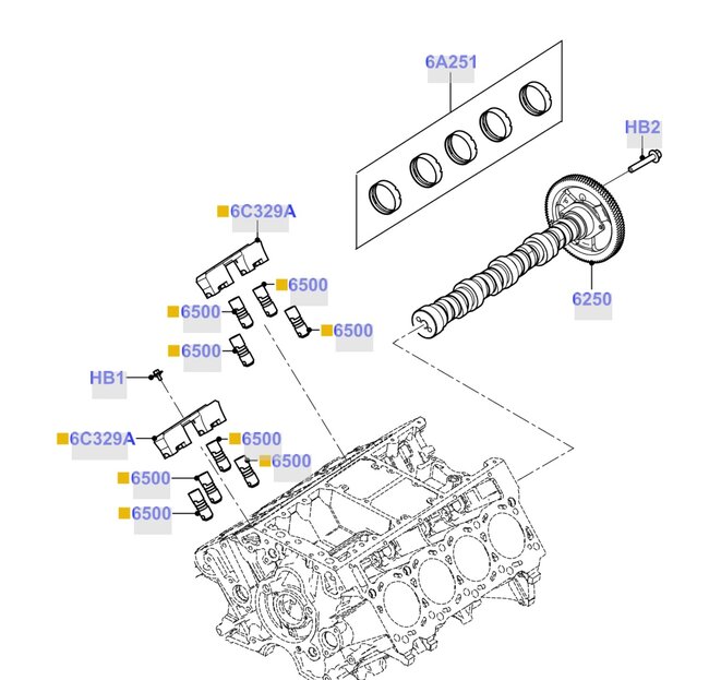

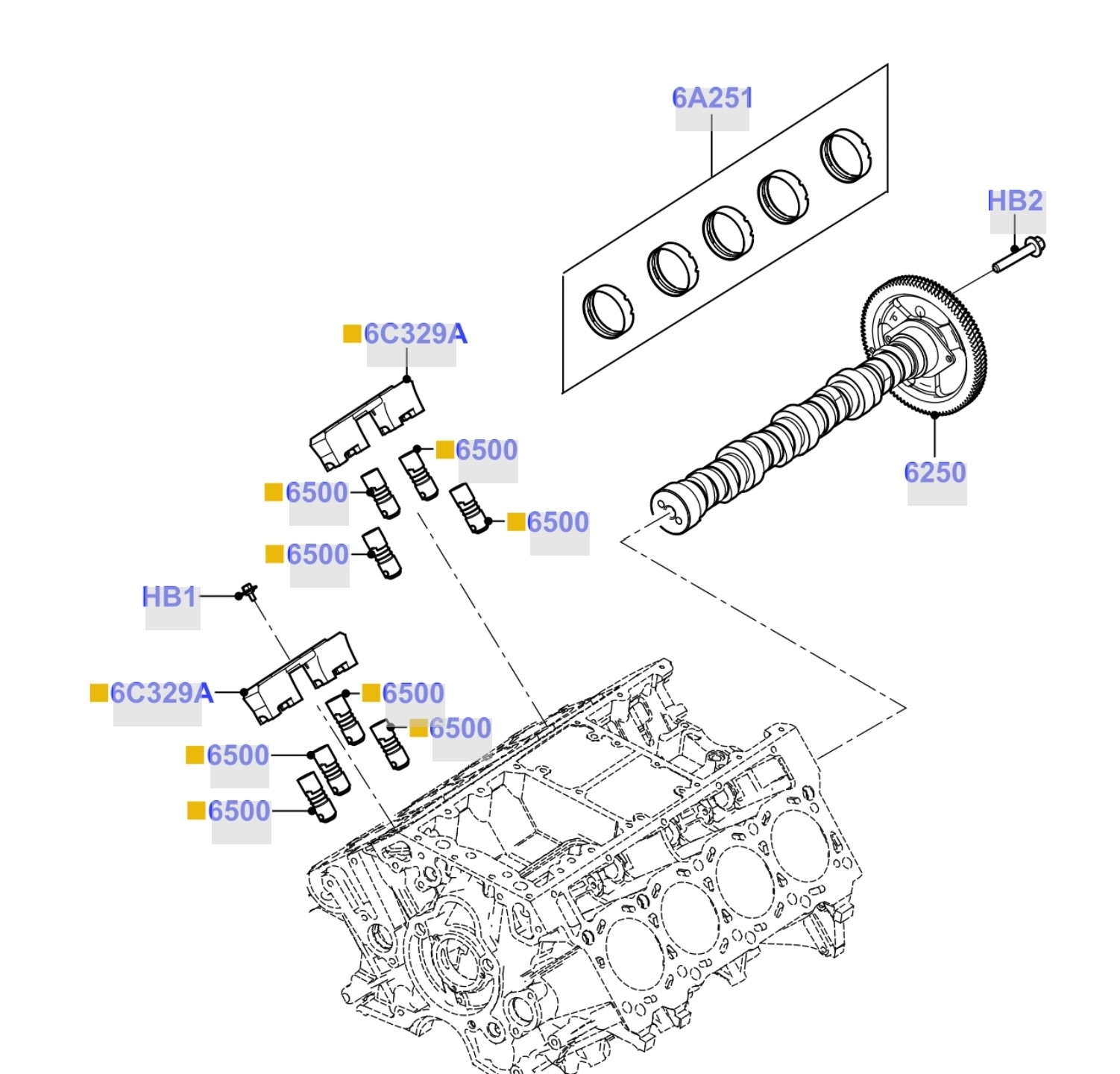

Something to note is this vehicle has a hydraulic roller cam. So, the lifters that ride on the camshaft have little wheels on them. They also sit in a guide and can sometimes turn and the wheel will drag sideways on the cam. It will make a squeaking noise as well and can sound like it’s coming from a different area. We will keep that on the back burner for now as well.

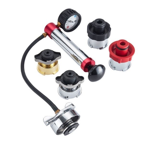

Best way to find a coolant leak is with a pressure tester. It can be rented at most local auto parts stores and is very easy to use. (I will add a picture of one for you).
Clean all the coolant off the motor. Then make sure to fill the coolant to the proper level squeezing the hoses to get the air out.
Engine degreaser works but makes a mess. I find brake clean and a rag works best.

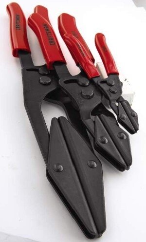

Now attach the tester to where the cap goes. Use pliers to pinch the overflow so you don't lose pressure. (I have added a picture of some hose pliers that won’t damage the hose. I suggest getting a pair.)
Pump the system up to pressurize it to what is listed on the radiator cap, usually 13-16psi. If there is no listing 16 psi is good enough but you can go a little higher if you need too just be careful.
It should hold at the pressure you pump it up to and the hoses should be tight.
Note if it isn't holding pressure at all either the tester isn't connected properly and is leaking or you’re losing it through the reservoir overflow hose. If it is bleeding off slowly then there is a leak somewhere.
Now take a light and look at the entire cooling system and see if you can see a leak. All pipes, hoses, thermostat, water pump etc. especially on the Driver's side.
This test allows you to somewhat control the leak so that it can be found before the entire engine bay is covered in fluid.
Also, do this test with the engine off and cold.
