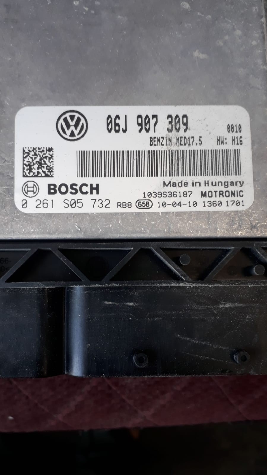

Hi KASEKENNY1, I showed the car locally at a garage and there were 2 issues, burnt wiring and damaged ECU (engine computer unit). now I am trying to find a replacement of the engine unit but I am unable to find an exact model. for instance the model that my car has says "06J 907 309" however online they have "06J 906 …" so I am not sure if these would work.
I contacted the Volkswagen service center locally and they are charging a huge amount for replacement. please if you could suggest.

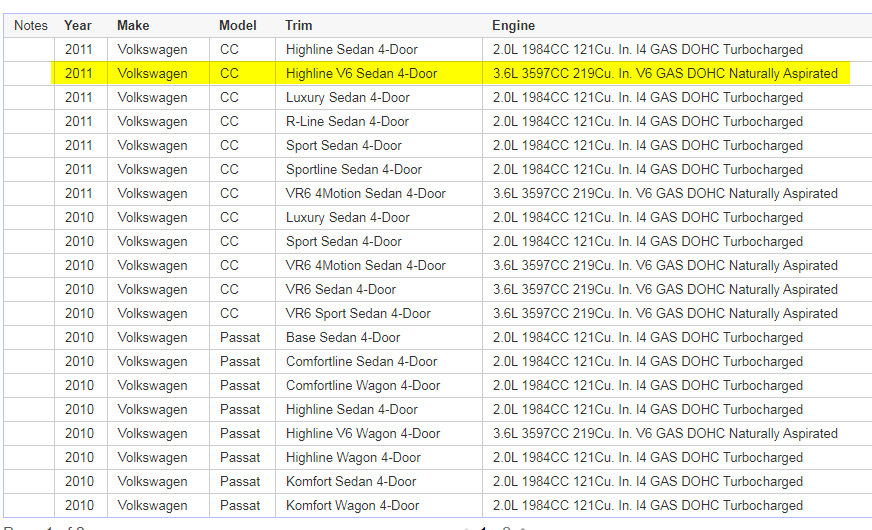

Okay. Yeah. Wiring and the ECM/PCM are the first to go.
Here is a link to one that appears to work. You said in the header that this was a 1.6L V6. I assumed you meant 3.6L. If so, this will work but it is used so you have no idea what you are getting.
https://www.ebay.com/itm/10-11-VOLKSWAGEN-PASSAT-06J-907-309-A-COMPUTER-ENGINE-CONTROL-ECU-MODULE-L1254-/401206757593

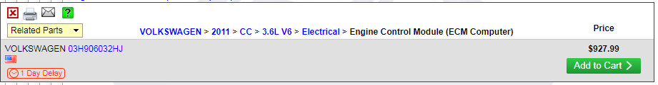

This links is for Rockauto.com that has one for just over $900. Not sure what the dealer was charging but this would be a new ECM so I am sure it comes with a warranty. You may have to copy and paste this in a browser because they don't always paste on this post correctly.
https://www.rockauto.com/en/catalog/volkswagen,2011,cc,3.6l+v6,1447505,electrical,engine+control+module+(ecm+computer),2896
