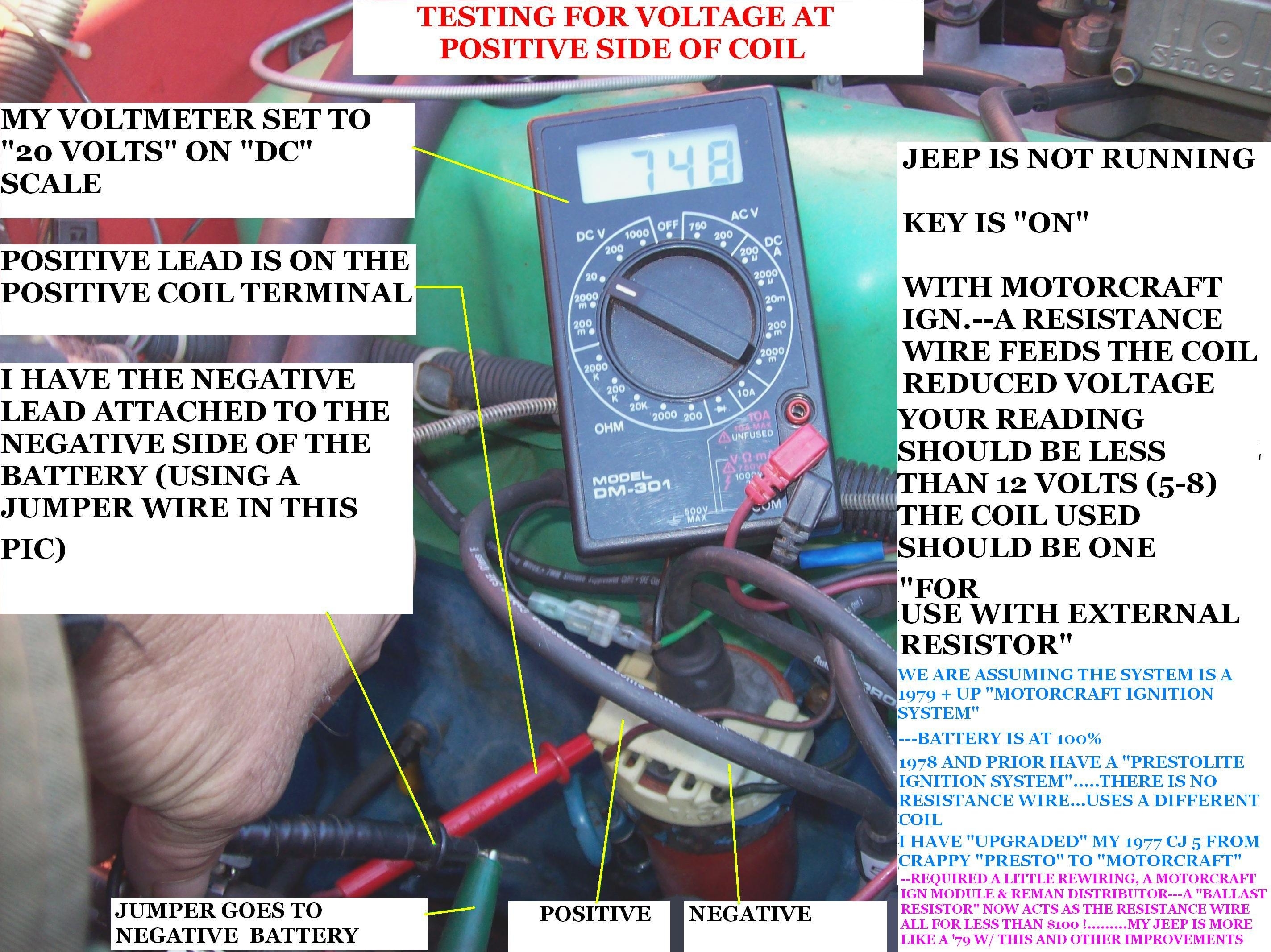

See if you have 12 volts to the positive side of the coil with the key on!
Cheap digital voltmeter available at Harbor Freight for about $5.00.
I'll stay with you as long as you keep responding.
I'll help all I can. I know CJs well.
See picture below.
