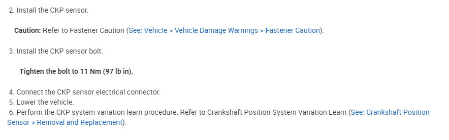

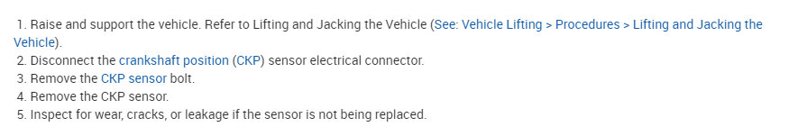

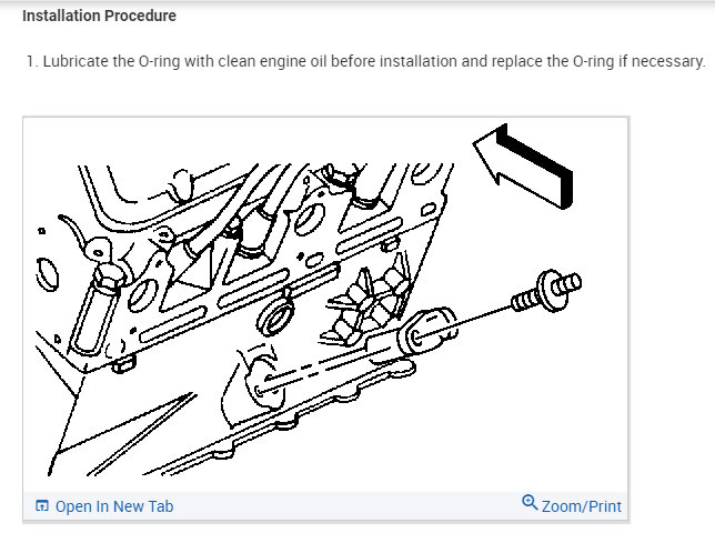

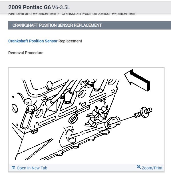

If it fails to run, my first suspect is a faulty crankshaft position sensor. When they begin to fail, heat adversely affects them. As a result, the ignition spark is lost, and you need to wait until it cools off for it to run again.
Do me a favor. Take a look through this link and let me know if it seems to mirror what you experience:
If it does seem to mirror what you experience, I attached the directions below specific to this vehicle for the replacement of the sensor.
On the other hand, if it is the starter motor that won't work, let me know that as well.

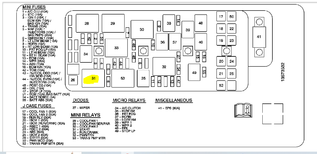

When I say it won’t start, I mean no crank at all. It most happens in the afternoon when the sun is hottest. Yesterday I drove it to a few places in the morning and it started with no problems. When I got home around 1:00pm I shut the car off and tried restarting it just to check and it wouldn’t turn on until about 5:00pm when the sun was starting to go down.
Aug 8, 2023 at 10:39 PM
  • 110,244 POSTS
Okay, so the starter doesn't engage. First, take a look at link 1. It covers different possibilities that can cause the starter to fail when hot. Also, link two explains what and how to check the starter motor:
https://www.2carpros.com/articles/comprehensive-guide-why-doesnt-your-car-engine-crank-when-hot-and-how
The issue could be the result of a faulty starter relay. This is an easy thing to check but should be done when the starter won't engage.
I attached a pic below of the fuse box under the hood. I highlighted the starter relay. Switch it with a different relay having the same part number and see if the starter then engages. If there isn't a relay with the same part number, here is a link that explains how to test one:
Let me know what you find.
See pic below.
