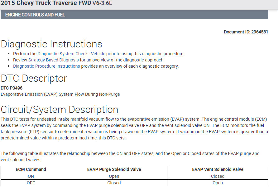

code P0496. will not start when after getting gas. It just cranks.
Jan 22, 2018 at 12:46 PM
SQM
  • 6,383 POSTS
This is an emission related code:
DTC P0496
Evaporative Emission (EVAP) System Flow During Non-Purge
You might not be getting fuel, that's why it does not start.
https://www.2carpros.com/articles/how-emission-control-systems-work

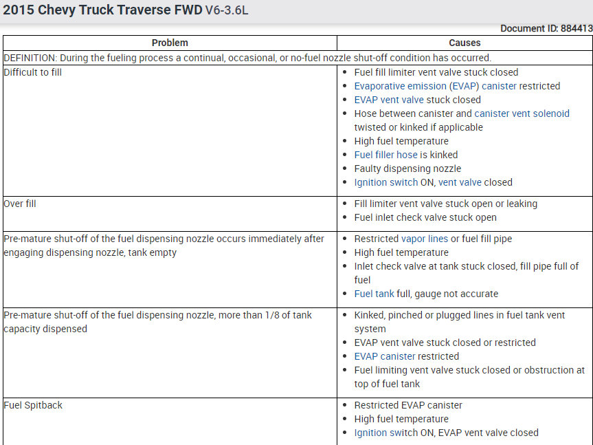

From what you are describing you might have gotten poor quality fuel. Many cases poor fuel quality requires all the fuel to be drained and purge the system before being able to fix the vehicle.
I have attached a basic diagnostics of poor fuel quality.
Let me know of any questions.
