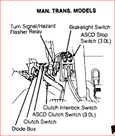

The engine turns over but will not start using key, however it will start and run fine if I pop start it using transmission to start it. Please help. No one I know can figure it out.

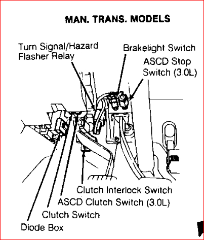

Have you looked into the clutch interlock system? I would start there first. Basically it is an electrical circuit and switch so you can only start the truck with the clutch pedal depressed. I have attached a picture. Hope this helps and thanks for using 2CarPros.

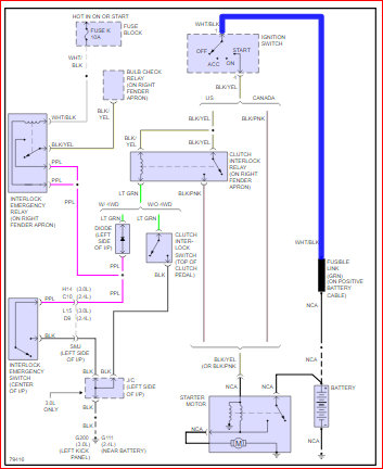

Danny, thank you very much for your reply. Yes, I checked it. Good thinking though. The only reason I thought about it was I had a Toyota that had that problem. Been messing with it and just figured out that it's in the ignition.

Okay, Keep us updated. I can look for a steering column/ignition switch if needed. Hope this helps and thanks again for using 2CarPros.

I've attached a wiring diagram for your trucks starting system. I've also attached a tutorial showing how to test wiring.
