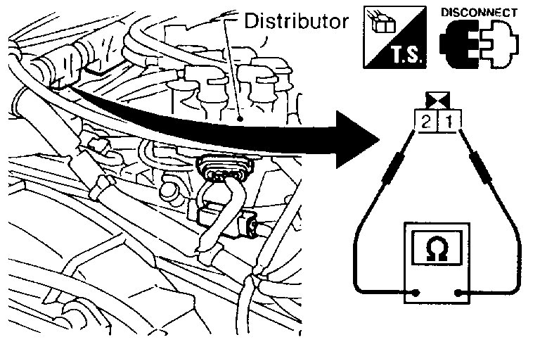

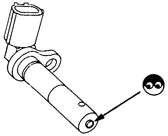

Since the crankshaft position sensor failed after the transmission was removed, first, confirm there are no broken wires and the connector is tight and not damaged. Also, make sure (it's easy to do) that none of the wires got pinched between the transmission and engine.
Next, we need to make sure the sensor is the problem. If you have a live data scan tool, see if there is an RPM signal when the engine is cranking. If there is a tachometer, see if it is moving when cranking. If it is, chances are the sensor isn't the issue.
If there is no signal, then we can suspect the sensor is the problem. Here are directions for testing the crankshaft position sensor. Do this and confirm it is good. Even though it is new, it still could be bad.
____________________________________
1999 Nissan-Datsun Truck Pathfinder LE 4WD V6-3.3L (VG33E)
Component Inspection
Vehicle ALL Diagnostic Trouble Codes ( DTC ) Testing and Inspection Manufacturer Code Charts Engine Control System With MIL Indicator Lamp DTC 0802 To VIN # 350000 Component Inspection
COMPONENT INSPECTION

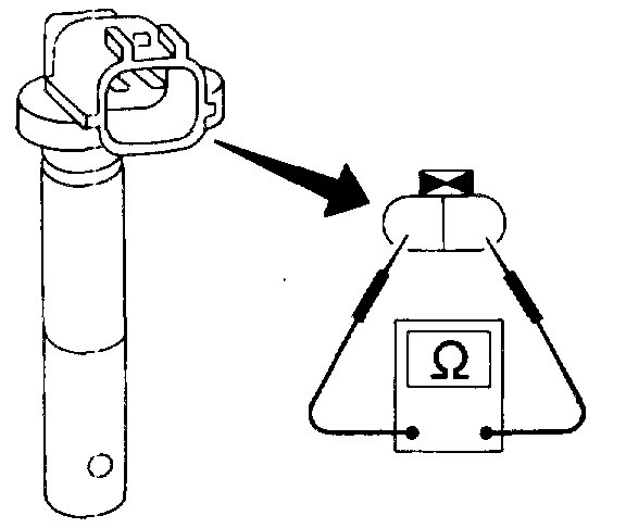

See pic 1
See pic 2
CRANKSHAFT POSITION SENSOR (OBD)
1. Disconnect crankshaft position sensor (OBD) harness connector.
2. Loosen the fixing bolt of the sensor.
3. Remove the sensor.
4. Visually check the sensor for chipping.
5. Check resistance as shown in the figure.
Resistance: Approximately 166.5 - 203.5 Ohms [at 20°C (68°F)]
If NG, replace the crankshaft position sensor (OBD).

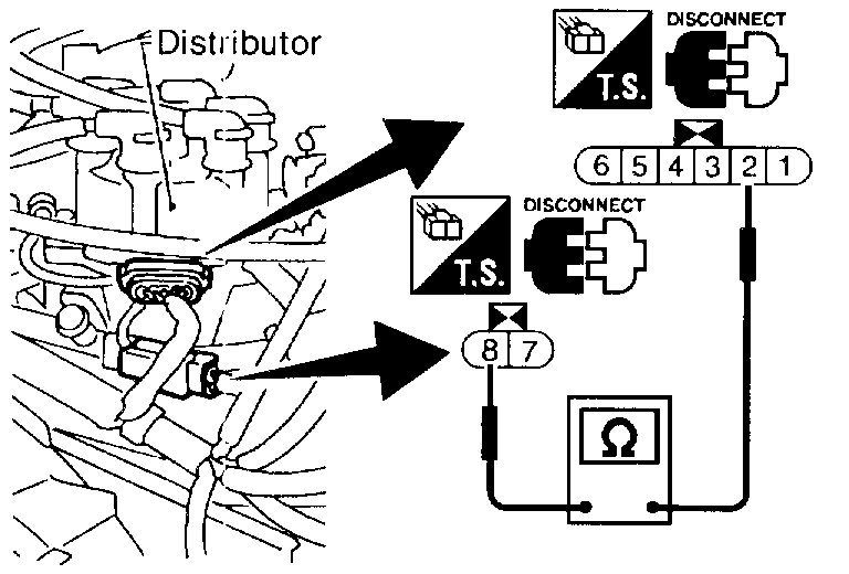

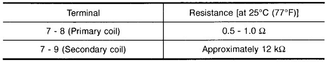

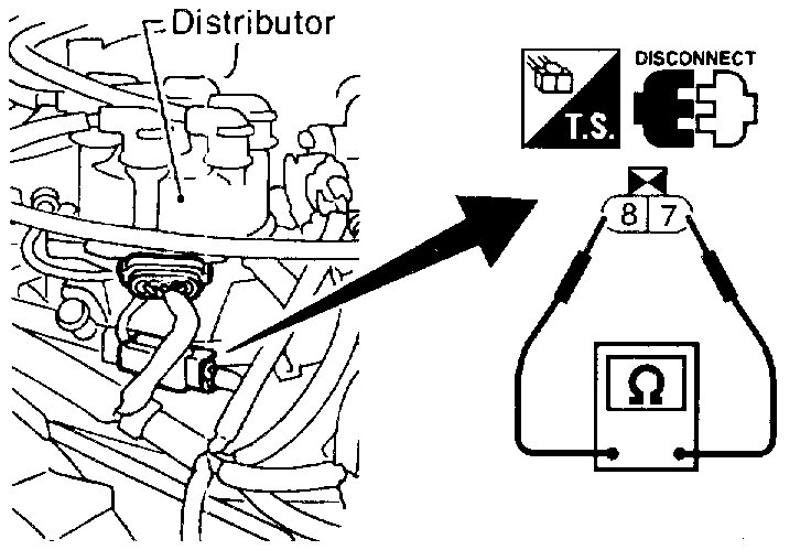

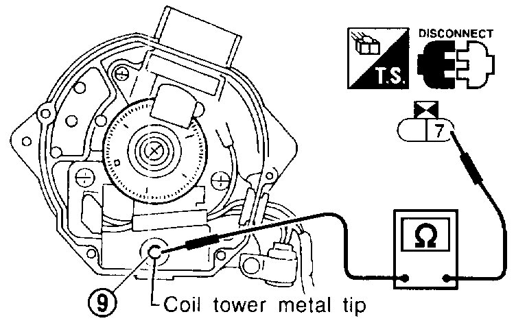

Vehicle Powertrain Management Relays and Modules - Powertrain Management Relays and Modules - Ignition System Ignition Control Module Testing and Inspection Initial Inspection and Diagnostic Overview Component Inspection
pic 1
pic 2
pic 3
pic 4
pic 5
pic 6
IGNITION COIL
1. Disconnect ignition coil harness connector.
2. Check resistance as shown in the figure.

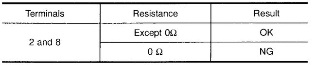

POWER TRANSISTOR
1. Disconnect camshaft position sensor & power transistor harness connector and ignition coil harness connector.
2. Check power transistor resistance between terminals 2 and 8.
If NG, replace distributor assembly.
