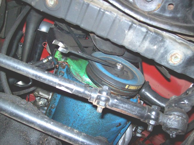

If you 'move" the crank (really the flywheel) a 1/4 turn using a ratchet or a wrench (with key off), does the ball game change when you go to start it?
See picture below of me moving my 1977 Jeep CJ-5 crankshaft with a wrench.
