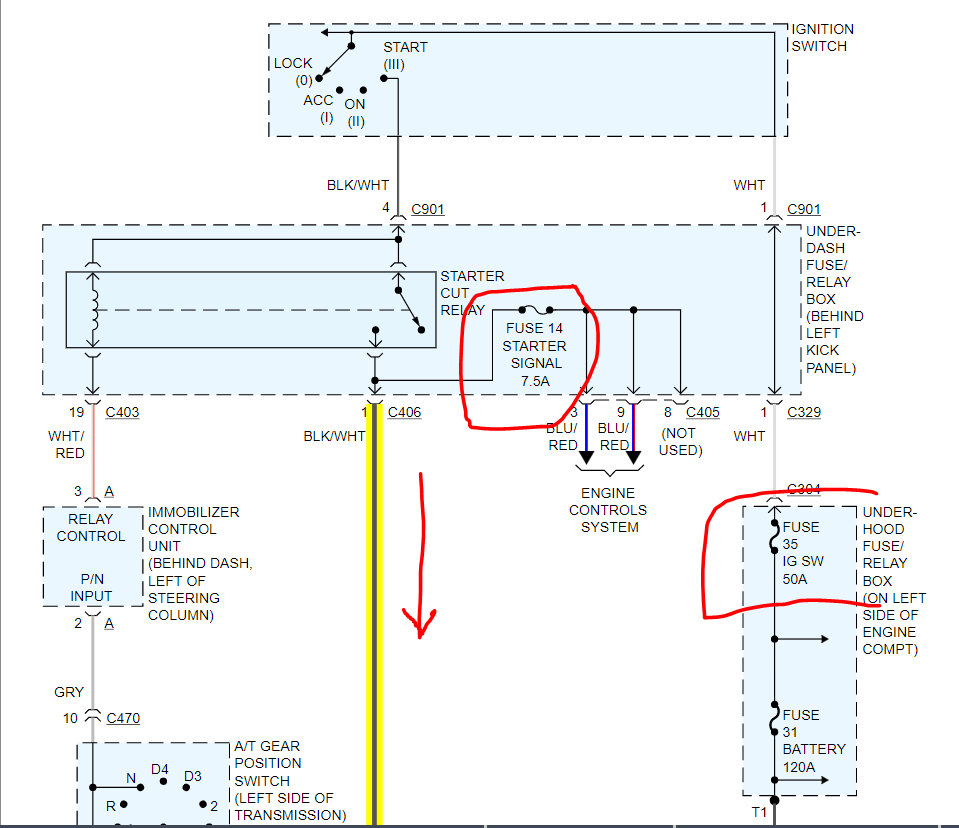

My son's car was running before the battery died and was sitting in the driveway until he finally bought a new one. Now the car won't start or even crank and the radio won't come on either, everything else comes on. The dashboard lights, headlights, electric seats work, etc. I checked the starter fuse under dash and it's good. Is there a starter relay or is it a factory kill switch I don't know about?

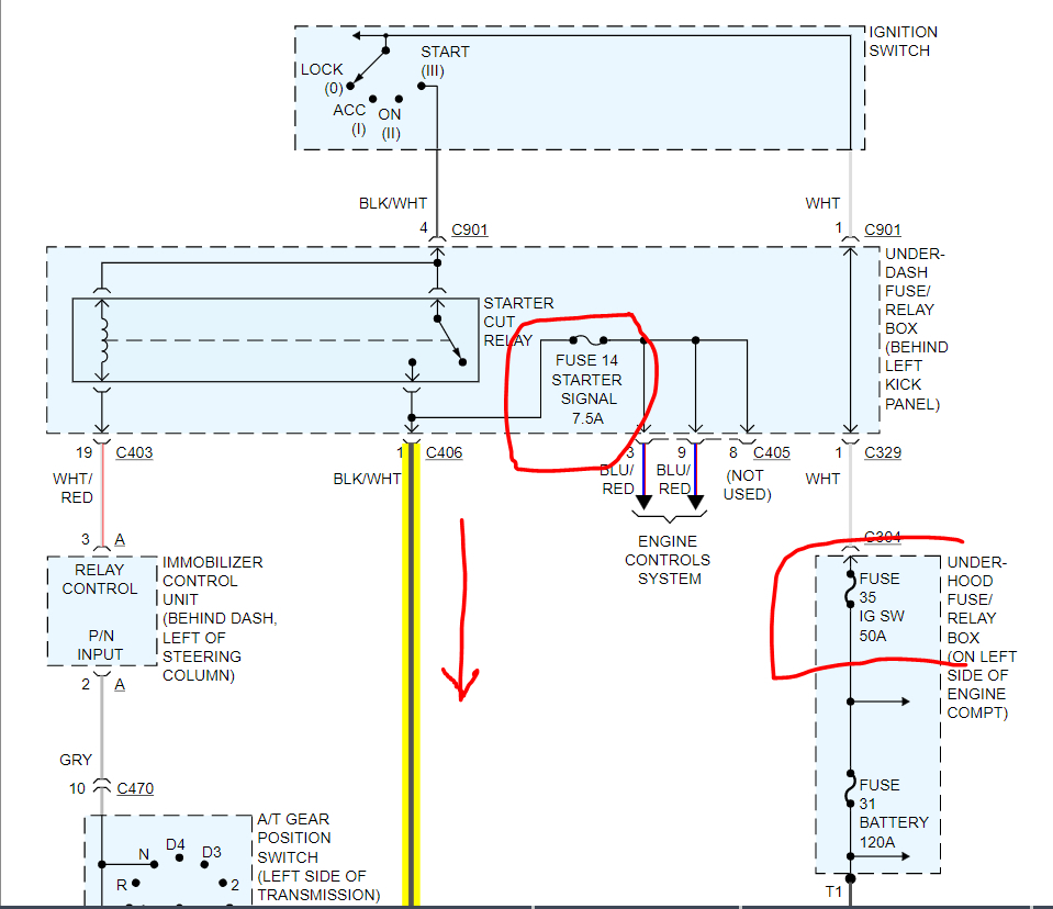

It could be a few things. First, see if it starts in neutral. Next, check the fuses I indicated in pic 1. Finally, there is a starter cut relay. Check it as well which is also shown in the picture.
When checking the fuse, confirm there is power to the fuse.
