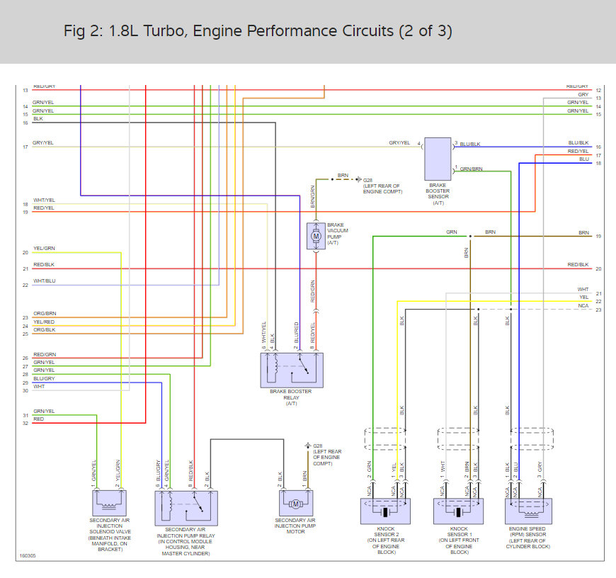

Hello again,

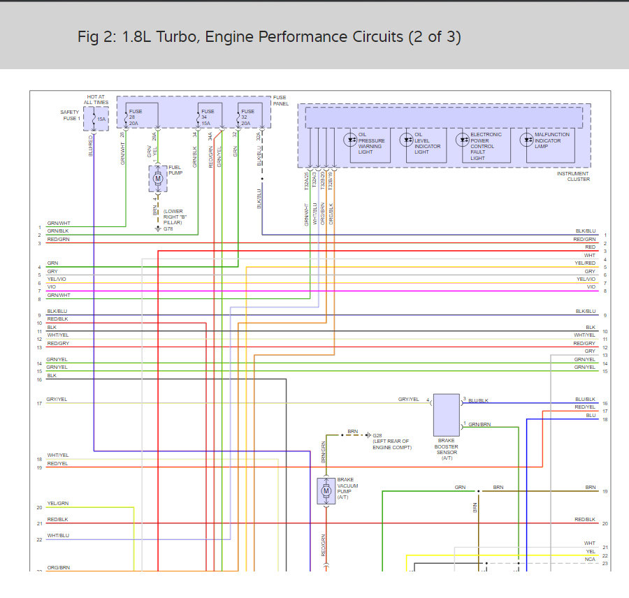

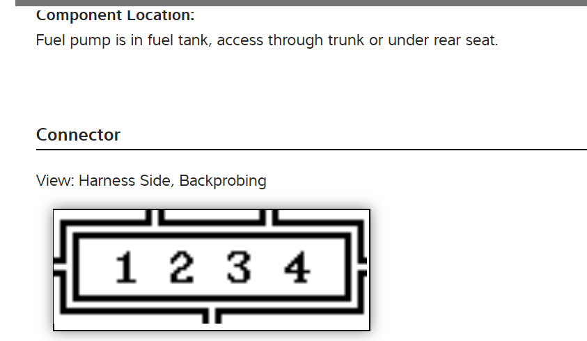

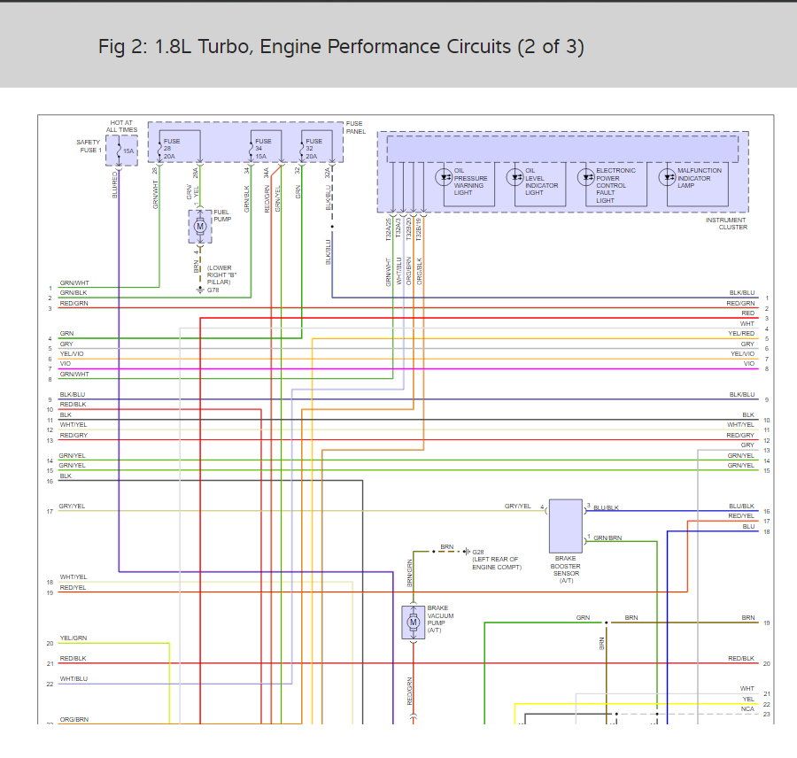

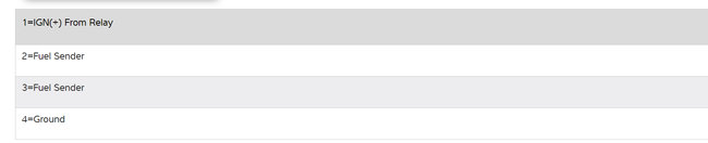

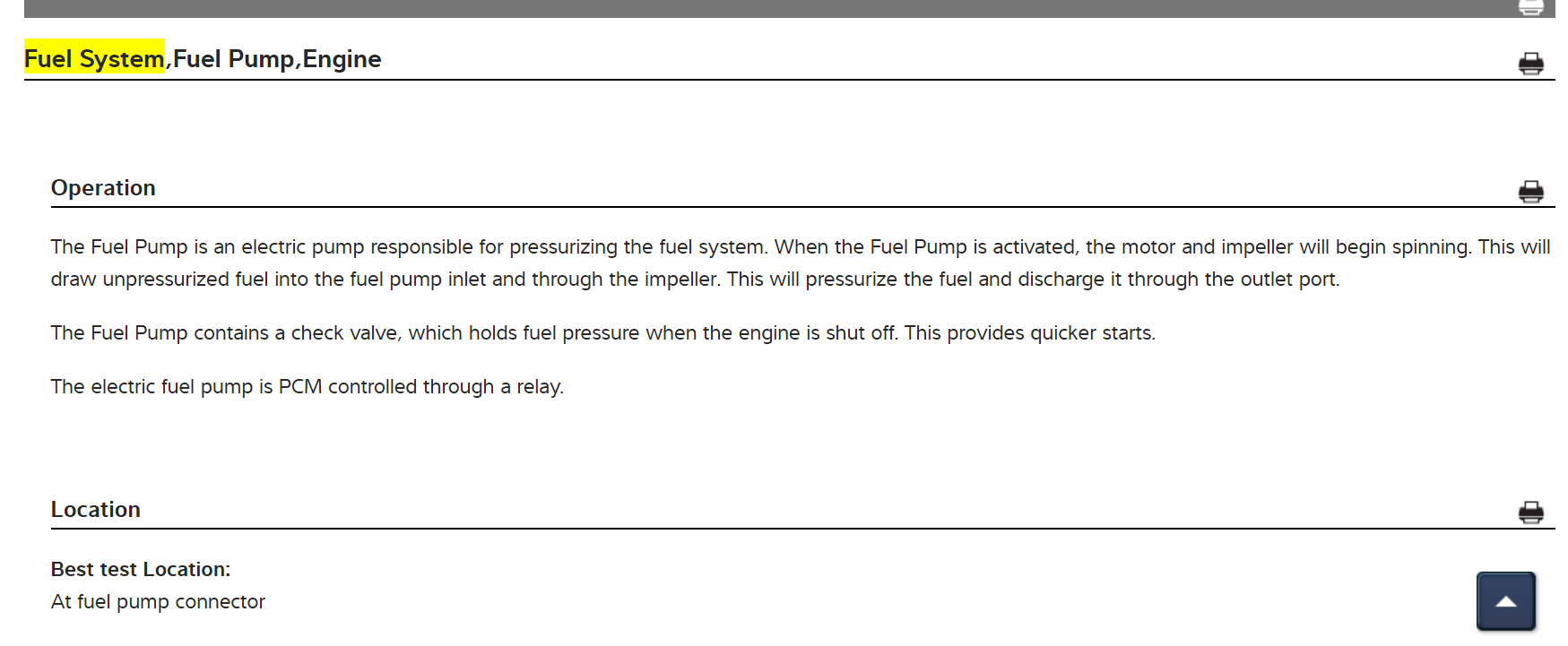

Okay let's start tracing the fuel pump circuit and see if you are not battery+ (12 volts) to it.To do this you will have to use a multi-meter. I have included a link below if you are not familiar with using one.
In the diagrams down below I have included information on the fuel pump connector as well as wiring diagrams. Please use this information and take a reading at the fuel pump connector and see what the voltage is there. You will need an assistant to be cranking the car while you do this, as if you just the key on, the fuel pump will only turn on for two seconds, just long enough to prime the system.
Please get back to us with what you find out and we can go from there.

Not getting power to the fuel pump. I have checked all the relays and fuses the are all good. Also not getting any power to fuel injectors.

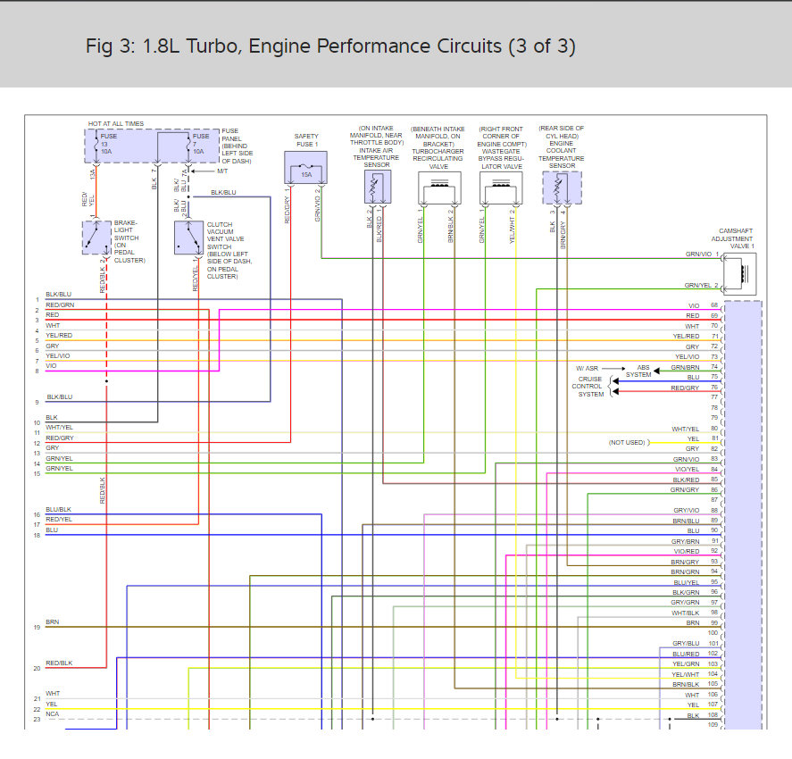

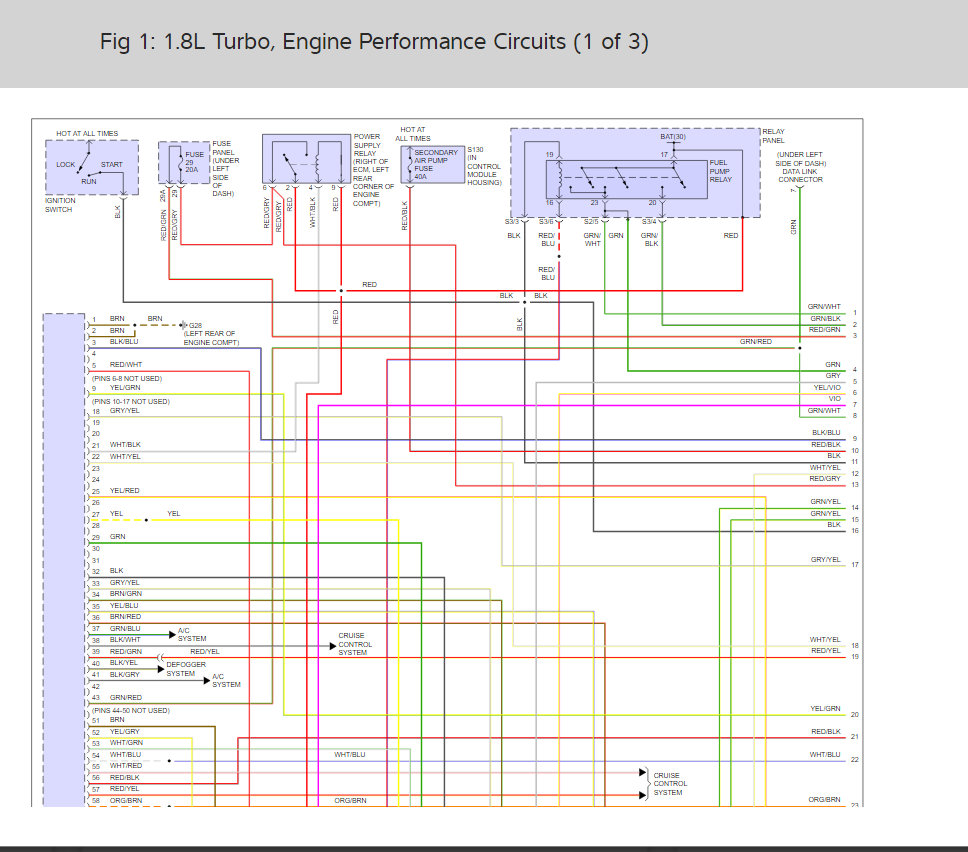

Hello again,
Do me favor and double check for voltage at the fuel pump relay again. If you have no power there then check for power at the Power Supply Relay at the left rear of the engine compartment. I am getting this information from the top of the wiring diagrams I sent diagram 1 of 3 top of the diagram. Get back to us with what you find out.

ALFRED SAMPLE
Getting no power to fuse or relay for fuel pump.

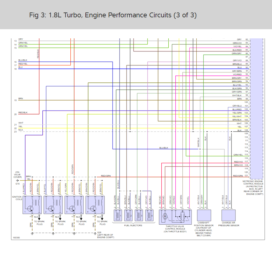

Hello again,

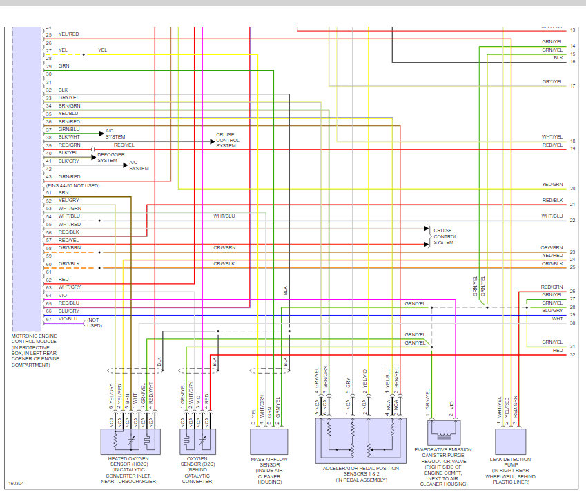

Okay, are you getting power at pin #22 on the motronic engine control module(left side of 1 of 3 on the wiring diagrams. It should have a white wire with a yellow stripe going into it. Your ignition switch can either be in run or start for this test. Get back to us with what you find out.
