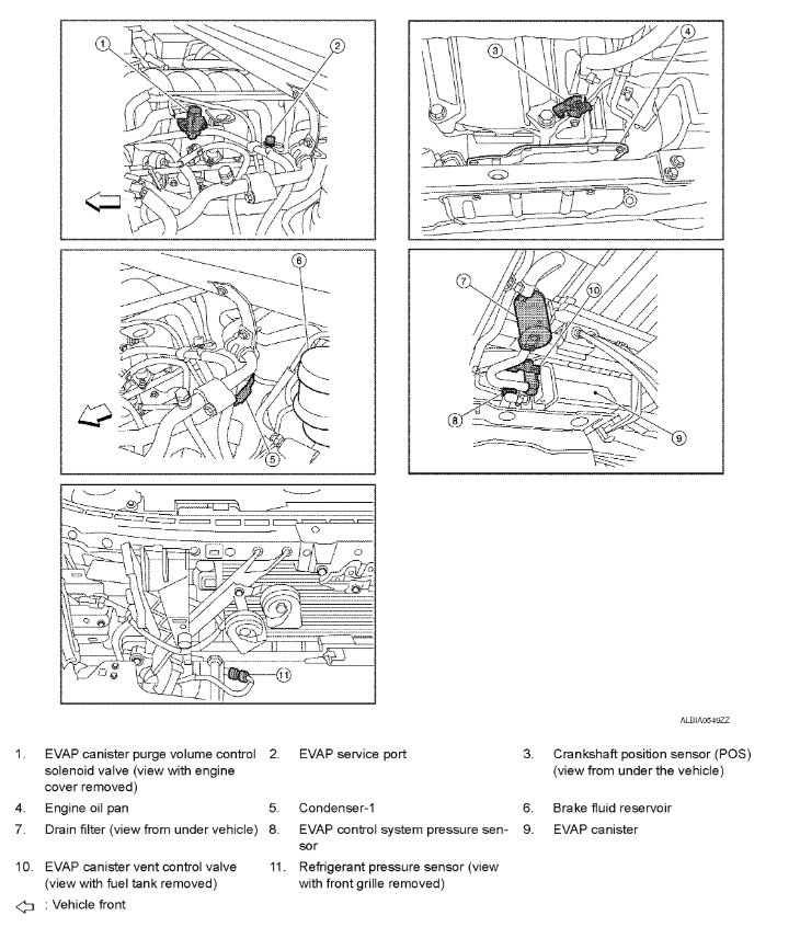

Just turns over, has no injector pulse, and no fire, it has fuel pressure.
Oct 20, 2018 at 1:03 AM
  • 55,402 POSTS
This sounds like a classic crankshaft angle sensor that has gone out. Here are two guides to help us change the sensor out step by step with the location and how to change it out on your car below. The sensor is under the truck near the bell-housing of the transmission.
