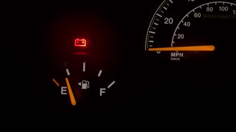

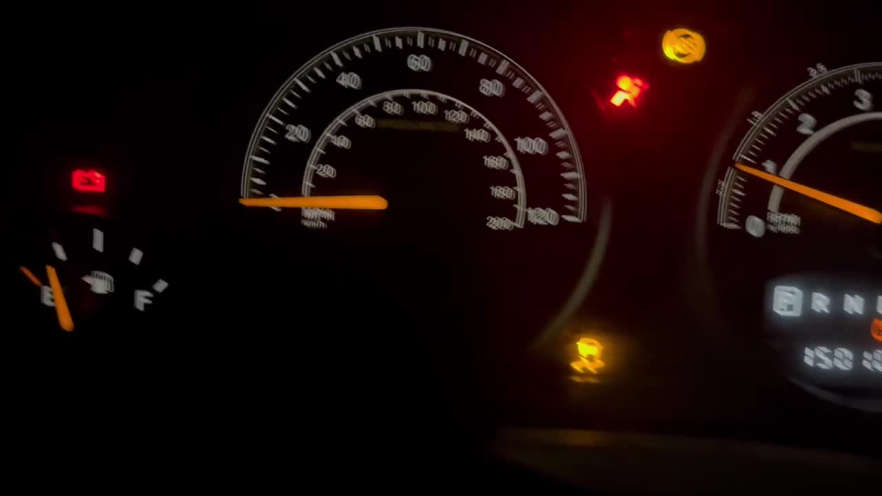

I started my car up, the battery light came on, then I had to defrost the windows. When I did that the stereo went off. Then the brake, airbag, and the 4wd light all came on. I put Jeep in D and it just shut off. It won’t start.

You're describing a failed charging system. When it doesn't keep the battery charged, system voltage drops as the battery slowly runs down. Computers are very intolerant of low system voltage so they start to shut down. They turn on their warning lights to tell you.

So, I bought brand new battery last night drove around for about 20 mins then the battery light came on, then the brake light, then the ABS light, and gas light, then 4 wd light. Once I put it in park, it sounded like a car does when they run out of gas then turned off.

This is not a battery problem. It's a failure of the charging system to keep the battery charged while you're driving. 20 minutes is about all you can expect before a good battery runs down.

The most common cause of this problem is a failed alternator, but there are other possibilities. That's why tests must be performed so we don't waste money by throwing random parts at the problem.
The voltage tests I described are simply to verify the charging system isn't keeping the battery charged, but by now we already know that. From here you'll need to charge the battery with a portable charger, then drive to a repair shop for a diagnosis. Two more voltage readings will tell if the alternator has failed or if the voltage regulator is suspect. That regulator lives inside the Engine Coputer. It doesn't fail very often, so that should be at the bottom of the list of suspects. Besides the alternator, a broken wire is a better suspect.
