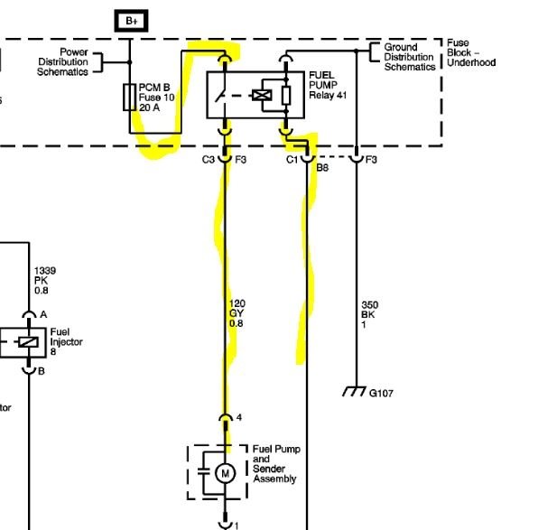

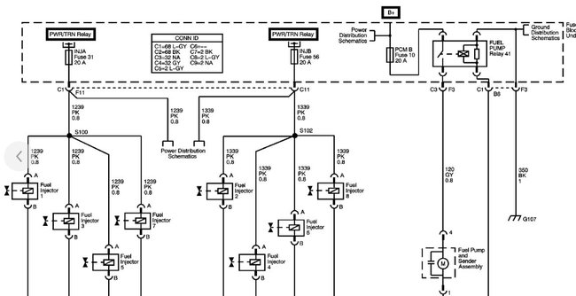

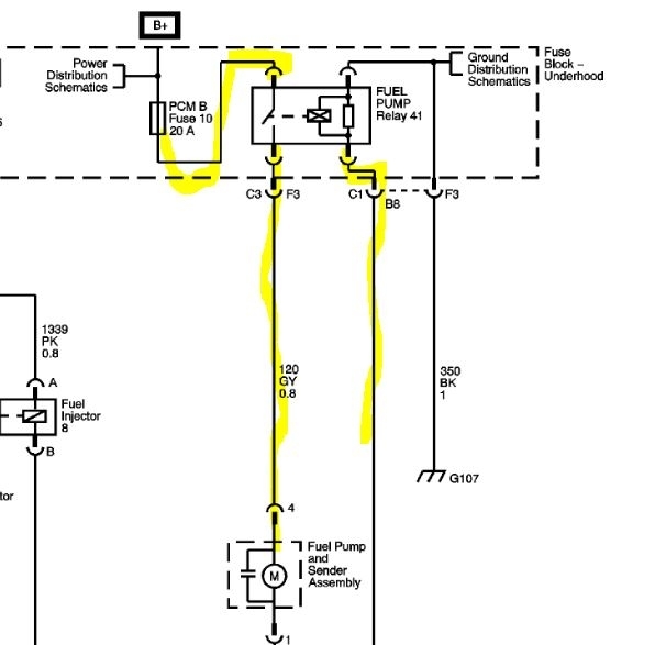

Started having problems with truck not starting. thought was battery, replaced battery an alternator. Would work fine for a day or so then it would start over just turning over like getting no fuel. Pull fuel pump relay an put back in starts right up. Replaced relay still having same problem. Have any suggestions what we should try next ?
Jun 2, 2019 at 1:28 AM
Good morning,
When you turn the key to the on position without cranking the engine over can you hear the fuel pump run in the tank for 5 seconds?
Can you check the fuel pressure when it will not start?
Check out the diagrams (Below). Please let us know what you find. We are interested to see what it is.
Jun 2, 2019 at 2:07 AM
DAVIDBLANK
  • 8 POSTS
Yes, the engine cranks over but no start. If you pull the fuel pump relay then put it back in it starts right up. I replaced relay and is still occurring.
Jun 2, 2019 at 4:02 AM

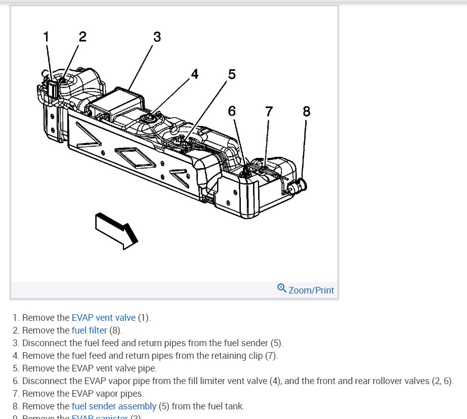

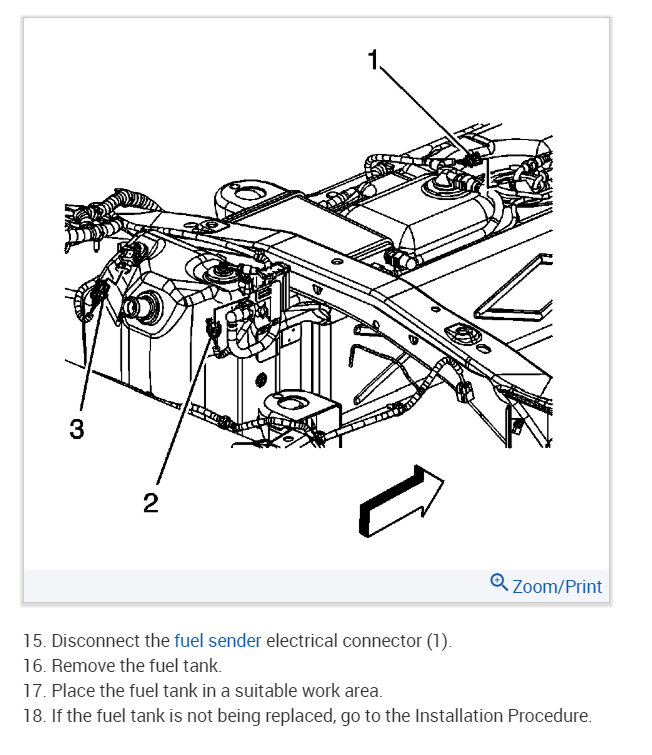

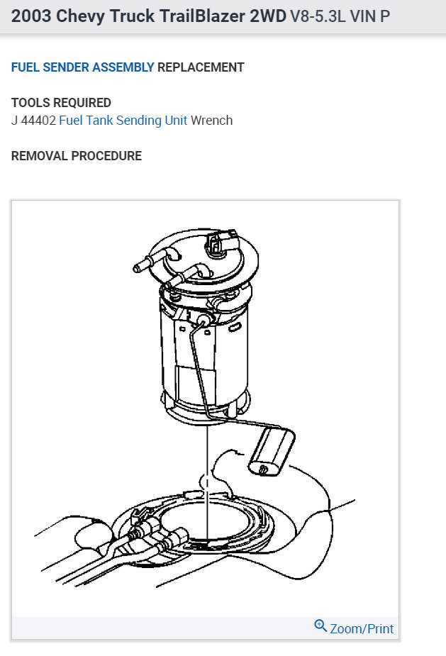

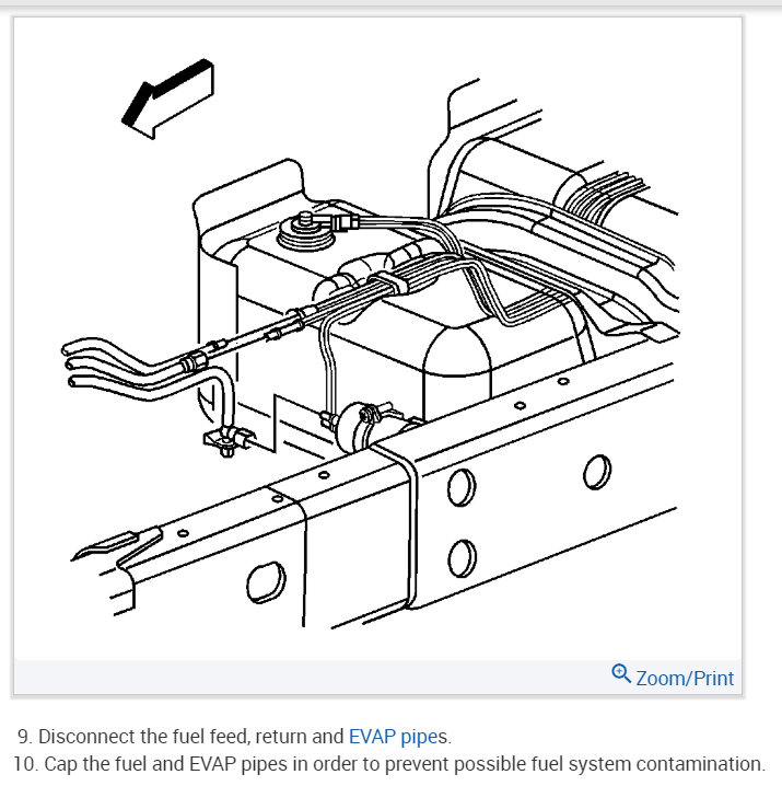

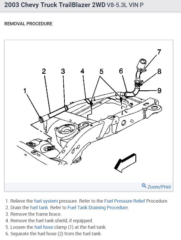

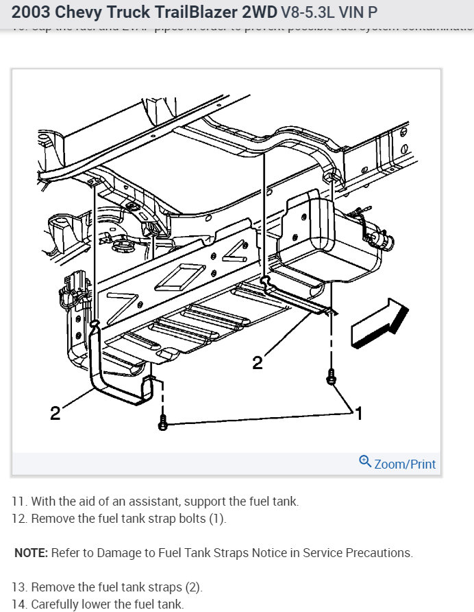

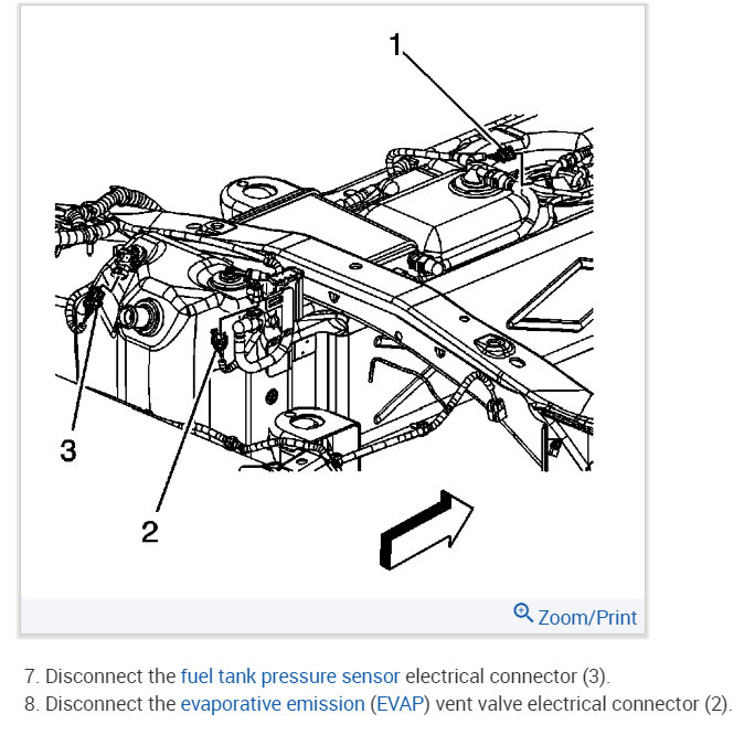

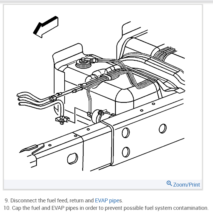

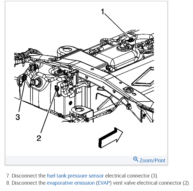

Okay, this sounds like a classic fuel pump problem, here is a guide to help walk you through the repair with diagrams below to show you how on your car.
https://www.2carpros.com/articles/how-to-replace-an-electric-fuel-pump
Jun 2, 2019 at 4:37 AM
DAVIDBLANK
  • 8 POSTS
Sorry it took a while to get back to you but you were right the fuel pump. fixed it all good!

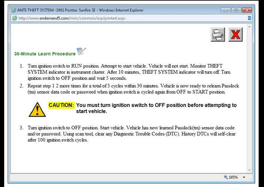

try a security system reset first. See picture.

i have not tried to reset the security system yet, but i will. what cause the system to get off set? when i turn the key on the security light is on solid but it goes out in about three to five seconds about the same time the fuel pump stop running.
Oct 28, 2020 at 4:08 AM (Merged)
HMAC300
  • 48,601 POSTS
they just do that they are electronic. it can be something else but try that first. then scan for codes.

i did a security system reset that didn't help still no spark at the coils not getting no signal from the PCM to the coils

Please run down this guide and report back. it should be 50-57 psi at fuel rail and not drop more than 5 psi after ten minutes it may be a partially blocked line. if you spray choke cleaner into throttle body and it starts fine if not try resetting security system.

Please see if it's flashing or on solid that's means the security system is active keeping it from starting

Try relearning the pass lock sensor like hmac300 suggested in a previous post look back on this question there are instructions.
Oct 28, 2020 at 4:12 AM (Merged)
SATURNTECH9
  • 30,869 POSTS
Those look like throttle body codes like throttle position sensor etc.As far as the security light those would have codes in the body control module which a basic diyer code reader can't read.Those codes would start with a B try relearning the pass lock sensor.
JOERUSS1953
  • 13 POSTS
i tried to relearning the pass lock sensor when i turn switch to run position, the security light turn off in about 3 to 5 seconds.

I relearning the pass lock sensor the engine still want start i check for spark i don't see no spark when cranking what could be the cause for no spark?
