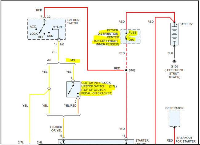

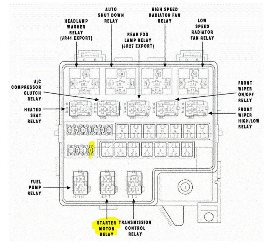

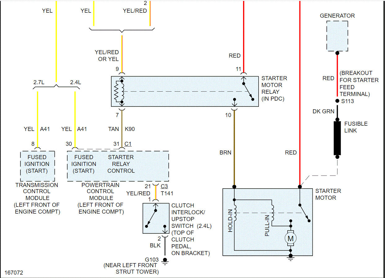

I attached the wiring schematics below. First, check fuse 8 in the under-hood fuse box. In addition to checking the fuse, make sure there is power to and from it. Here is a link you may find helpful:
If that checks good, go to the starter relay in the same under-hood fuse box and switch it with a different relay having the same part number. If there isn't one, here is a link that shows how to test a relay:
If that checks good, then go to the clutch switch. When the key is in the start position, the yellow wire should have power. If it does, depress the clutch and check for power out at the yellow wire with a red tracer.
See pics below. Note: Pics 1 and 2 are the schematic. I had to cut the pic in half to make them readable. I did overlap them so you can follow from one to the next. Pic 3 shows the fuse and relay locations in the PDC under-hood.
