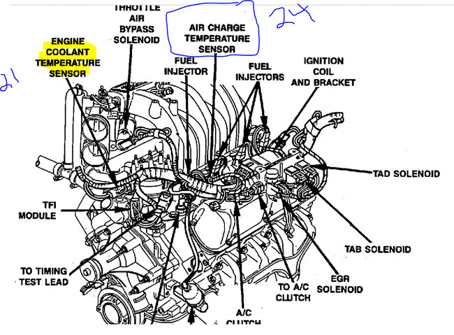

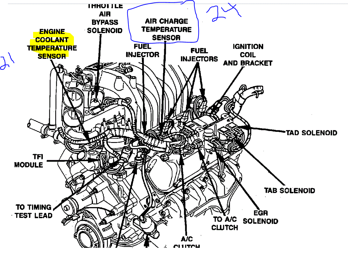

Thank you for the reply. I got codes 21 and 24.
Dec 22, 2020 at 6:29 AM
  • 110,248 POSTS
The codes are for two different components. Code 21 is the engine coolant temp sensor and 24 is the air charge temperature. See pic 1 for locations.
Check to make sure they are connected. If they are, crank the engine a couple of times and then pull a spark plug to see if it is wet with fuel.
If the ECT is indicating an extreme temp (for example -40°F) the computer will dump fuel to make it run which won't work if it isn't that cold.
Let me know what you find.

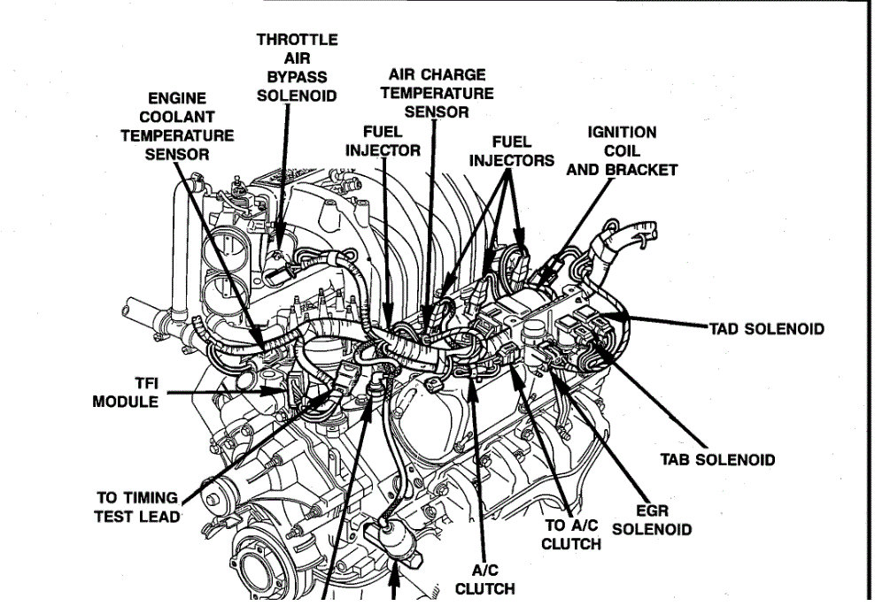

Okay, either it is flooded or there is no spark. I'm going to guess it is no spark. Here is a link that shows how to check for spark:
Do that and let me know the results. I have a feeling the TFI module is bad or the coil itself is bad. I attached a pic below of the TFI location. It's on the distributor.
