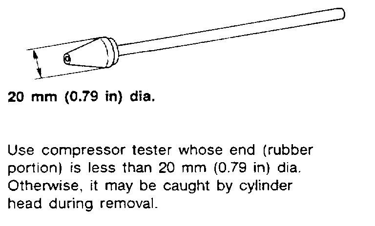

Here are directions specific to your vehicle for testing compression. The attached pictures correlate with these directions and the manufacturer's specs are included.
COMPONENT TESTS AND GENERAL DIAGNOSTICS
Picture 1
1. Warm up the engine, turn ignition switch "OFF" and release fuel pressure.
2. Remove all spark plugs and disconnect distributor coil connector.
3. Attach a compression tester to No. 1 cylinder.
4. Depress accelerator pedal fully to keep the throttle valve wide open.
5. Crank the engine and record the highest gauge indication.
NOTE: Always use a fully-charged battery to obtain the specified engine speed of 350 RPM.
6. Repeat the measurement on each cylinder.

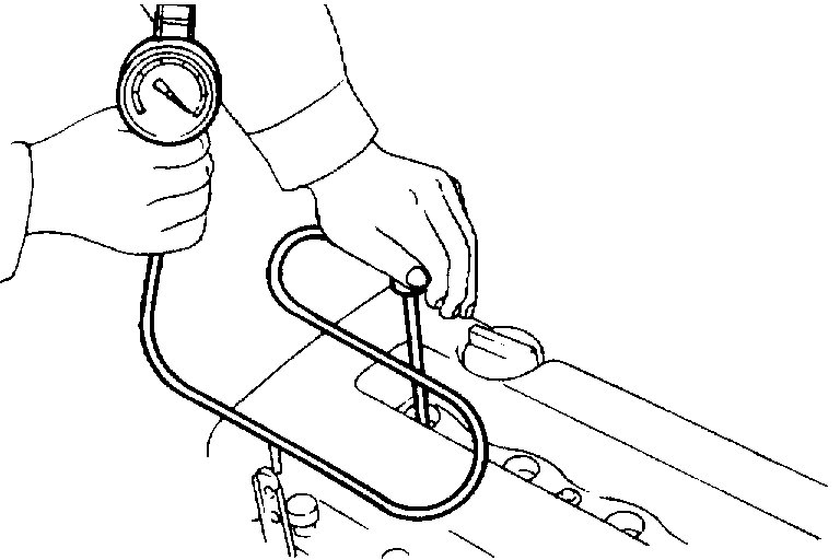

Picture 2
7. The standard compression pressure should be 1373 kPa (199 psi.) The minimum allowable pressure is 1177 kPa (171 psi). The difference limit between cylinders is 98 kPa (14 psi).
8. If the compression in one or more cylinders is low, pour a small amount of engine oil into cylinders through spark plug holes and retest the compression.
NOTE:
- If adding oil helps compression, piston rings may be worn or damaged. If so, replace piston rings after checking piston.
- If pressure stays low, a valve may be sticking or seating improperly. Inspect and repair valve and valve seat. If the valve or valve seat is damaged excessively, replace as necessary. If compression stays low in two cylinders that are next to each other the cylinder head gasket may be leaking, or both cylinders may have valve component damage. Inspect and repair as necessary.
