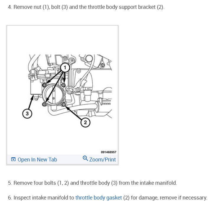

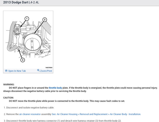

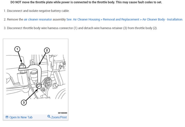

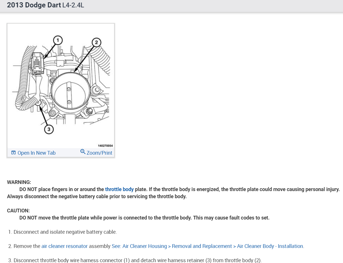

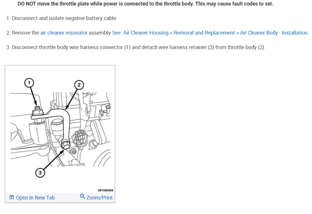

Can someone help me my car will not start. when key is in start position it just keeps cranking while the radio and everything electrical works, but once i press the gas it starts up if i does not just keeps cranking.
The video is not my car but it does the same exact thing.
Mar 11, 2019 at 1:55 AM
  • 55,688 POSTS
I don't see the video? This problem is typical when the throttle bore needs to be serviced. Leave the wiring connector on the throttle body when doing the service. here is a guide to help walk you through the steps and diagrams below to show you no your car:
