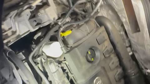

I changed the oil and the spark plugs and now it starts and sounds like this.

Is the noise coming from the top of the engine? If you remove the oil fill cap, is it louder? It sounds like there could be a camshaft phaser issue. How dirty was the oil? You had me concerned when you indicated it was chunky. LOL Was it that bad?

Yes, I believe it is coming from the top of the engine. Once I remove the cap it is louder. The oil was very dark lol, once I changed the oil and the spark plugs it actually turned on, now it's just struggling to stay on.
